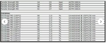

Planning on using a Spring Scale to set vertical tension, just need to know value....
From specsheet, the Dupont Mylar C 6 micron should shrink 2% in Machine Direction, and 1.2% in Traverse Direction with 300F heat applied for 30 minutes...but we only want vertical tension, so heat shrink not an option ("barreling" of mylar over spars - yup did it)
Sooooo....Mechanically...
Elongation = F*L/A*E
F= force (what we are looking for)
L= Length
A= Cross sectional area mylar
E= Modulus of elasticity (using Mylar 710kpsi, cannot find Mylar C value)
So plugging numbers, tensioning 36 pounds should get 1% elongation.
I still think this is too high.......anyone know if this is correct, or able to check my calc?

I don't have an answer for you but I have some questions if you don't mind my asking, and some possibly helpful comments.
Questions:
1. I think 1% elongation sounds reasonable but I'm curious: How did you decide that?
2. I prefer 6-micron Mylar but I read somewhere that Martin Logan uses 12-micron Mylar on all their panels. Is that true?
(if so; then 1% elongation would produce much higher tension in 12-micron film, compared to 6-micron film-- which points back to the question of how you settled on 1% elongation. leads me back to the 1% elongation decision came from)
3. If you want 1% elongation, why not just measure it directly, rather than calculating equivalent pulling force?
(measuring it directly by adding some reference marks on the film with a fine-tipped felt pen, and then stretching the film until the span between the marks increase by 1%)

Hello Charlie!
I remember reading the 1% measurement was the ML norm...don't remember where I saw that tho...
I also read that ML uses 12 micron mylar too...I have quite a bit of 6 micron mylar...
The 1% elongation measurement (and not tension measurement) would be nice, but I would need another person in my rig / method. But that would be best way to measure.

On the Theater panel rebuild what I didn't do but wish I had was to measure the elongation--- I only stretched the film until it's deflection at center span measured the same as that of the original diaphragm, so I'm now curious whether it's elongation would have been close to 1%.
In any case, I don't think you can go wrong with 1% elongation but I wouldn't go with any less -- better too tight than loose!
