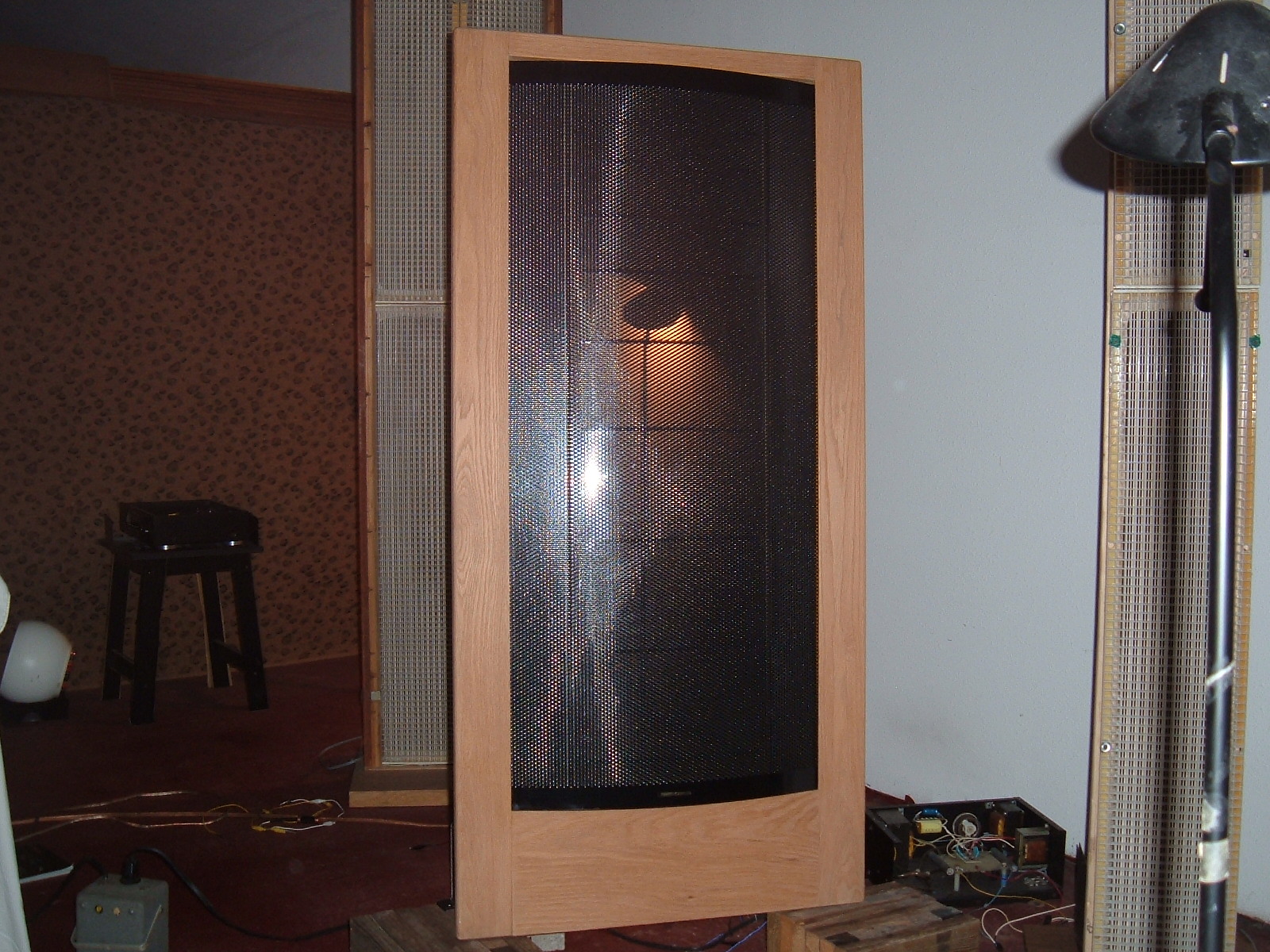

Hey all, Considering buying some Sodium Lauryl Sulfate to spray onto a CLS Panel Diaphragm... see here...
Sodium Lauryl Sulfate-SRF-SLS-01
Looking to tape off the spars and get on the panels as best I can thru stators. Then wiping off residual on stators and leaving flat for a day or two until the coating dries...
Bad idea?
Bad idea?

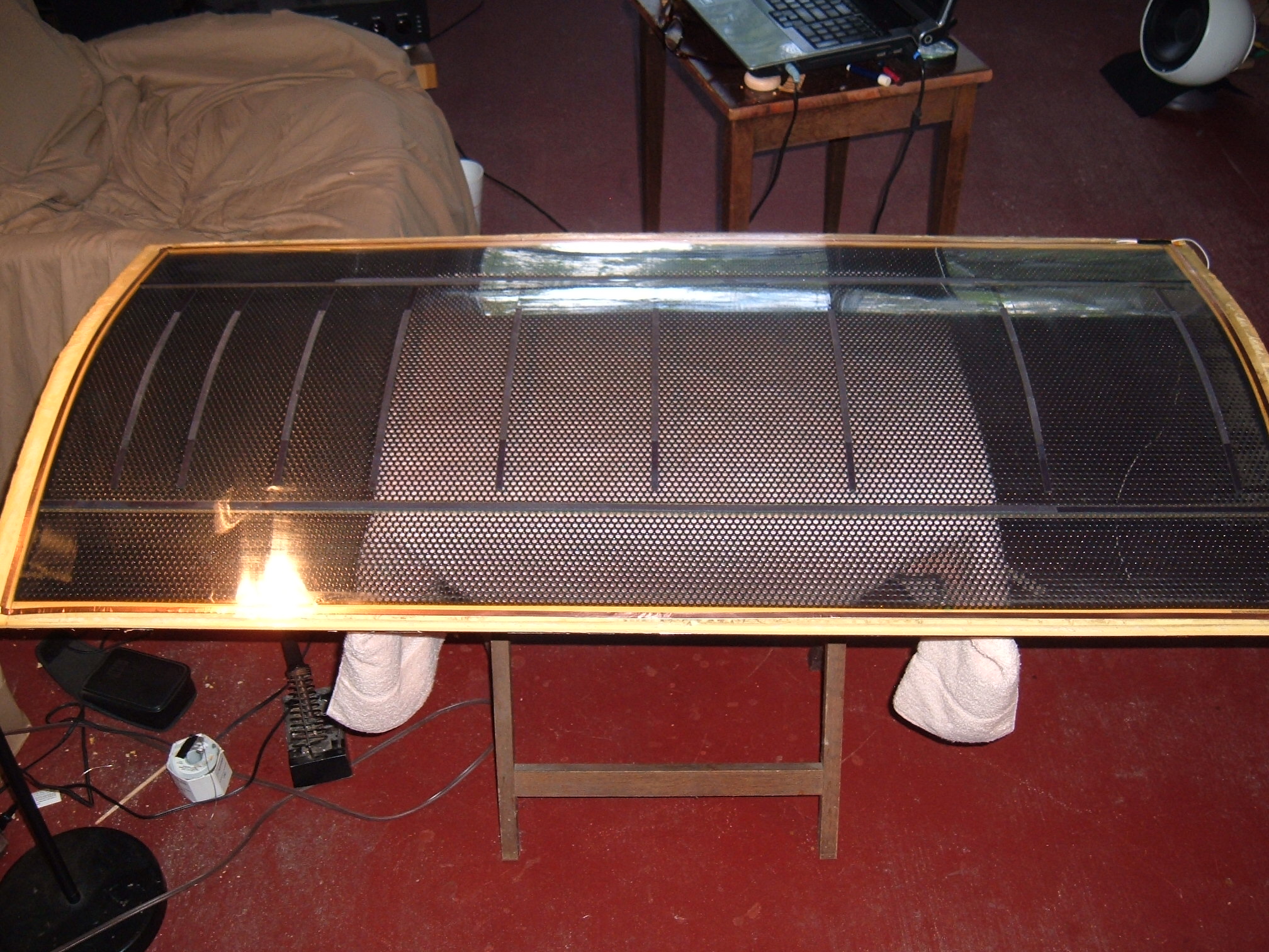

May I ask, why not split the panels John65B ? Older ML panels should be much easier to split. Unlike my Odyssey which was double taped all round that really required lots of patience & time to split the stators but I still manage to do so & recoated the Mylar.
Another issue, let's presume you have success by spraying through the stators, what makes you think that the bias strip is still in good condition ?????
I have split three sets of CLS panels and only once not damaged the mylar.
I have a set of panels that look like new - and still secured all the way around, just that the output somewhat low.
As far as the bias ring, if I can get some of the spray liquid into the panel edge creases, chances are I could get some of the solution onto the bias ring...
I understand not ideal, but it could work...

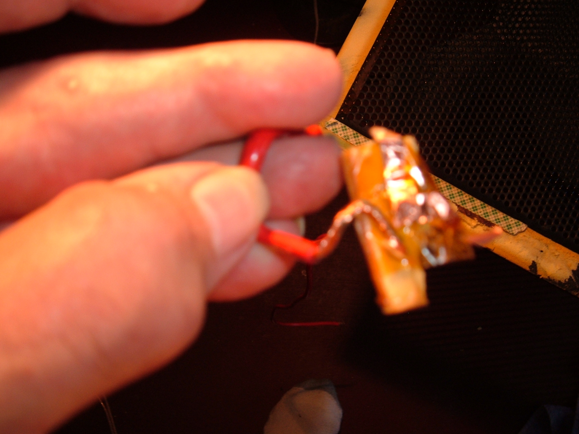

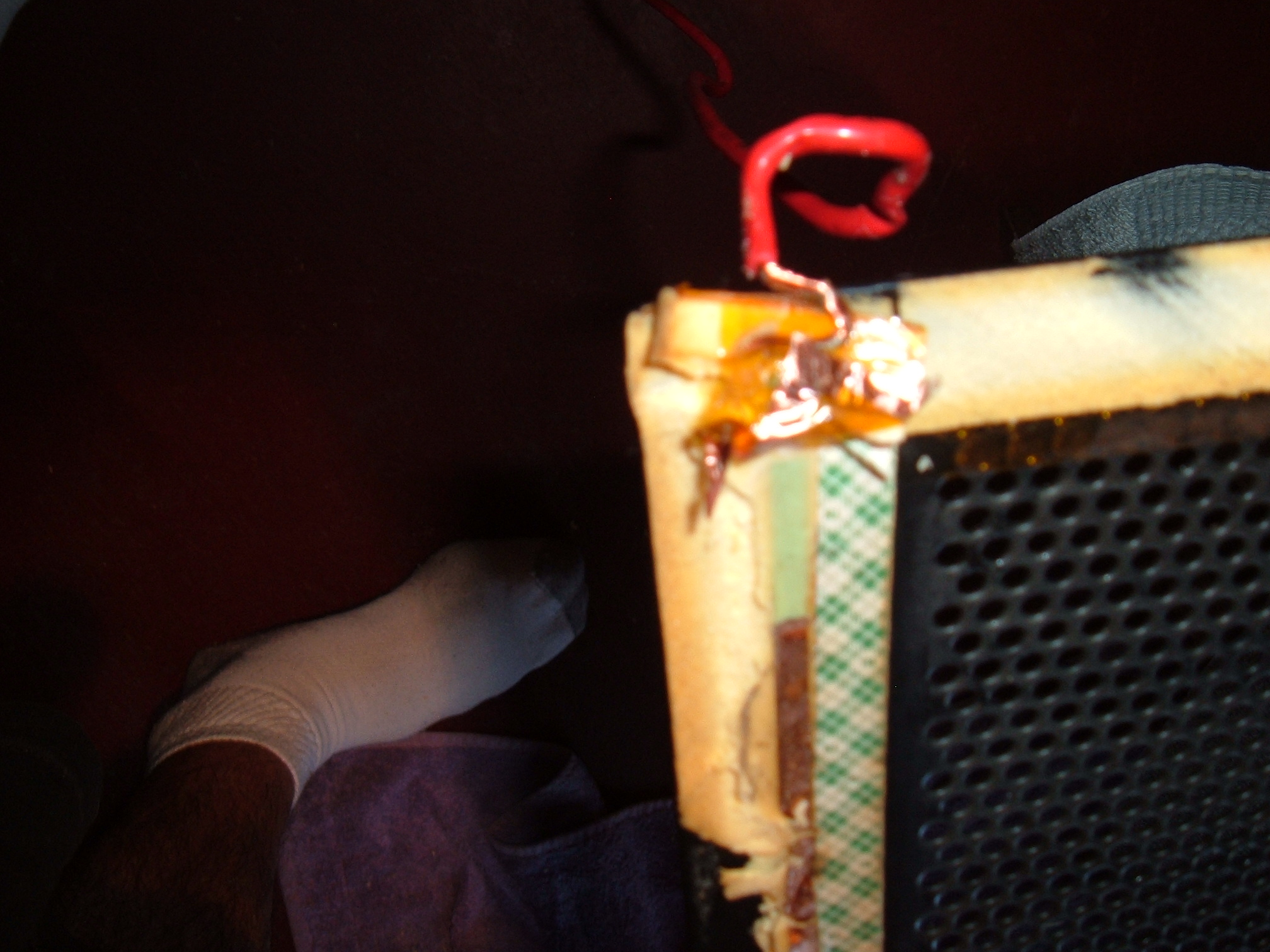

spraying trough the stators is a no go im afraid. first of you will also make the stators conductive. witch makes it possible to jump from foil to coating on the laquer of the stators then trough the paint to the steel. and it will also result in an uneven coating on the foil. doubt if it even becomes one connecting layer 🙁
I have work with these old ML panels ....ML never solder the red bias feed wires on the copper strip...i well never get this.... if he can get lucky an get some coating at the strip the panels may come back....but hole panels well see, john65b is a good man....hes had his hands on a lot of ESLs...i got lucky these ML CLS panles pop open.....see the pic the red wire just feel out but there working today an there sounding as good as any speaker i have owned....runing them with Acoustat MK121 interfaces, sounds better than an ML interfaces.....
