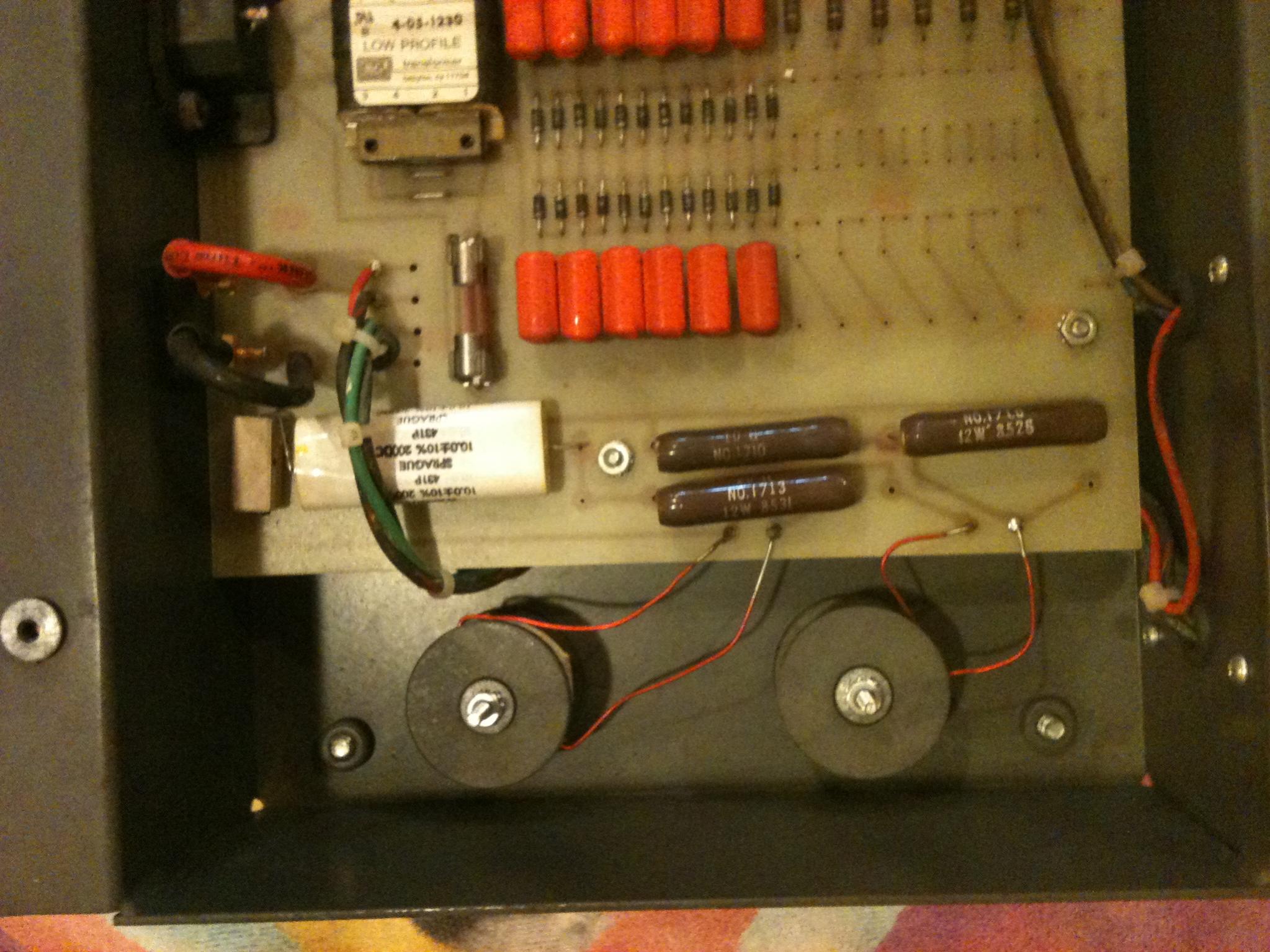

Hello all, this is my first foray into the ESL side of DiYAudio. I have been on DIYAudio for a number of years. Built all sorts of tubed and SS amps (Icepower, Tripath, Hypex, Krell KSA-50 clone, Aleph 5 Clone, etc) and preamps (Aikido, Jfet BOZ, etc), and now want to take a dive into an ESL.
I have acquired a working pair of CLS panels. I should have no problem with the frames (got some good ideas already), but am in need of a little help on the bias / power supply.
First question is what is the voltage on an original CLS? 3kv? Are the power supply requirements any different from what I have seen here if the CLS is a full range design?
I have a few CLS schematics, but they are a little vague on the actual component values. I also noticed there is no Bias control or brilliance pot on the CLS that my panels came from. They also do not have a toroidal output transformer either.
BIAS CIRCUIT

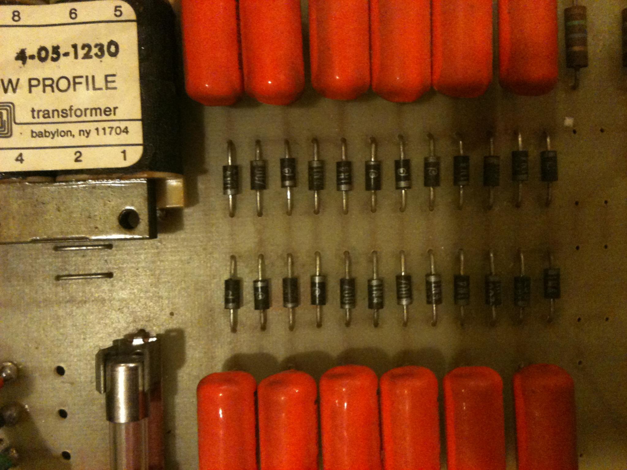

I have two designs I have researched - one is a simple basic power transformer to a voltage multiplier circuit with diodes to get to 2 - 3kv (or higher), or just getting a 20VDC supply (plan on a 20vdc 3.2 amp laptop power supply) and running it to a DC to HVDC converter to do the same. Is one design preferred over the other? I know the original PS for the CLS had the diode voltage multiplier (12 stages if I remember correctly)...I will post some pics later of the one I saw....
Thanks in advance!!
EDIT: Also, thinking of leaving the CLS to do 200HZ and above, and leaving the remainder for a Tympani bass panels...
Joined 2005
I am guessing bias around 4.7kv??
And there is a single 10uf cap, two coil inductors, and three 10R 12w resistors in there - this is a crossover? I thought the CLS was full range?
That Opamp circuit - is it a sensing circuit to tun on / off the Bias voltage to keep panel from attracting dust? Don't really need the sensing circuit, as I will just turn it off when not in use...

From info i got from ML thay set the last CLS at 3700 bias....I run my CLSs bias higher but i have redone... the panels bias feeds so i get all the CLS panels Can put out....About 3-4db more than stock like you have....The Bias feed is the week link of all the ML panels....It only runup the right side only....thay lov to sale those panels...thay never had Bias control pot ....that i like a lot for any fulrang ESL ...ML Never used a toroidal output transformer either..... but thay dose not mean you cant.....AS for the crossover i just run some res..1-2ohms on the pos input ... an use subs.....An have used Acoustat panels for just the low end.....sound ok ....but to big for me........Goodluck

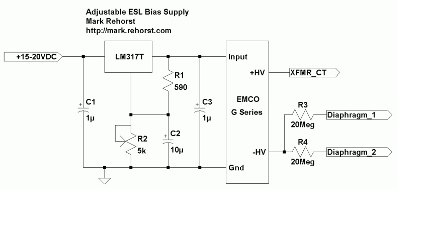

OK, I am thinking of going the "safe" route per Mark Rehorst and use a standard laptop power supply and the Emco DC to HVDC converter per attached for the Bias Supply. There will be two - one for each panel (don't want to string HV wires across my speakers)
Also thinking of an Edcore GXPP15-4-8K output transformer.
EDCOR Electronics Corporation. GXPP15-4-8K
Would this output transformer work out better than the Antek 115-6V toroidal that has been discussed?

That HV supply will work great. I'm using a similar EMCO based supply for my speakers. The LM317t runs a little warm for the Emco's I used and if I did it all over I would have used the TO3 version. Looks like this:
I am thinking of going the "safe" .....i would not do anything diff....who runing wires all over??......an the fperra set up look great....Go with that then you no if the panels work....or sound good.....It only your $$$$...goodluck

Great work....Does anyone have any input on the output transformer? The Edcor vs the Antek Toroidal? I was going to purchase everything tomorrow...
Going with the Emco G50 (5000V) for a little more bias headroom, as I can always turn the bias down from there...
