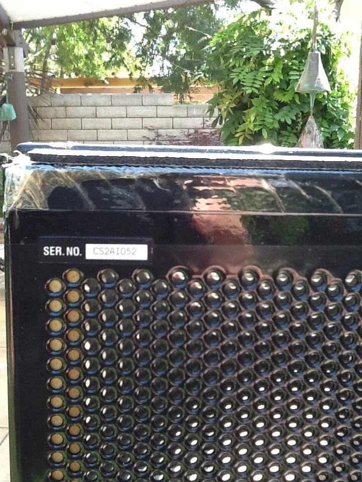

Yes, double sided tape all around, but there was additional tape on top bottom too to hold the vertical tension...see pic
Yes, that cello tape holds the Mylar to the rear stator. I'm guessing they did that because of the longitudinal tension of the Mylar. I did the same, in fact I did it all around just as an added precaution
