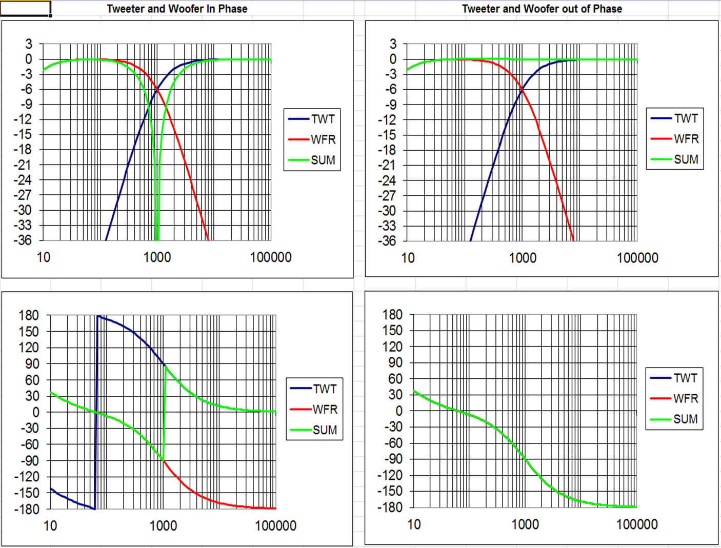

See the attached plot set for a visual of the description CharlieM gave.
Basically whenever a woofers reponse is rolled off with a low-pass filter there is an accompanying phase shift.
Similarly, phase shift also is involved when rolling off the ESL response with a high-pass filter.
Sure it would be nice if both woofer and ESL were wired with the same absolute phase. But, it is much more important that they have the same phase thru the crossover region where they both are contributing significantly to the sound output. If they aren't in phase there, they cancel each other's output and you get a null in the response as shown in the left hand side of the plot set.
The plot set is for a 2nd order filter(12dB/oct slopes), and as you can see the summation thru the crossover region is best when the woofer and tweeter are wired out of phase. I'm not sure what type of crossover slope ML used, but if they wired the woofer out of phase with the ESL it was probably to achieve the best acoustic summation thru the crossover region.
As CharlieM mentioned, no harm in experimenting with the woofer phase.
The specified crossover frequency is 450Hz, so you you might start your listening experiment there.
