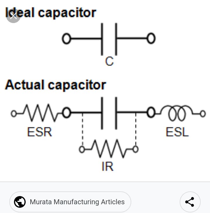

Not a "parts" problem by any means, not solvable by changing parts, even less if guided by Brand , the most irrelevant "parameter", I never ever saw any circuit design include Brand in design or involved Math.
I do see: capacitance - voltage - dielectric - polarity (if applicable) - MTBF - losses - self inductance - resonance, etc. but never ever "Brand".
Of course, those getting paid to push a particular one will insist it's most important.
Hey, Murata does not even mention Brand in their Real World capacitor analysis ... somebody should correct them, what do they know about capacitors anyway?
