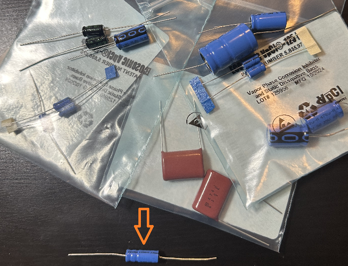

I am pretty sure I found a solution to the reverb drive issue on my JCM 900 4100.
Short Story
- The TL071 in the reverb drive circuit was malfunctioning and after replacing it I have full reverb flying through the JCM 900.
But as this cases points out, it can be other things too.
Long Story
- I acquired a new TL071 and made a couple simple voltage follower and non-inverting opamp circuits with it and a couple 9V batteries on a IC testing breadboard.
- I pulled the TL071 from the PCB and stuck it on the same breadboard and it did not work. It did not respond to the gain resistors and although it did show a waveform it was 1/10 the input.
- I pulled the three caps surrounding the reverb drive circuit and all of them when tested out of circuit within range (the electrolytic at the very bare minimum range as expected for a 30+ year old cap).
- I replaced the TL071 and the MC1458 even though the original one was working with new chips I snagged from digikey.After resoldering everything into place, I turned on the amp. Nothing smoked. I then took a sine wave reading off the black RCA which feeds the reverb drive and got a large clean sine wave.
I then hooked things back up and played a real guitar through the amp and woot woot gots some reverb back.
The test was under 5 mins so I am going to keep burning things in and see how things go, but sounds like I am good to go now.
