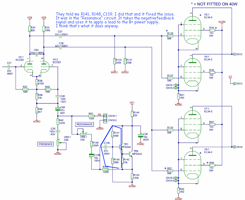

I have one of these amps to fix for a customer. The complaint was it sounded like water gurgling thru the peaker. It is basically a low freq rumble, like a wavy lp. I determined it is past the preamp section. Even with all knobs on zero.

Not yet. I don’t have a schematic so it’s slow going.
I took the board out and gonna check for poor solder.
I verified removing thephase splitter tube makes it stop.
I will lift the coupling caps from the PI tube to see what happens.

I sent an email about this to Marshall. They responded, which surprised me! They told me to replace the 1M resistors in the PI circuit.

No they did not. They told me R141, R148, C139. I did that and it fixed the issue. It was in the “Resonance” circuit. It takes the negativefeedback signal and uses it to apply a load to the B+ power supply. I think that’s what it does anyway.
I found the schematic by searching for its sister amp, the DSL100HR. Same circuit and pcb, just has 4 power tubes.
It is a common issues with some of those amps.
I see two solutions, one that I would not apply (substitute the gyrator with a wah inductor) and one that IME is an improvement (use the old resonance circuit with the pot in series with the feedback and a cap across it).

I've had the amp looked at by another tech who also builds valve amps. He looked it over, changed the output valves and it was fine for a couple of weeks, but the problem is back again. I was going to get some new preamp valves, but Ives noticed on the spec for this amp that it require 4 ECC83 and V4 has to be a balanced valve. What is balanced, why does this matter, and will it cause a problem if I just fit 4 standard valves instead of 3 standard ECC83 valves, without the one at V4 being balanced?
