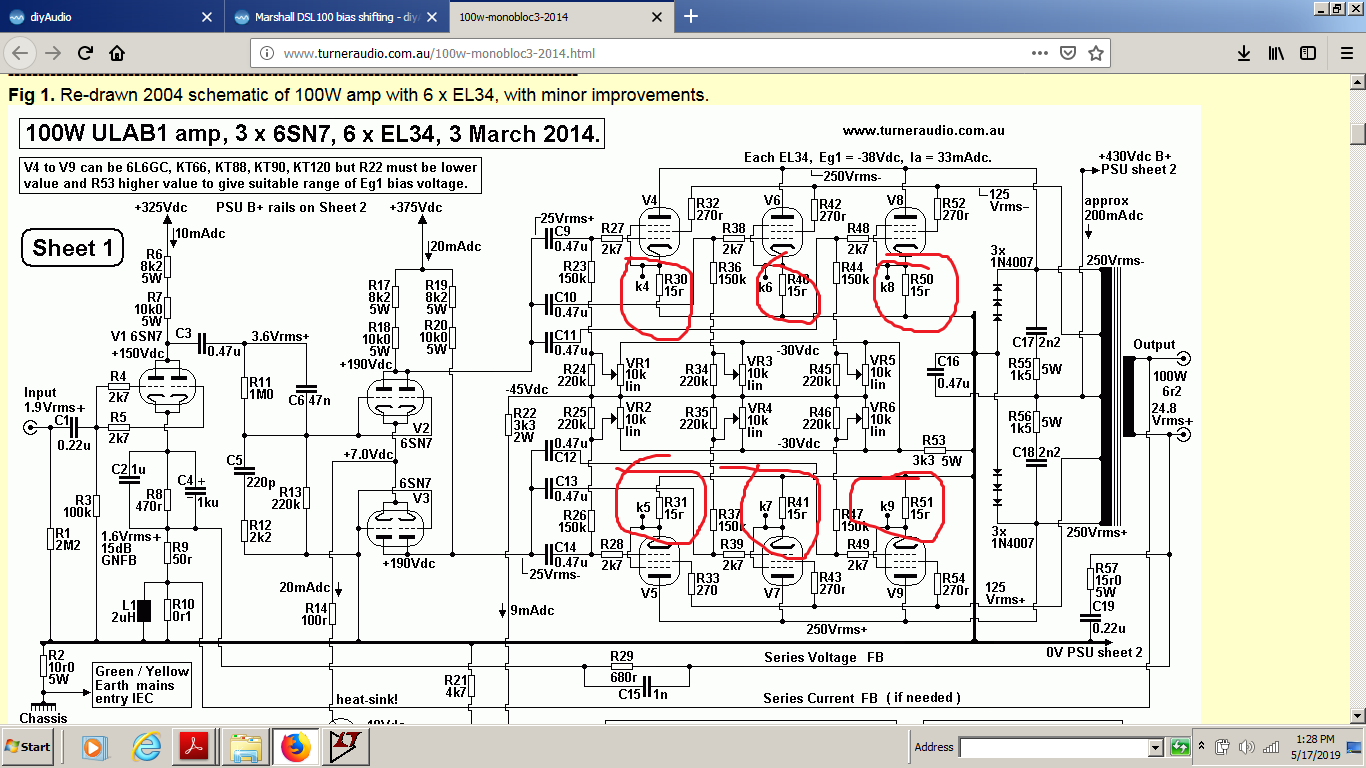

If OK replace individual EL34s, EL34s are notorious for grid cathode leaks when over driven in class AB2 for maximum 'dirty' power.
That's expensive.I heard of an identical problem in one of my friend's tsl100.One valve died first, it was replaced and the output transformer was fried later. I would suggest to introduce a cathode resistor to ground of 100...220 ohms paralleled with 330uf in each valve's cathode .With fixed bias you need at least 10...22 ohms in each cathode.
Not absolutely sure about that but if you remove two push pull valves of all four you might see that the bias gets a bit more stabilized because the idle current inrush of the impaired valves can cause the change in b+ power supply which in turn will cause additional bias change.I think that Marshall never looked to match the valves in the final stage.You don't have this problem in any other professional amp that's at least twice the price of that Marshall.

To add cathode components is not good practice. R6 and R9 are already there to monitor the current drawn.
Well...you can change the cheap valves with other cheap valves then you might need to change the fried output transformer which is another 100 quids.I know that because i got for free the fried Dagnall! I can tell you that that is exactly what happened to a friend of mine with a TSL100...I'd double c34/c35 to have a more sustained anode voltage.I suspect it's about unmatched valves in the final stage.That is why i suspect that using 20...220 ohms in the valves cathode might cure this problem.
If there's a pot doing the bias that should be replaced too with a good one.
