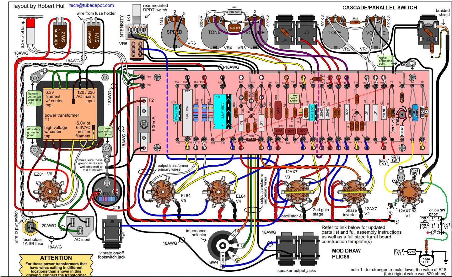

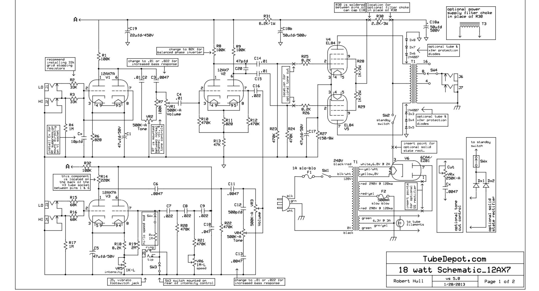

Thank you I’ll try it … but also can you help me with something else ? I have an idea for something called hot mod v2 by legendary tones it works with 2 12ax7 and increase the gain … this adapter going only on v2 position of jcm800 and jmp .. I think is SOLDANO HOT mod but stoping because that it work with one 6c10 tube and this tube discontinued… I check this tube and it’s triple triode . Μy idea is if I split the triple triode to 2(triodes) and 1( triode ) with the same schematic , will work ? Ex. I put one 12ax7 and I use the 2 triodes and next I put another 12ax7 and use the 1 triode . And those 2 valves going to Noval adapter… will work ?
Yes I know the 6c10 is expensive valve and rarely .. so my theory is to divide 6c10 into three parts. that is, to divide the three triodes into 2 triodes and 1 triodes. I will use 2 valves 12ax7 where on the one hand I will use the 2 triodes and on the other the 1 …looked at the drawings, one is schematic and the other is layout ..I just do not know if a being can work what I want to do. .56E65012-8395-427A-90EB-3B50E63D873A.jpg
