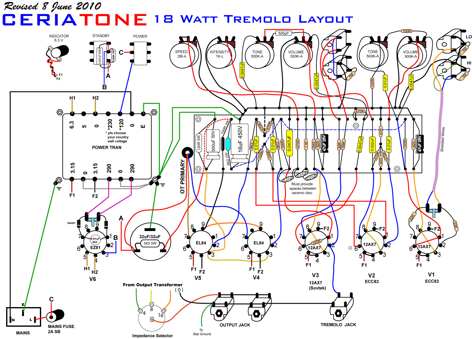

I am building this circuit .would I have a problem or need to change anything when using a transformer with a 301v 0 301secondary ?

You can put a 1N5357B 20V 5W zener diode between your 0 tap and ground on the pt to get you there on the money. The tubes can handle the extra plate voltage, though. Maybe try both and see which you like better.
Or put a resistor between A and B which would drop enough voltage and give you a little better supply filtering.
Or even a 100 ohm 5 watt wirewound resistor at each leg of the HT transformer secondary .One in series with each leg before the rectifier. There are a few ways to skin a cat. Just be sure any resistors used in this area are 5 watt or better.

Hi I am having difficulty finding a toggle switch for the standby of the Ht for my Marshall guitar amp project,
It needs to switch 350v dc at about 100ma

If you wire it correctly, before the rectifier, centre tap of transformer to ground through switch or if a single winding, in series with one of the AC feeds to the bridge, that will avoid the need for a DC type switch. A standard 250v AC switch will then be fine.
Some Marshall amps are wired BEFORE the main smoothing capacitor, that reduces the DC across the contacts.

I am building a Marshall clone using 300 0 300v
Can I test it without a load and what sort of voltages dc should I expect to see

Yes, if he connects a capacitor between the tube's cathode and ground. I wasn't sure if his »with no load« excluded capacitive loading also 🙄.

Diodes in the anode of EZ81 have no sense. You would remove them.

Your transformer has 290 - 0 - 290. The 0 on that winding at present goes to the chassis ground. Cut that wire and place your switch between the 0 and ground. There is no point in adding the cap and resistor on the switch, it will do nothing except be prone to failing.
this is the circuit I am making .
It would be handy to know what voltage to expect with capacitance
