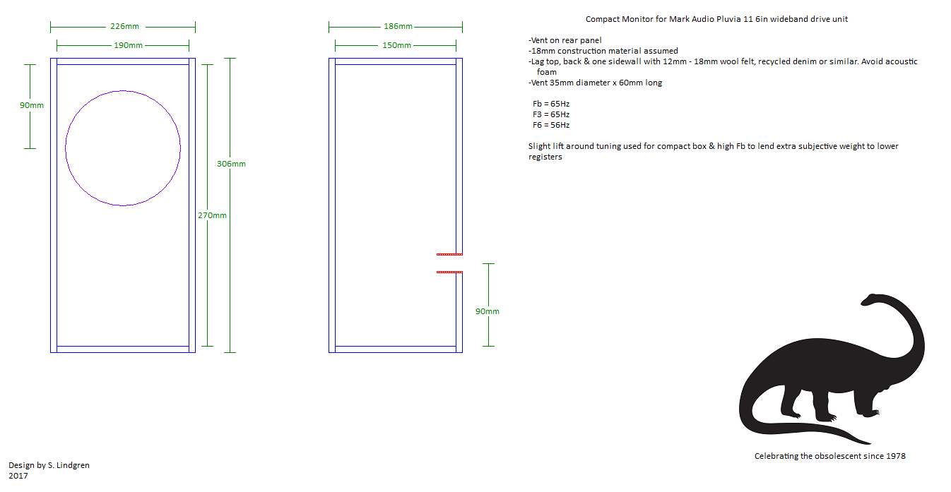

Back on topic, I've been sorting through one of my old HDDs prior to it being recyled & discovered a handful of designs I haven't posted before for half a dozen different drivers. Three were for the Pluvia 11, so I'll put them here. Nothing novel about two, just straightforward vented boxes, but may be of interest / use. The third is a bit different though. 😉
First up, compact standmount / desktop monitor (using the term purely to describe a modestly sized box). Looking back at the box alignment & brief notes I'd stuck onto the line drawing, it was done as a deliberately small box, with a very lightly elevated LF alignment to help compensate for the higher Fb & lend a little extra subjective weight to the bottom end. Vent tuning is reasonably broad so shouldn't have the on-off effect of a very narrowly tuned alignment. Resaved as a png file from the original bitmap to keep size down. Please excuse the simple (rubbish) drawing. CAD is not my thing. It should be sufficient though as these are very simple boxes. I assumed a non-flared vent; for anyone who wants to change the duct size, Dave's pdf is also attached.

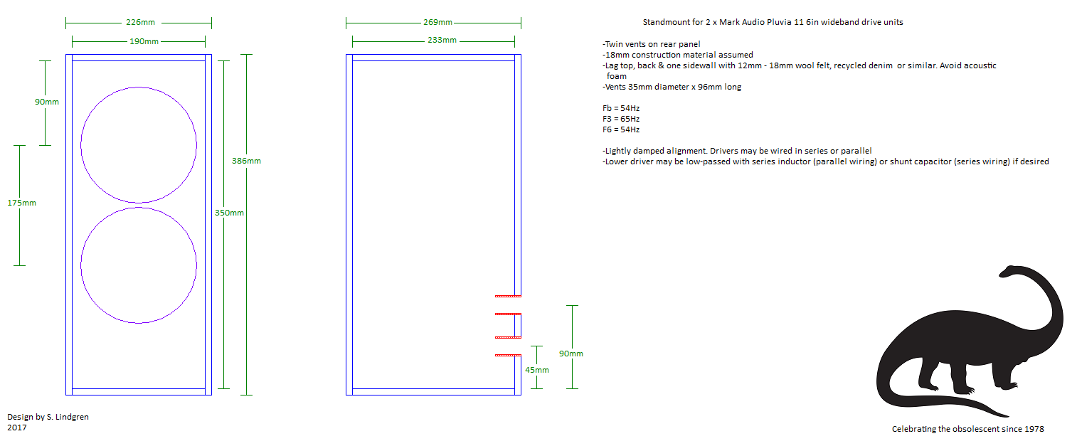

And the second. Larger standmount, this one with two drivers. I suspect I had a mixture of TAD and Omega in mind with this one. Given the impedances, I'd probably series wire & if you want to low-pass the lower driver, simplest way would be to shunt with a 56uF cap (& adjust from there as desired).
Same remarks as above apply re the vent: non-flared was assumed, if you want to adjust, feel free, Dave's pdf with scaling formulas attached here too. I wouldn't reduce the size though if you want to avoid potential excess velocities.

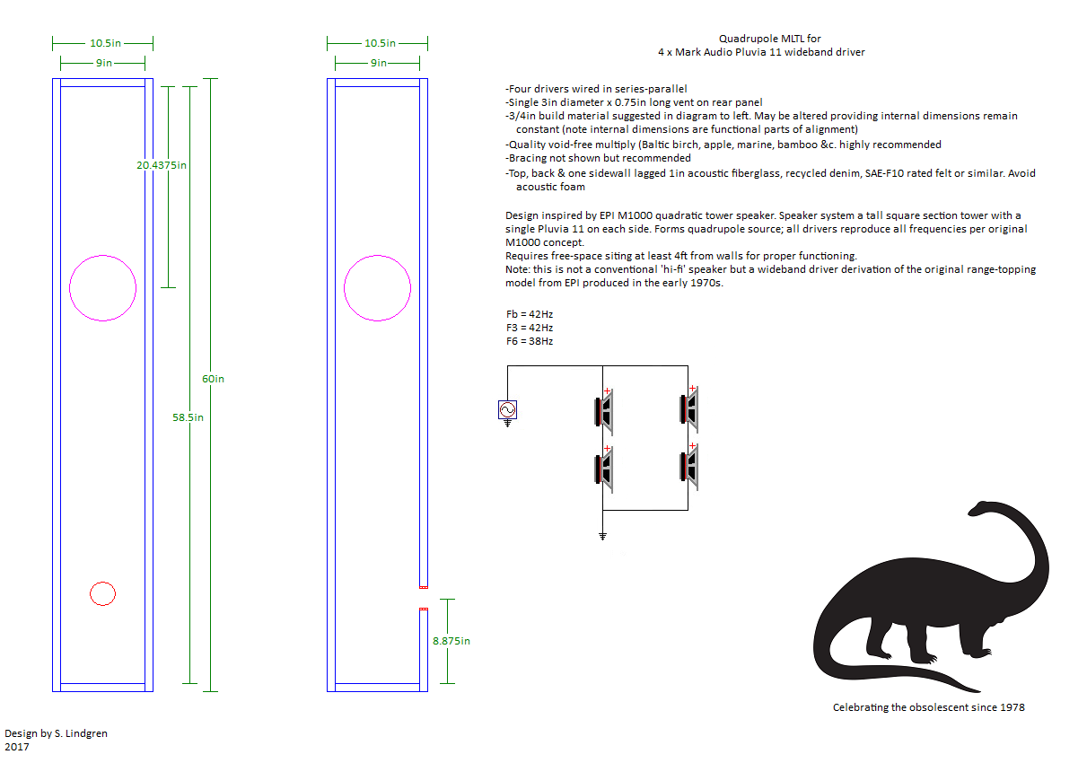

Third one.
Yes, this is a bit 'different'. Don't bother telling me all the things wrong with it, because I'm very well aware of them, and did it anyway. It's a little (well, 5ft) reference to Winslow Burhoe & EPI as it was in the early 1970s, and their then range-topper, the M1000 quadratic tower. Yes, it's a square section MLTL with a driver on each vertical face, all wired in the same electrical polarity (you won't get much cabinet output if you wire drivers sharing the same internal volume out of polarity 😉 ). Eccentric, yes. But the EPI M1000 did & still does have its fans, so it clearly does some things very right for some people. Is it hi-fi in the usual sense? No. But that misses the point as it doesn't prioritise the same things.
Third one.
