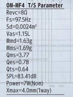

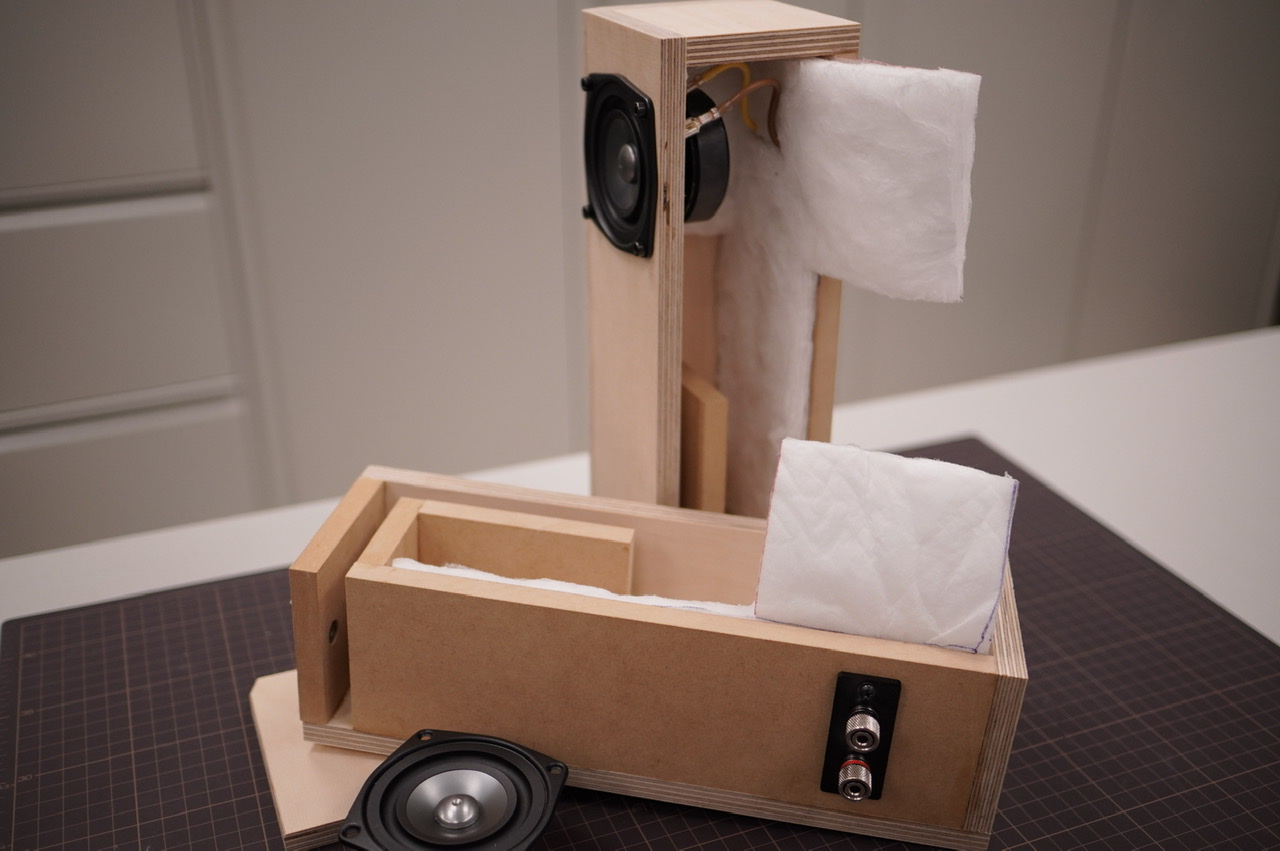

OM-MF4 is a 2 1/2in unit (Sd = 23cm^2) designed for Stereo Magazine / the 2020 Mook. I designed half a dozen enclosures for it, but they seem to have vanished into the aether; I believe the enclosure you see there was done by a chap MA's Japanese distributor knows. Not, quite honestly, how I'd do it myself, but it's what he wanted and no doubt suits the main Mook audience well. Being an elongated slot vent with a high aspect ratio I assume it will have a very low tuning in relative terms, although I can't imagine it has much output.
There is a series production unit called the CHN40 in the offing, which is distantly related to this unit.
