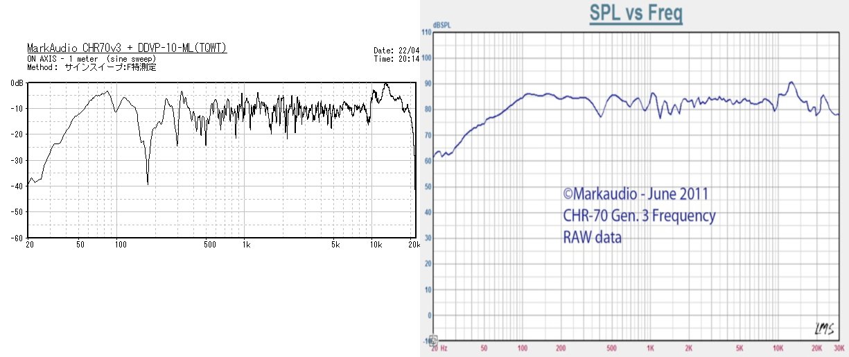

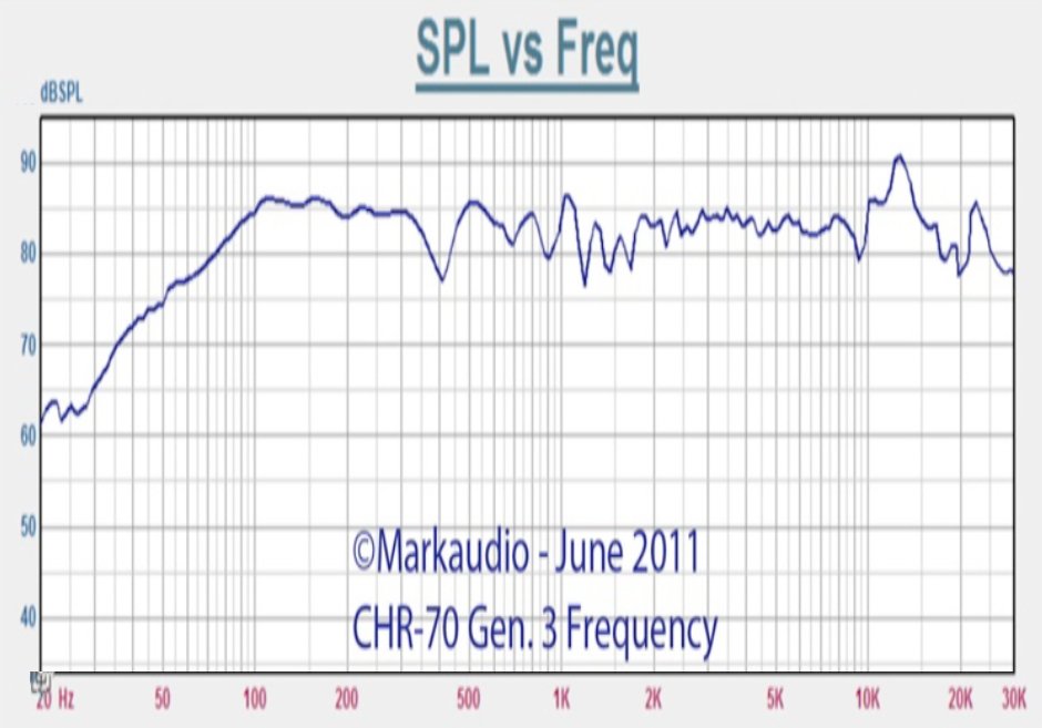

I’ve done measurements of the CHR70A. The test data looks good and so is the sound. The published frequency response from Markaudio is embellished to the extreme. They need to use a standard vertical scale of 50dB, not 100dB. It’s completely unnecessary considering the driver actually tests well. Why create and perpetuate a false standard where everything looks ruler flat?

Frequency response depends on the room and the enclosure, so I shouldn't trust the manufacturer's graph, lol.
Also, I don't think the frequency response graph has anything to do with how good or bad the sound is.

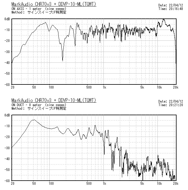

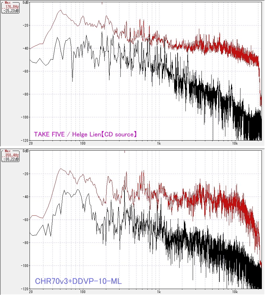

I understand Joseph Crowe's thoughts.
I have tried various methods of measurement in the past, but the measurement graphs do not match my aural perception, so I am now focusing on spectral comparisons between the CD source and the speaker playback sound.

And kudos for spending so much time complaning about MAs vertical axis scale.
1.5kHz is transition between pistonic and chaotic behaviour.
https://josephcrowe.com/blogs/news/markaudio-chr70a-fullrange-driver
Your measurements clearly show that CHR70A has major and very audible distortions at 10 kHz. You need to low pass it at 9 kHz and add a tweeter, don't let it play like this.
