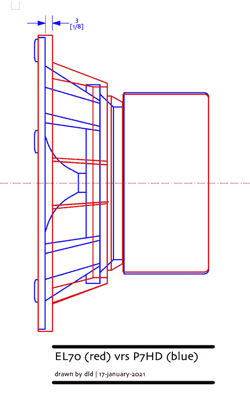

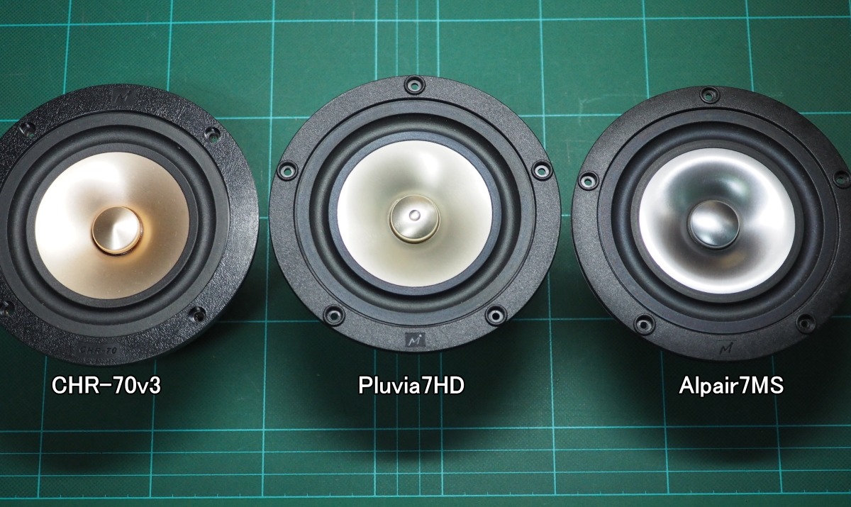

There is a thread where P7HDs can be (more or less) directly fitted, considered an upgrade. Original Pluvia 7 would be closest spec wise. Those all require reworking (shrinking) the cut-out and rebate.
I do have some CHBW and a set of CHP-70.2 that would also probably work and avoid redoing the rebate. Likely closest in voicing. Both lack top, so best used firing up?

Thx Dave, I will review the driver spec.
A shrinking of rebate and opening may be beneficial if its a small enough change because the EL-70’s were v tight and this contributed to the demise of one of them.

I don't have P7HD, was looking into MAOP 7 which fits same boxes. Here are a few that appeal to my perceived wants and needs for the driver, not based on actual accounts of the builds:Anyone got any good cab plans for pluvia7hd?

It turns out a lot closer with EL70 and P7HD, my initial comment was from dropping A7ms into A7 rebate where the difference is much larger.
Looks like one might get away with a thick gasket (thinking back i did just this putting P7 into CHR-70 rebate).

Yes, just a gasket. Digging out the image poked me to remeber the P7. I used ~6mm closed cel foam gasket tape from hoe depot, and it fitalmost perfectly into the hole the CHR-70 came out of (P7 differs from P7HD, EL70 differs from CHR only in the magnet).
