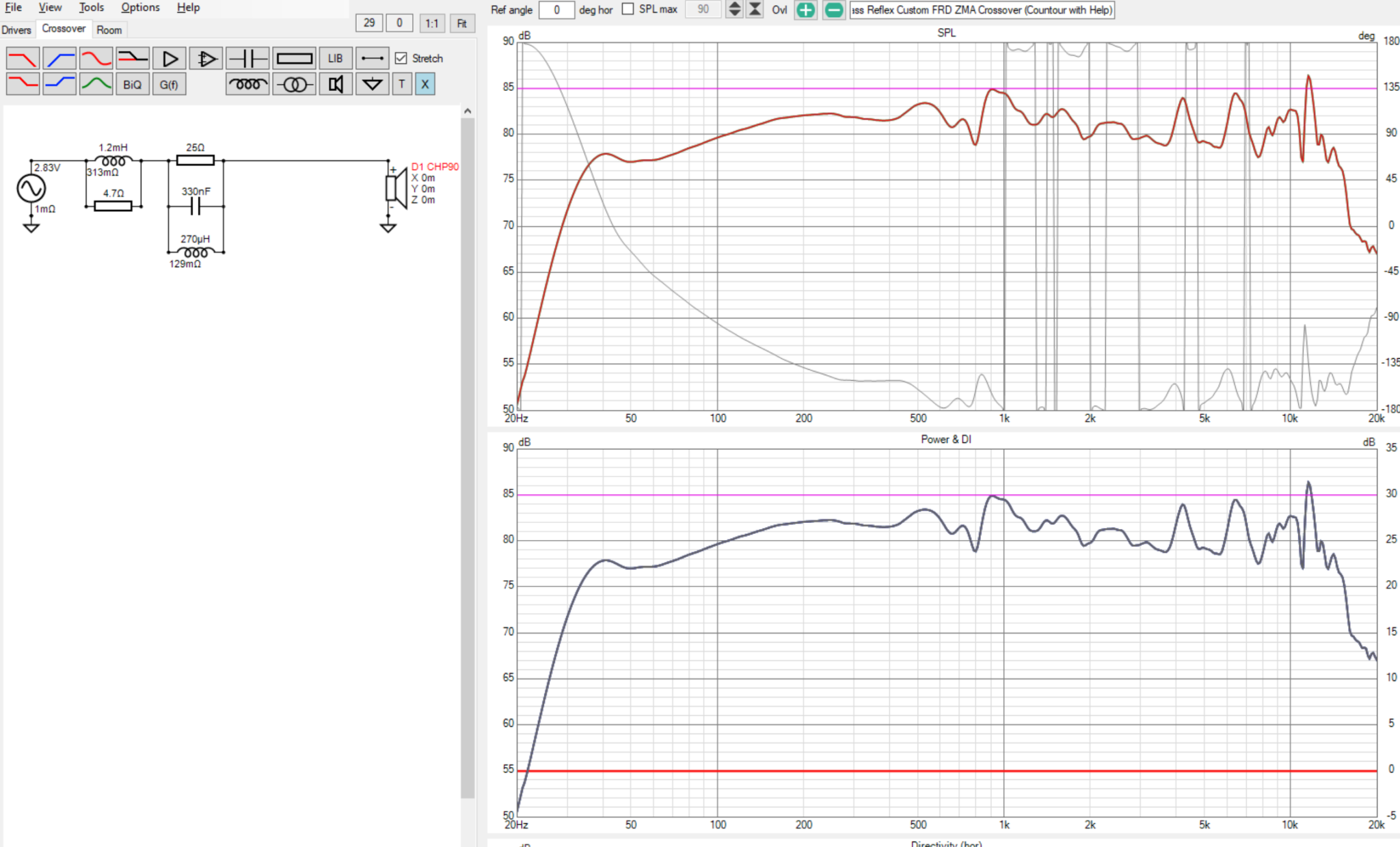

Here's the anechoic in-baffle response at standard 5db scale with zero smoothing applied:
Here's the published frequency response from Mark Audio on this driver:
Let's compare, theirs is free air, mine is on a large baffle, flush mounted, but the baffle changes things.
Notice Mark Audio's scale is 10db. This makes it appear flatter. Most use a standard of 5db. So, let's scale to the same as them. Here's my measurement using the same scale as the publication (0db to 100db). Note, they go out to 30khz, I went to 20khz. Keep that in mind, so only look to 20khz on their measurement.
Let's compare.
Spike/hump at 500~600hz, present just like in published version.
Spike/hump at 1khz range, present just like in published version.
Significant spike at 4.2khz, present but smaller in published version.
Significant spike at 6.5khz, present but smaller in published version.
Significant humping at 8khz to 15khz and a big spike right on 11.6khz range, present but less amplitude in the published version.
So it's not that different. I just have more amplitude on the same spikes, because mine is on a baffle and they get +6db to their range.

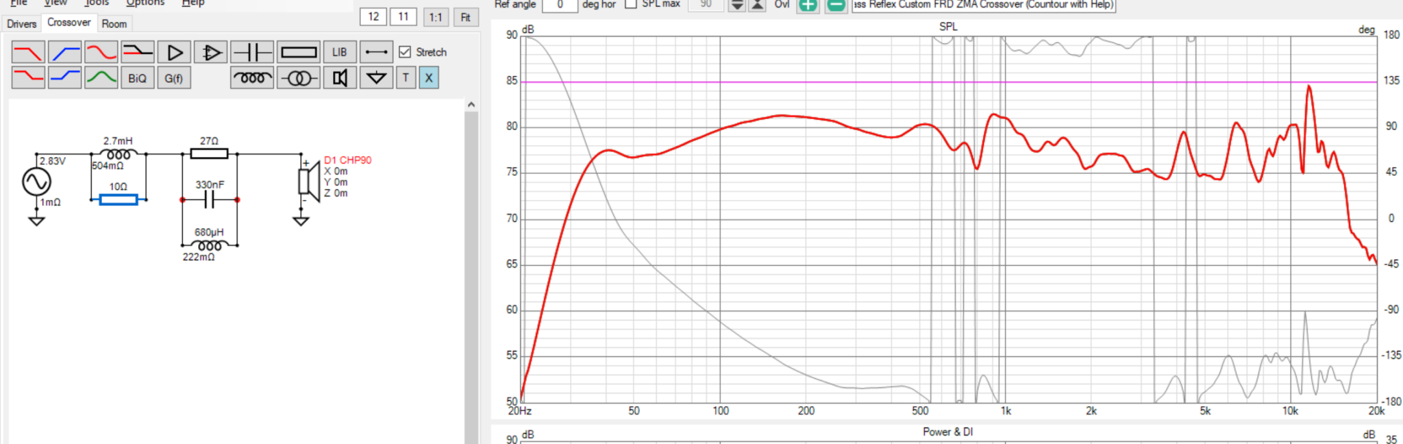

Just following up, here's how it played out.

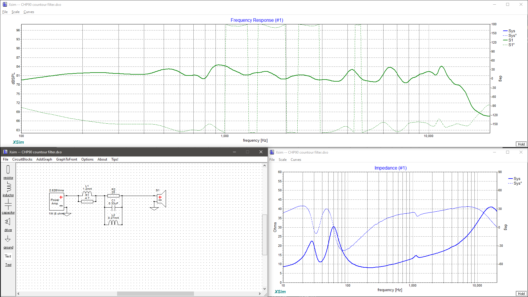

I took my anechoic measurements above and put them in virtuixcad and played with a contour filter. Just basic baffle step and a cap to lower the upper region. It seemed simple enough, no notches, etc, to keep it simple and inexpensive.
Here's the circuit simplified.
What the filter is expected to do to the response as an "EQ":
Predicted response & impedance:

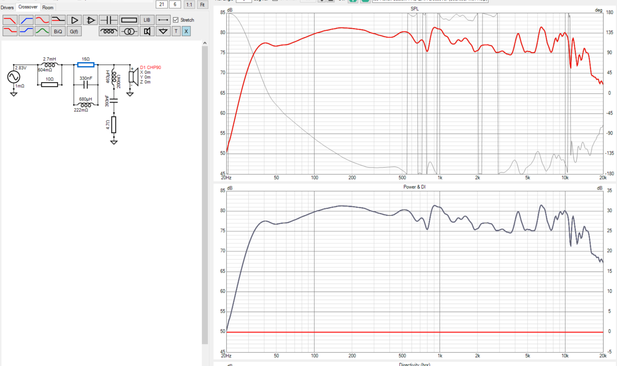

I thought about adding another resistor, 15~16ohm, as seen here to further flatten out impedance, if it actually behaves that way:
Predicted result would be:
Then I built a temporary contour filter as above, but without that 2nd resistor (the 15ohm one). I may add that. I will test further.
Here's the initial results.
These measurements are not anechonic, just in room at the listening position, just a quick dirty metric to see if the filter is going the right direction at all or not. This is not gated, or corrected at all. I will do that at another time when I finalize the filter.
Red is the raw response with no EQ and just straight from an amp.
Blue is with the contour filter in place (the first one above) to see if it handles as expected.
It worked well. It sounds great. It's much flatter and the peak above 12khz is calmed way down. Now when its turned to listening levels it's flat sounding and has good extension to 40hz and sounds as I would expect. So, this may be the final version of this filter. Unless anyone can suggest a way to do this even better. But so far, this is great, and its super duper simple.

The added 15 ohm resistor will get hot as its across the amplifier without a highpass. Please attach it in series with the 10uF across the driver.
All you did by adding it as shown was reduce output potential by burning off wattage as heat.
Which resistor are you referring to? The first 10ohm with the inductor? Or that 2nd resistor, 16ohm, in the 2nd iteration?
Edit: sorry duh you stated the 15ohm. That one is not currently in the filter. That was just another iteration looking at impedance. It didn't change the response so I didn't include it. It's currently not in there, and if it's not helpful, it won't go in. I'll keep it super simple with 3 components currently. Thanks for pointing that out.

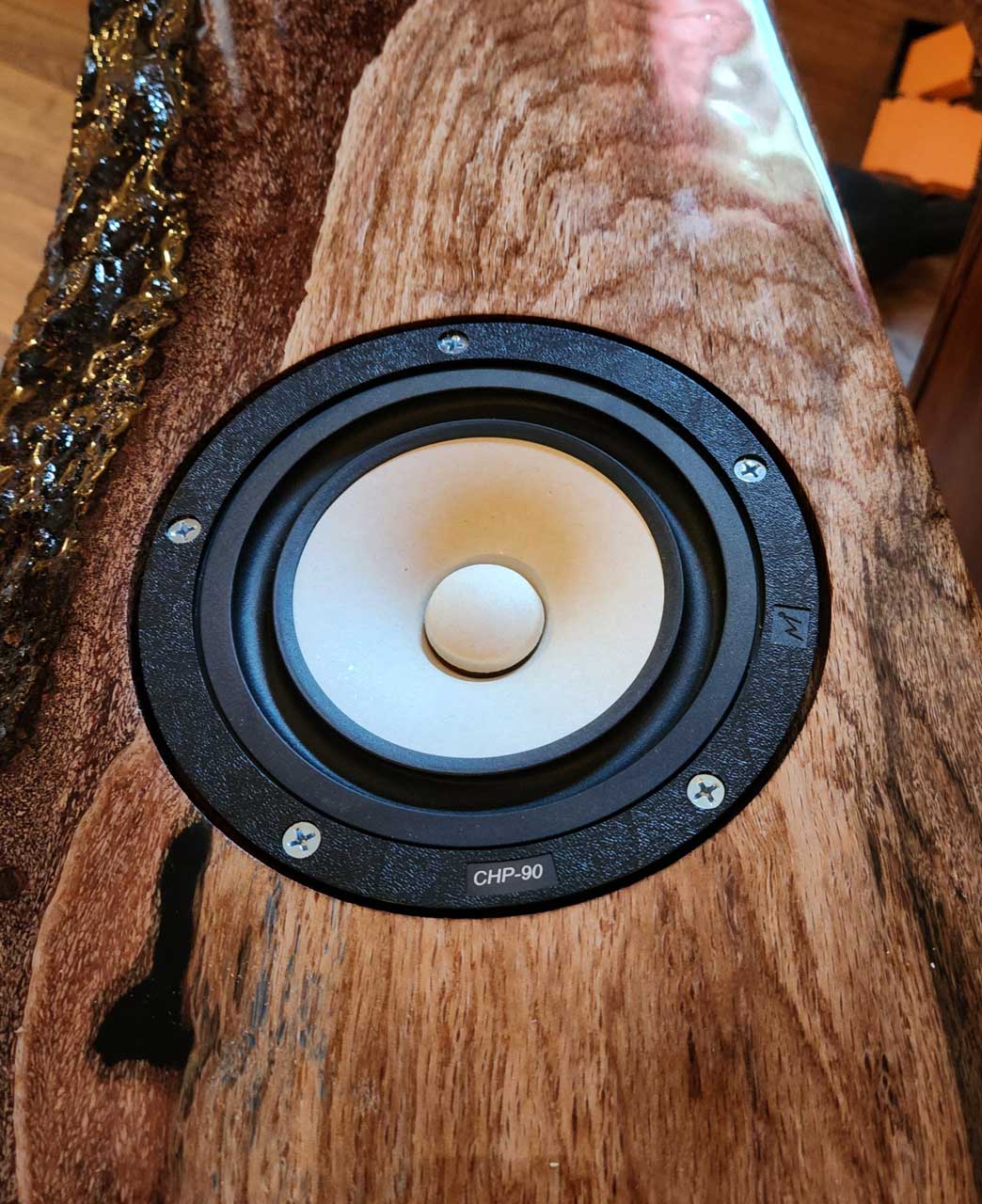

I have a partial build log here, that is shorter, here on DIYAudio:
Thanks! Yea, it was around 450~460g into less than 1 ft^3 since the lower chamber was not stuffed with polyfil. Still, without measurements, I wasn't hearing anything weird.
Thanks! It was definitely different for me, just trying different things to step up my finish game. Learned a bunch on this one.
My complete build log with every little detail is here on AVS:
https://www.avsforum.com/threads/markaudio-chp-90-bass-reflex-monitors-live-oak-slabs.3309193/
I designed it larger than was needed for the tuning, I over sized so I could get more of a peak potentially at its tuned value. This is not necessary and ultimately didn't work exactly as expected, but still worked out well. Bottom line, its a 1 ft^3 net internal volume tuned too low for what it should have been. Its Fs is 48.5hz. I should have tuned closer to that. But I pushed down to 40hz to see if I could and while it works, its not optimal. Up to you how you want to do things. The port length entirely depends on the volume and tuning and the type of port you implement (and where).
See my AVS build log for every little detail and if you have questions I'm happy to help out. Not a perfect build, but learned a lot through doing it.
Now I'm going back and doing a contour filter to smooth it out without EQ.
Very best,

Update, finished the contour filter and measured it.
Here's the simple filter I ended up doing:
Here's the filter built:
And updated measurements with this filter:
Final response, fully corrected:
The set:
Very best,
