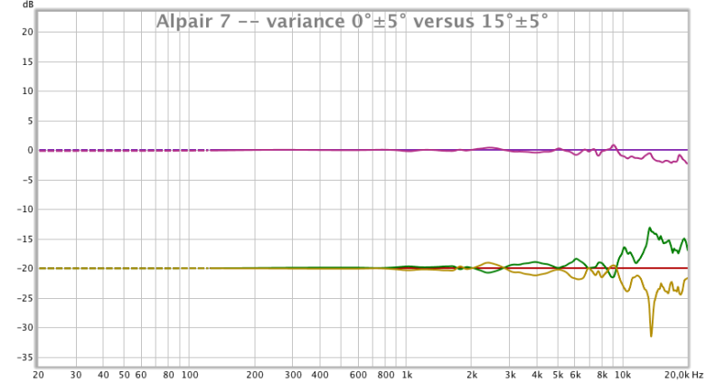

It needs some equalization though to reduce the 5-10dB step above 10kHz.
If you EQ out the peak on-axis, you will reduce the response by the same amount at 15*. As yourself -- are you going to to listen to your speakers directly on axis, or are you going to toe them in/out some number of degrees? I've been playing with the A10, which go dead flat at ~30* off axis, and that is where I listen to them. Your A7's are flat at 15*. No EQ required.
Bob
Bob
I don't consider the response at 15° in my measurements as particularly flat. So I would use EQ anyway.
Equalizing in relation to 0° will result in way less variance throughout the listening window than equalizing to 15°. Here's a comparison.

Your question was "are you going to to listen to your speakers directly on axis, or are you going to toe them in/out some number of degrees?"
My measurements show that there's less variance around 0° and a lot more variance around 15° hence the response will be much smoother within the listening window around 0° after EQ. This is how I would listen to the speaker in a stereo configuration - toe-in of 30° so the speakers point at the listening position.
