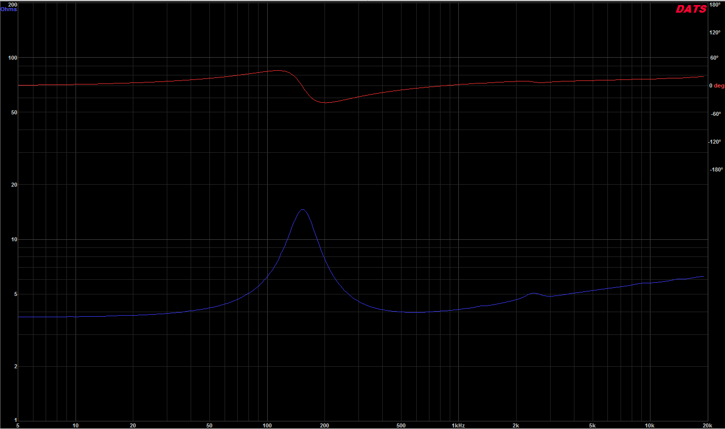

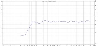

I don't have a set of CHN50s here, but the attached is a Sota 5 on DATs V2 that I took a couple of years back.
I wouldn't get overly concerned about the impedance. Current draw in the higher frequencies tends to be fairly minimal, so it would have to be a very limited amplifier indeed that would struggle to drive them. Put it this way -my computer speakers are a pair of pre-production Viotti Ones, with a crossover modified to my personal tastes -they don't have a series resistor on the Sota 5 (in fact, no resistors at all) -nothing that I've put them on the end of has had any issue, output limitations notwithstanding.

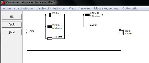

bregargasper,
I really like your speakers. Beautiful work, and I bet they sound very good.
Please help me to understand your compensation networks.
First . . . the parallel 0.1mH and 0.2uF resonates at 35.6 kHz.
Did I read your component values incorrectly?
Second . . . I think I understand the parallel 0.383mH, 22uF, and 47 Ohm resistor.
The resonant frequency is 1734Hz, and the Q is 11.3 (before it is loaded further by the driver impedance, causing the Q to be less than 11.3).
Did I analyze that network correctly?
Thanks!

Thank you sir

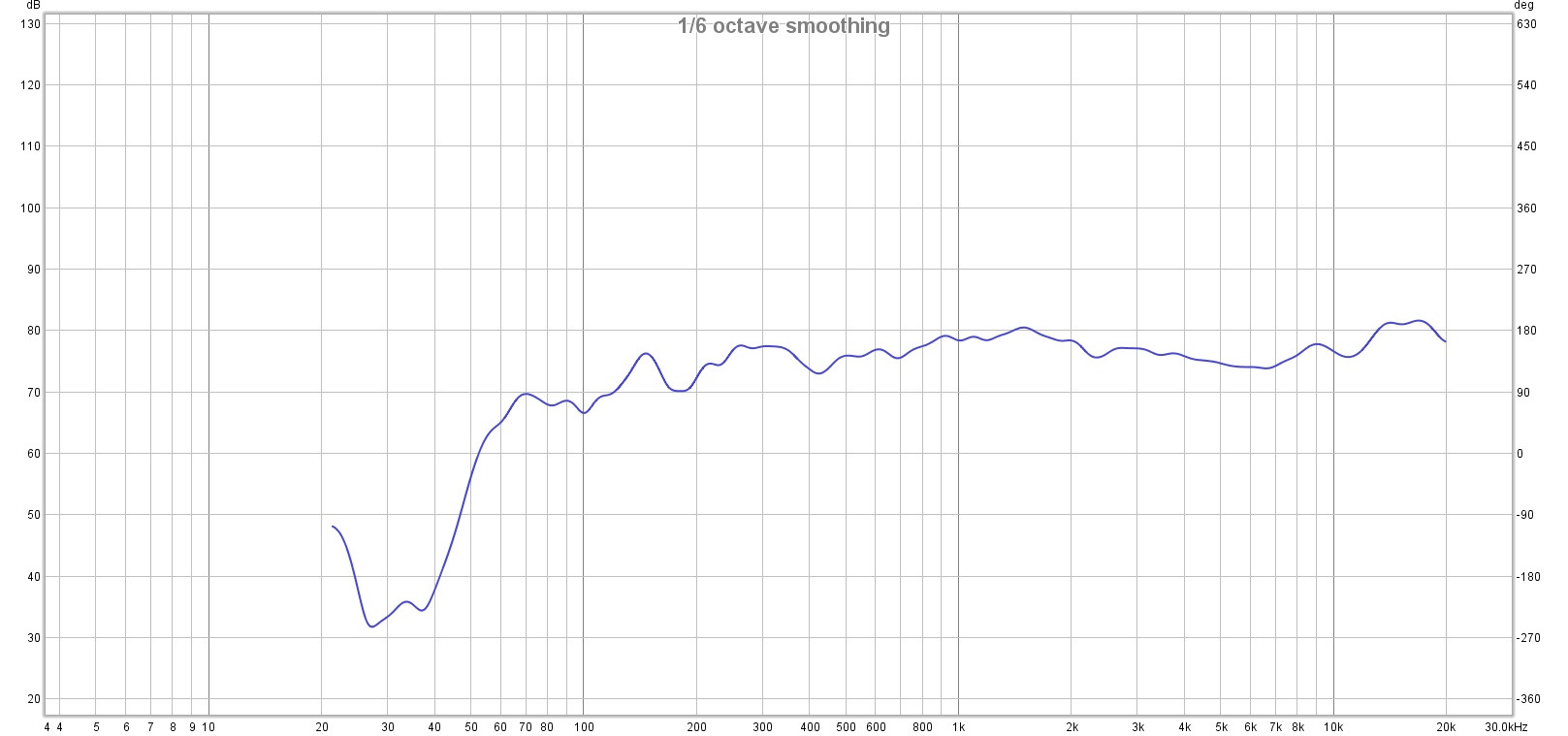

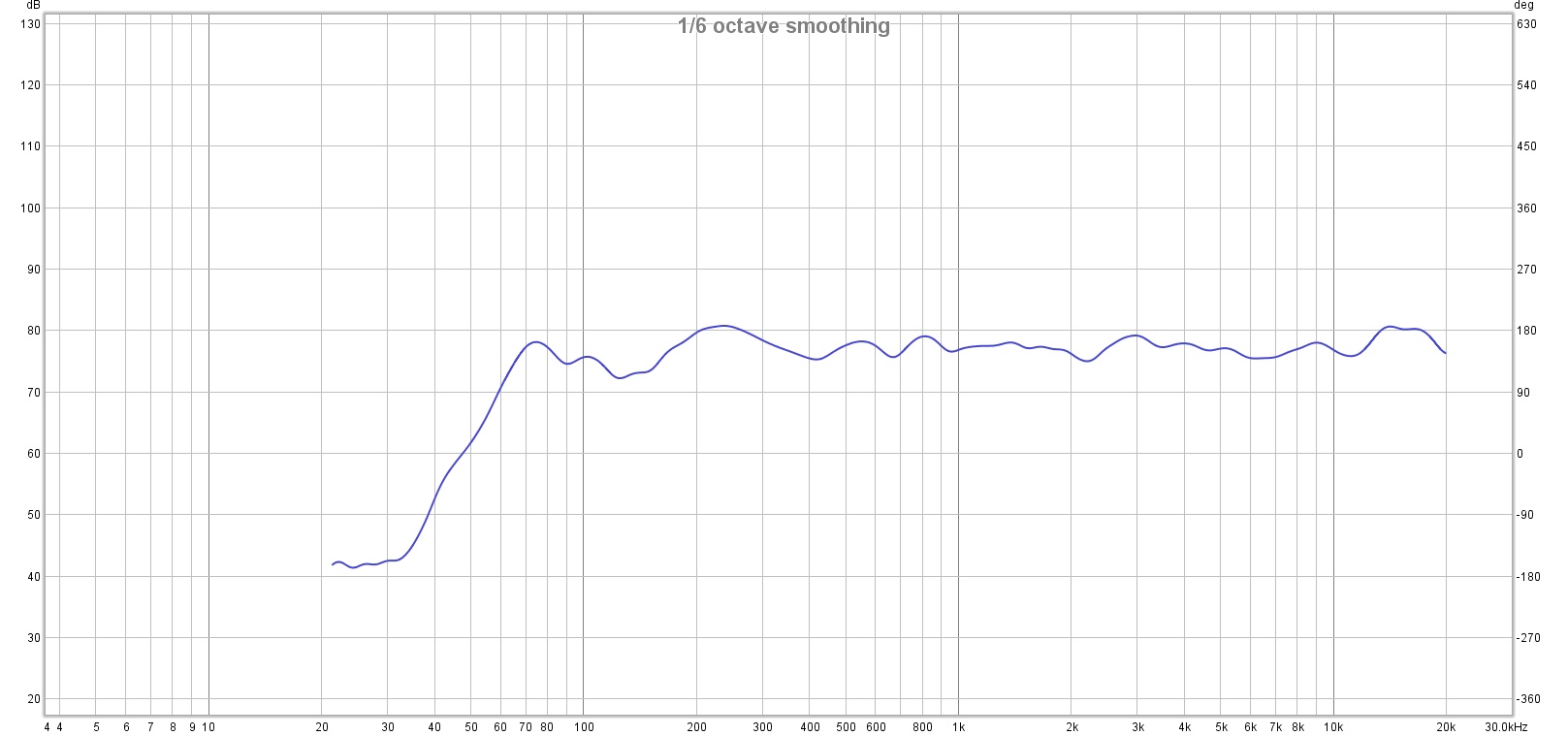

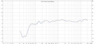

You are correct. I attached measurements with and without correction network. You can see two elevated areas that I tried to correct and all I really did was play around in Xsim. After all I am an electronics engineer so I believe in simulations 😀 Listening to the speakers I was amazed how well they perform. The only problem still is high frequency dispersion.First . . . the parallel 0.1mH and 0.2uF resonates at 35.6 kHz.
p.s. measurements are not level matched. Still working on a setup that will allow me consistent output levels

system7,
Thanks for answering my question regarding the Q of the 1734 Hz network
4.7 Ohms seems more like what it should be, just as you said.
As is so often, the picture and schematic files on these posts have so poor resolution,
I could not see the period between the 4 and the 7.
However, nobody answered my question about the 0.1mH and 0.2uF parallel resonator . . .
That is 35.6 kHz, far above most tweeter's response, and far above most of our ears response.

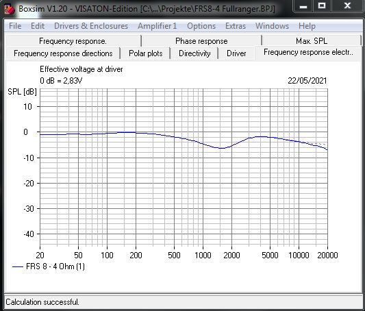

My simulator only goes up to 20kHz, as do the driver files.
L-C Filter Equations
You are right the notch is at 35.6kHz however.
In practice parallel LC traps are inductive below resonance and capacitative above, And blocking or notching at resonance.
The sim reveals that a simple inductor does much the same thing as a trap up to 20kHz on a similar fullranger. The dotted line is the coil on its own.
