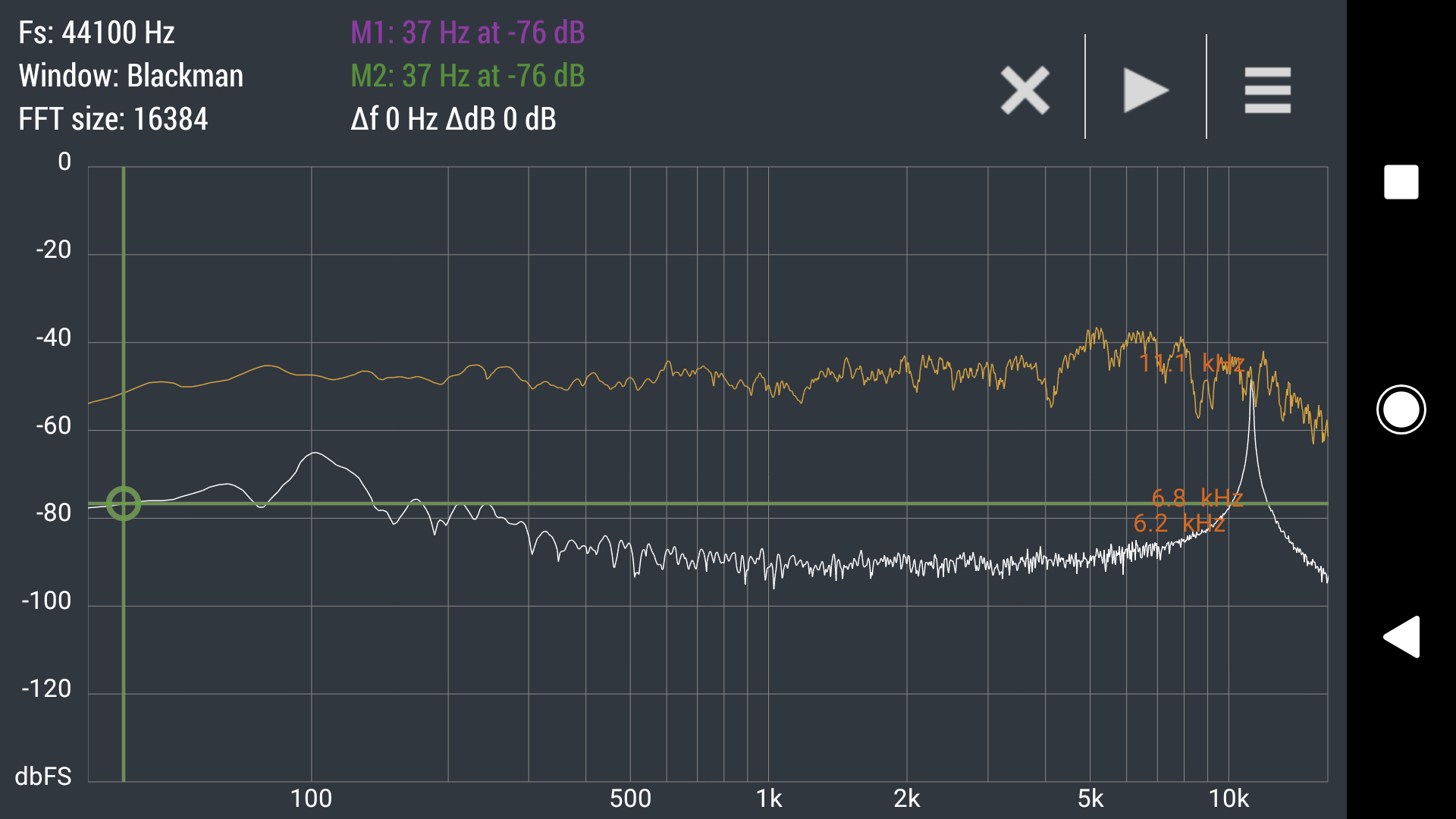

Nice work! The measurement look very good and you are getting quite the bass extension. Must sound very nice.

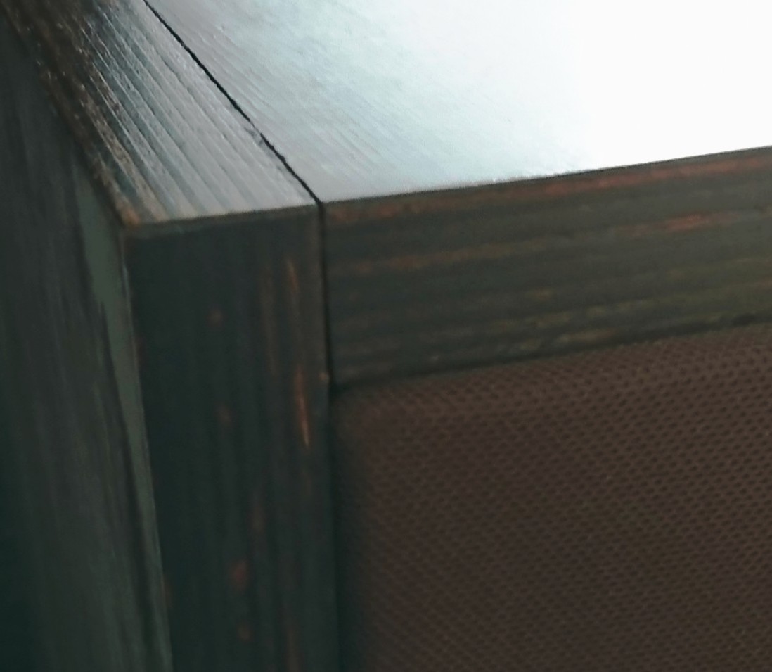

The 4kHz dip is probably not a big deal as dips that are narrow are not noticeable - vs peaks which are. 4kHz corresponds to a 1/4 wave reflection from a feature that is 2.1cm from the driver cone. Perhaps it is the slight raised edge on the sides next to the drivers. Or it may be the width of the driver bezel as it is not rebated and flush. I like boiled linseed oil very much. Makes a great finish with a deep lustre. I sand with very fine grit paper when oil is wet. The small particles embed themselves into the grain crevices. Then when the oil cures, it makes a smooth surface with voids filled in. It can become smooth and mirror like even though wood started out full of grain.
I also did my Karlsonators with BLO, if you look at the reflection from the top panel you can see what I mean.

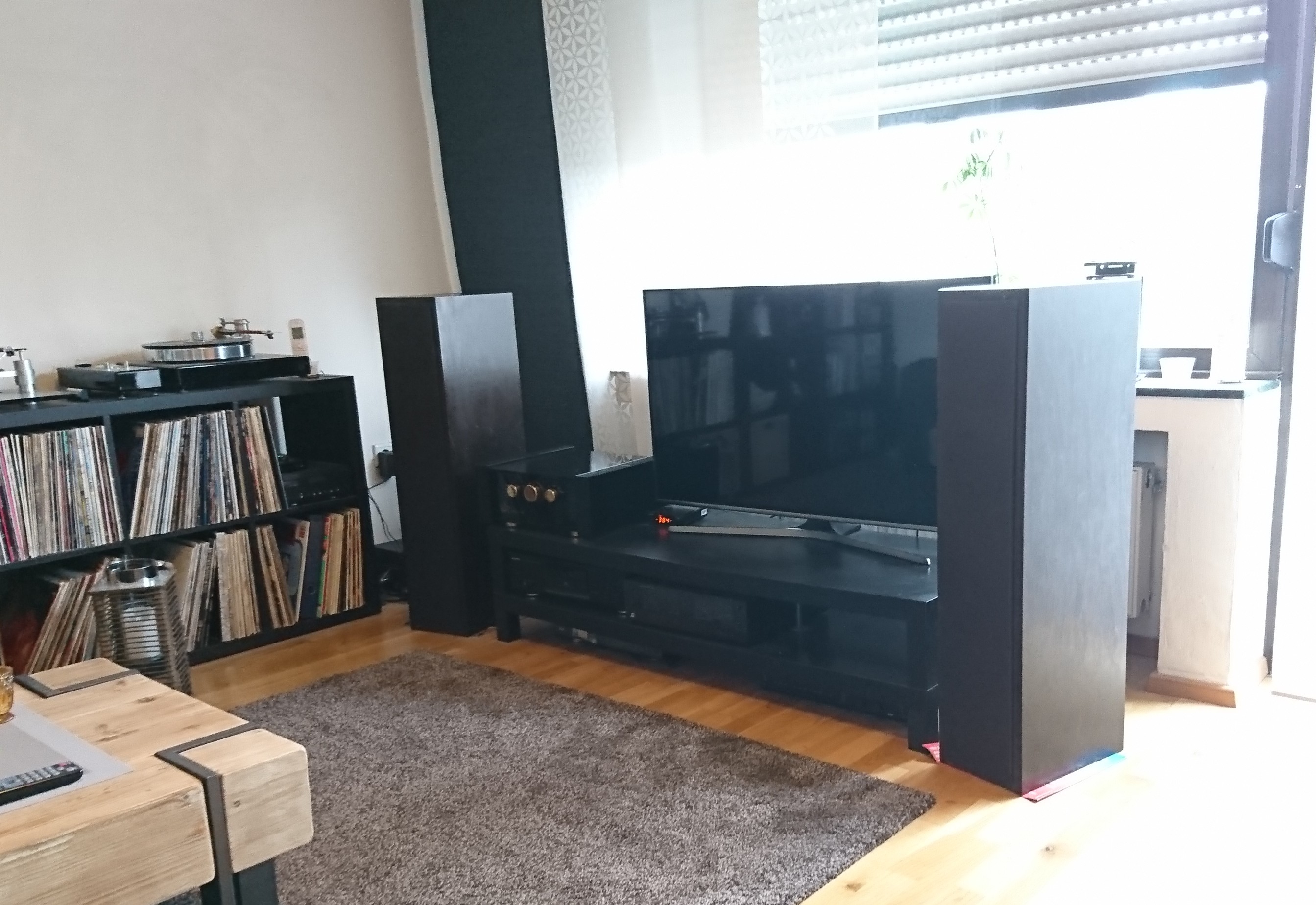

This hybrid design plays everything with ease.
Doesn't matter how loud. They can play very loud and undistorted.
In my high fidelity life I owned about 20 different speakers. Infinity kappa90 renaissance, quadral vulkan mk 5, t+a tb140, magnepan mg1.6, martin logans, apogee, adam audio, kef, tannoy. Just to name a few of them. These alpair hybrid design is definitely in the top leage.

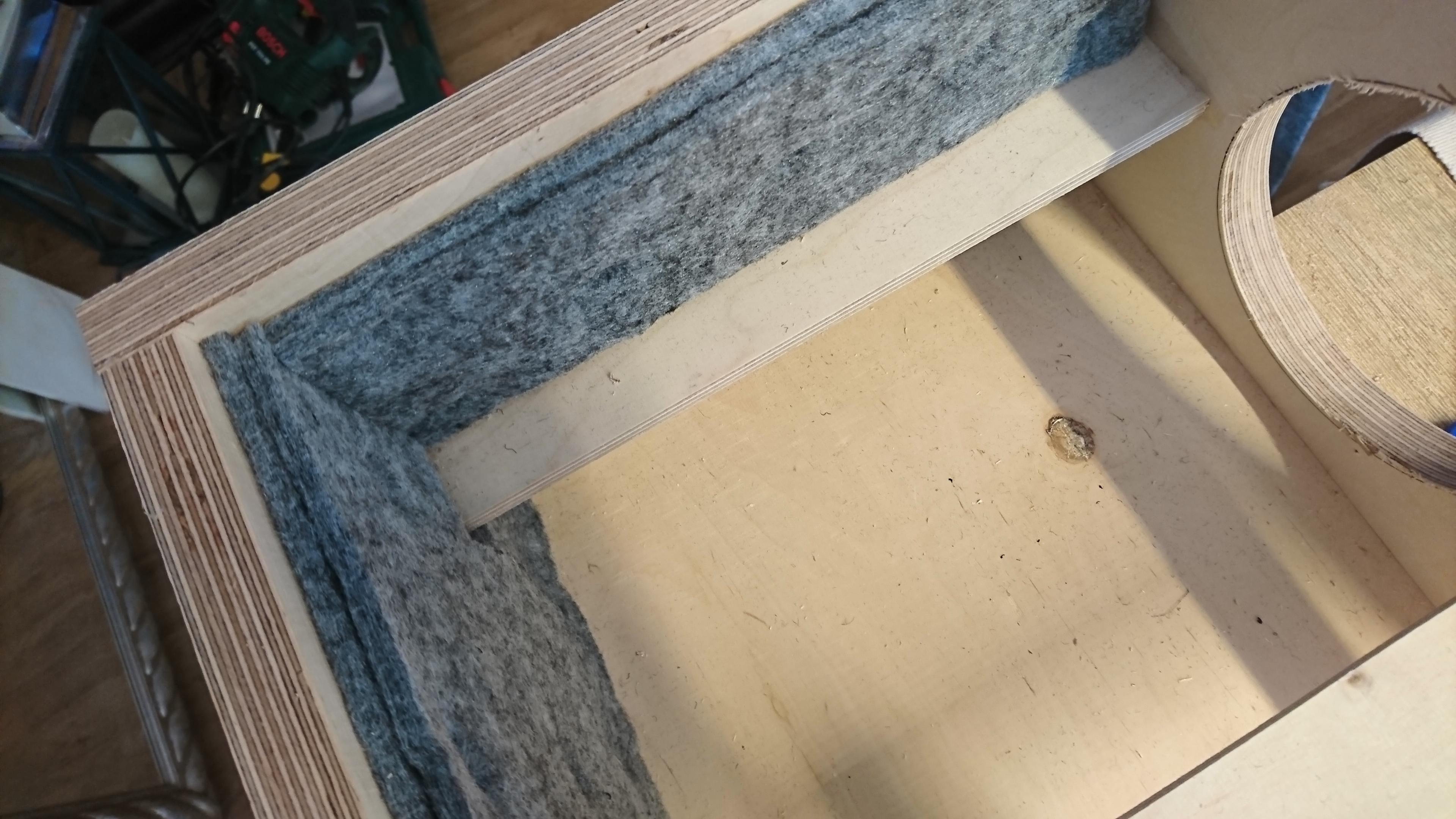

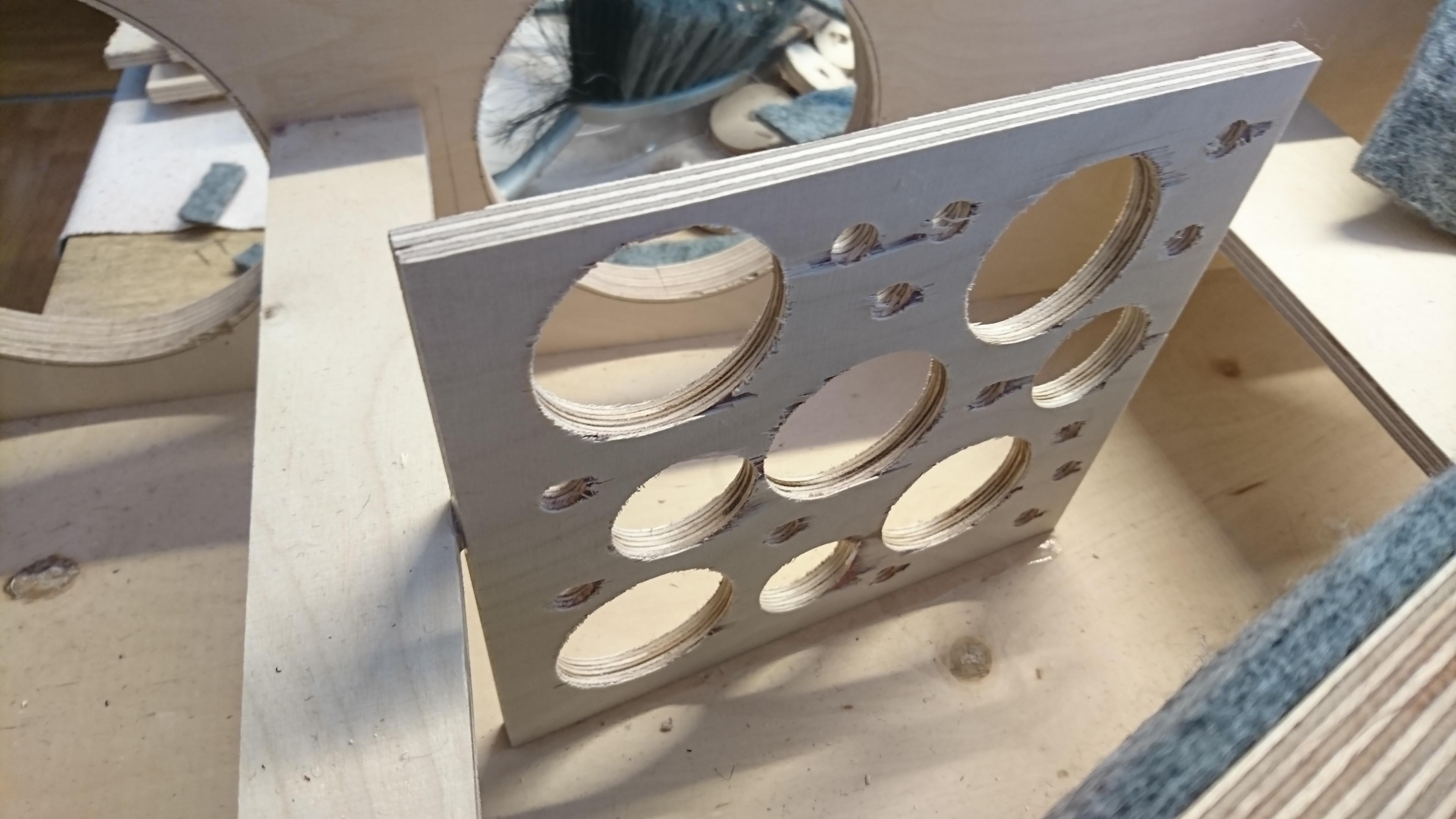

Felt on the top, back and one side of the box. Just below the lower driver. Holey brace also with one layer of 5mm (not aplied in the picture yet)
The final result, uncalibrated at listening position.

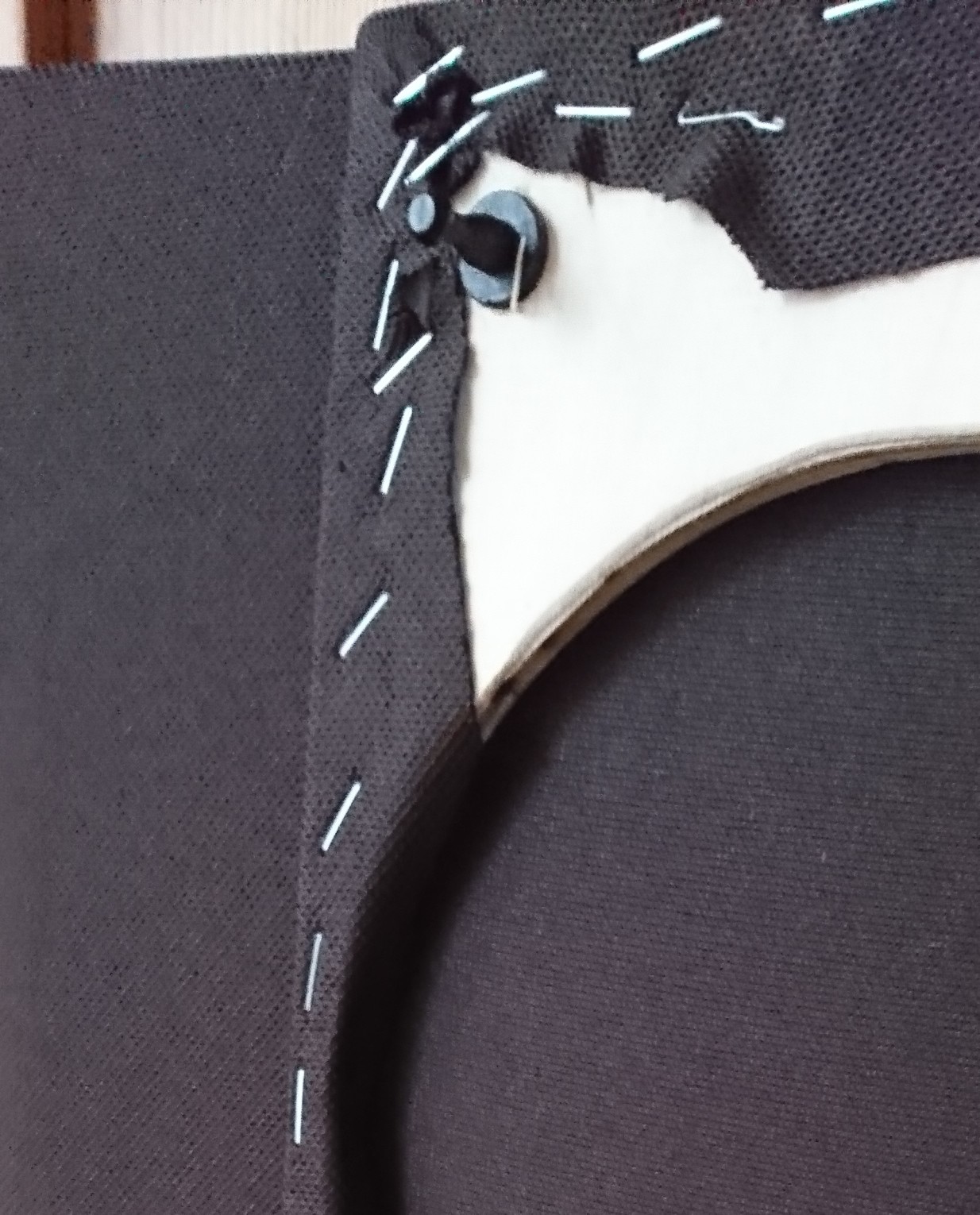

Covering the front panels with cloth was easy doing.
First I attached a 10mm strip of double sided tape at the edges of the inner side of the panels. The corners were left out.
You can cover the panels with the cloth which will stick to the tape very well. It sticks just in a way that you can adjust the correct fit and tension easily. Then finally fixed the cloth with a staple gun. After that stretched the cloth around the corners an fixed with staples.
Perfect fit.
