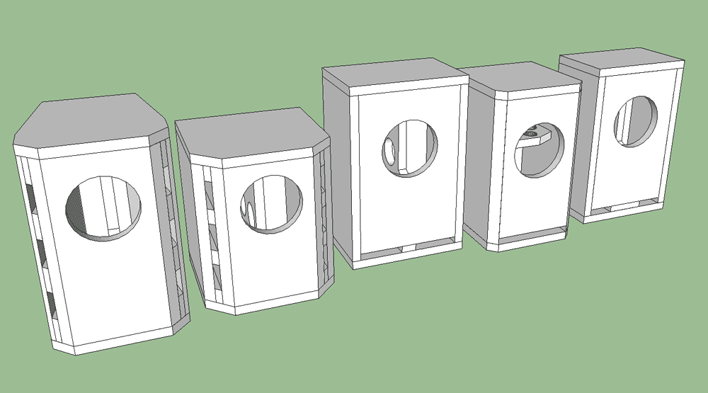

My miniOnkens, the primary ones, were inspired by the side vents in an Onken i saw in a late 1970s in an Audax design booklet.
But they do not use the official Onke alignment.
The vents are purposely long and narrow contirbuting R to the vents and pushing the box from pure reflex towards a more aperiodic alignment.
This typically yields smaller than typical enclosures, they only go as low as they go, bass is elegant and articulate. Partly due to a greater tolerance for dynamic changes in T/S parameters.
