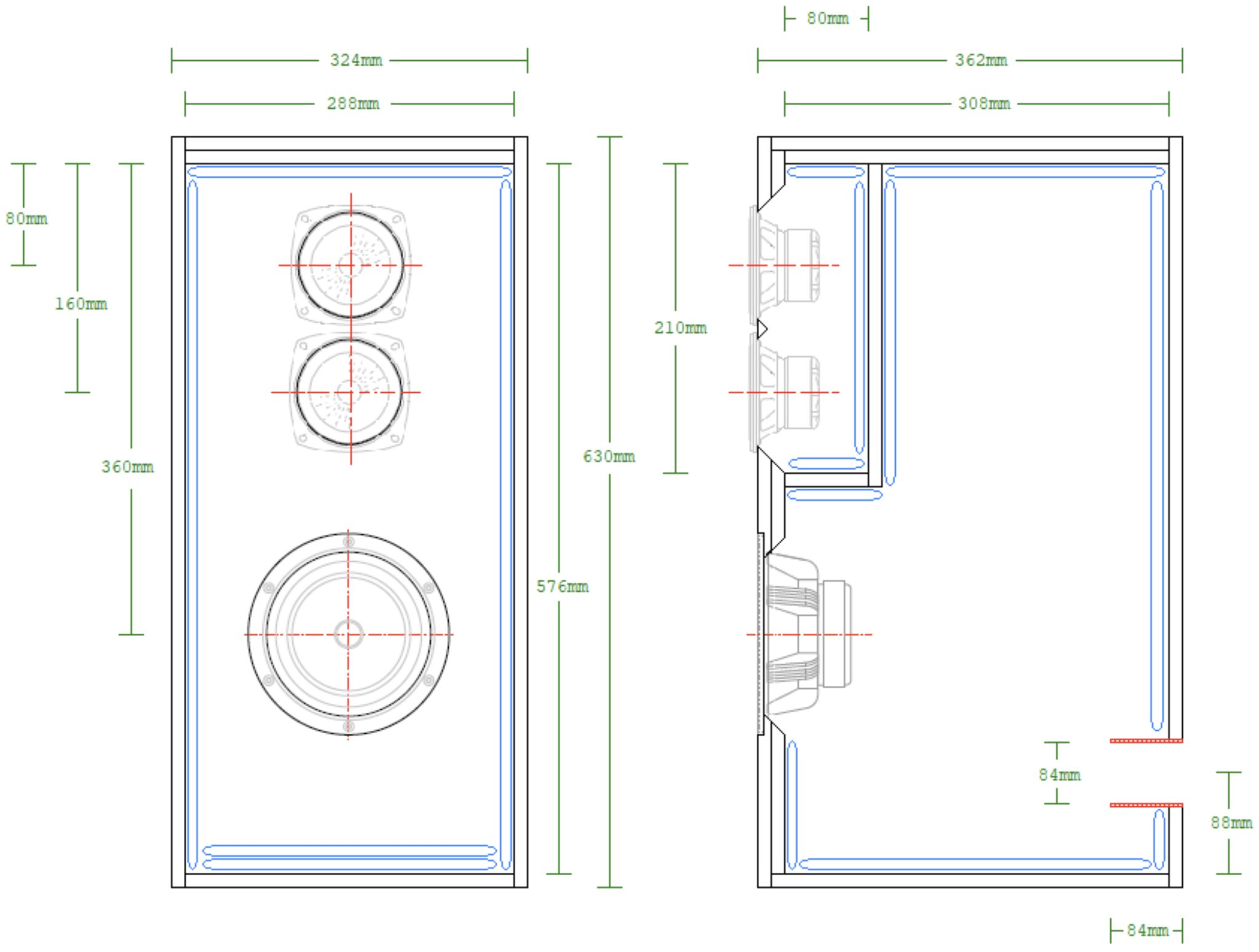

An idea:
WAW, CHP-90 as mid/tweet, and a pair of CHR120 as bass drivers. Won't be the cheapest, nor the most expensive combination.
Something tells me that it can sound good 🙂

First example from the collection nof Scott’s designs sstill not drawn up properly.

Yes dave I agree. I could cut the A10.3 at 80hz and put in a low end driver passive or just use a powered subwoofer and cut that in at 80hz on the cut off frequency. I know an Audiophile who builds everything from scratch and he swears by the A10.3’s in the floor standing Penicls 👍.WAW is Interesting. You could pick a better bass driver than the A10.3 thou.
