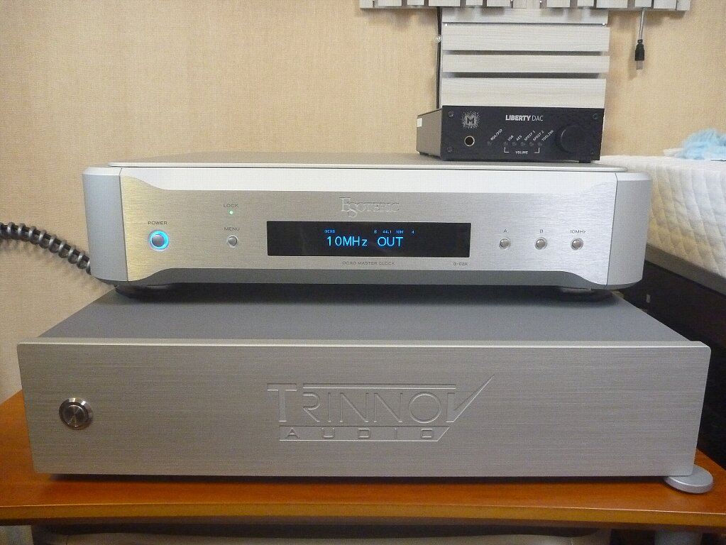

My friend did a lot of corrections with Trinnov Audio ST2 HiFi.
He says that he has not corrected it now, because "In the end I have much to gain, but much more to lose."

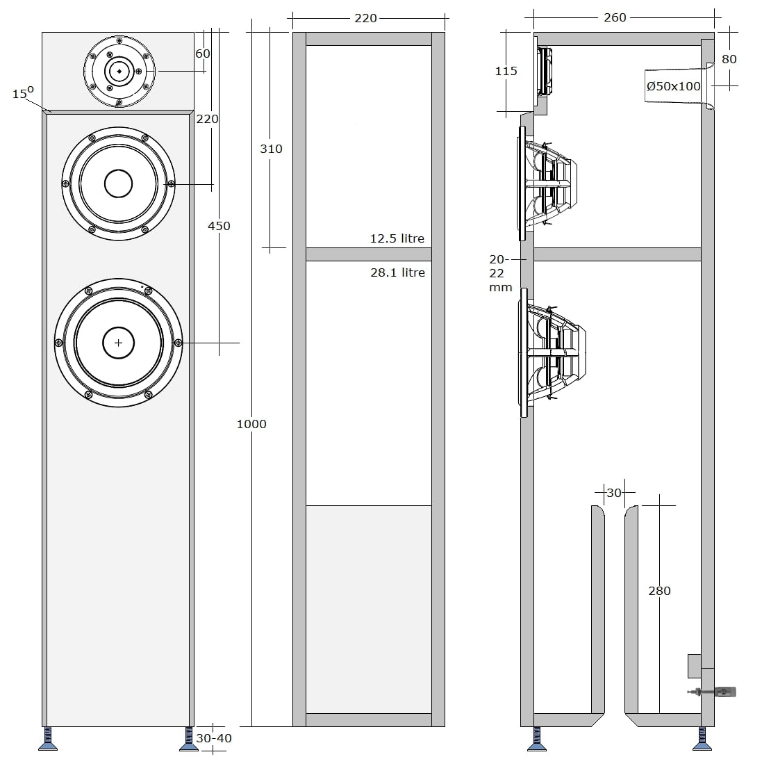

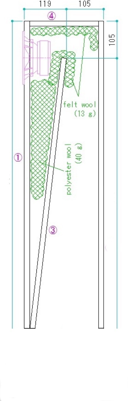

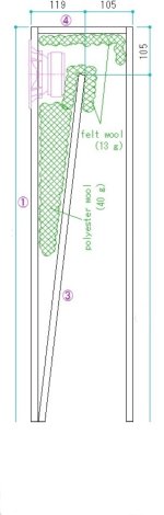

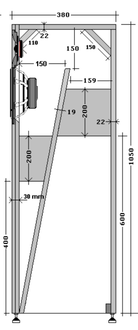

@nandappe can the duct on the DDVP-12.5-ML ble changed to a round port? Converted to the same port area/size ofc. That would allow me to experiment with different tunings 😃

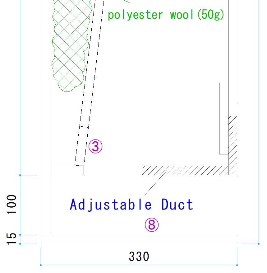

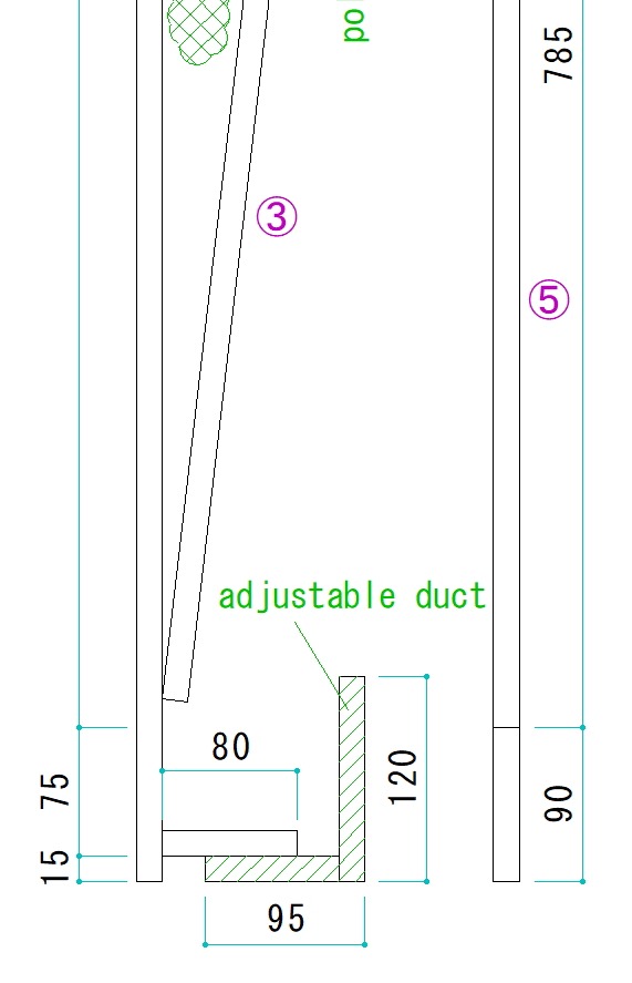

It seems like a good idea to block the front duct and attach a round duct or a variable duct to the rear.
Could one achieve the same thing by having an open bottom and use adjustable feet/spikes to tune the port? Kind of like what Troels Gravesen did:

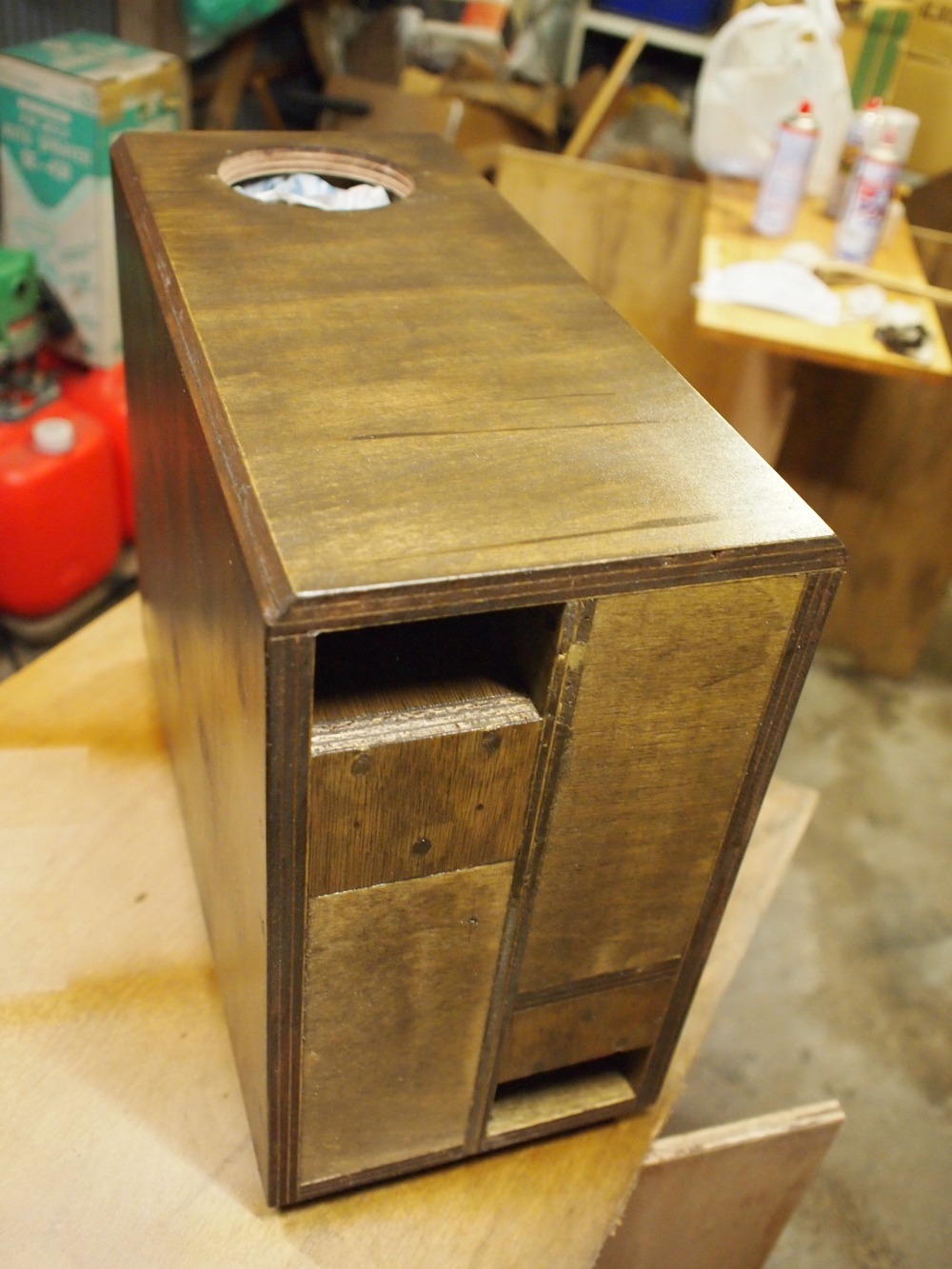

My friend uses DIY-Loudspeaker's SBA-761, but he says it is troublesome to adjust the height of the aperture.

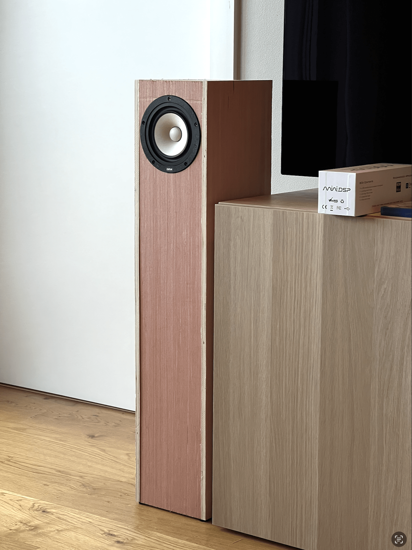

Thanks for the explanations! I'm leaning towards @nandappe 's DDVP-12.5-ML with an open bottom. Unless there is a reason this won't work as well as the original port? I'll construct a simple method for adjusting height and thus tuning 😀

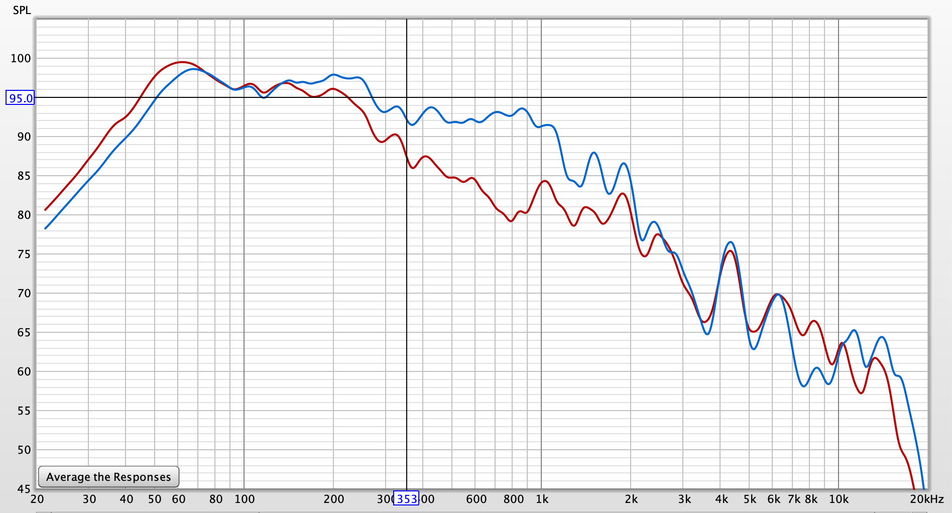

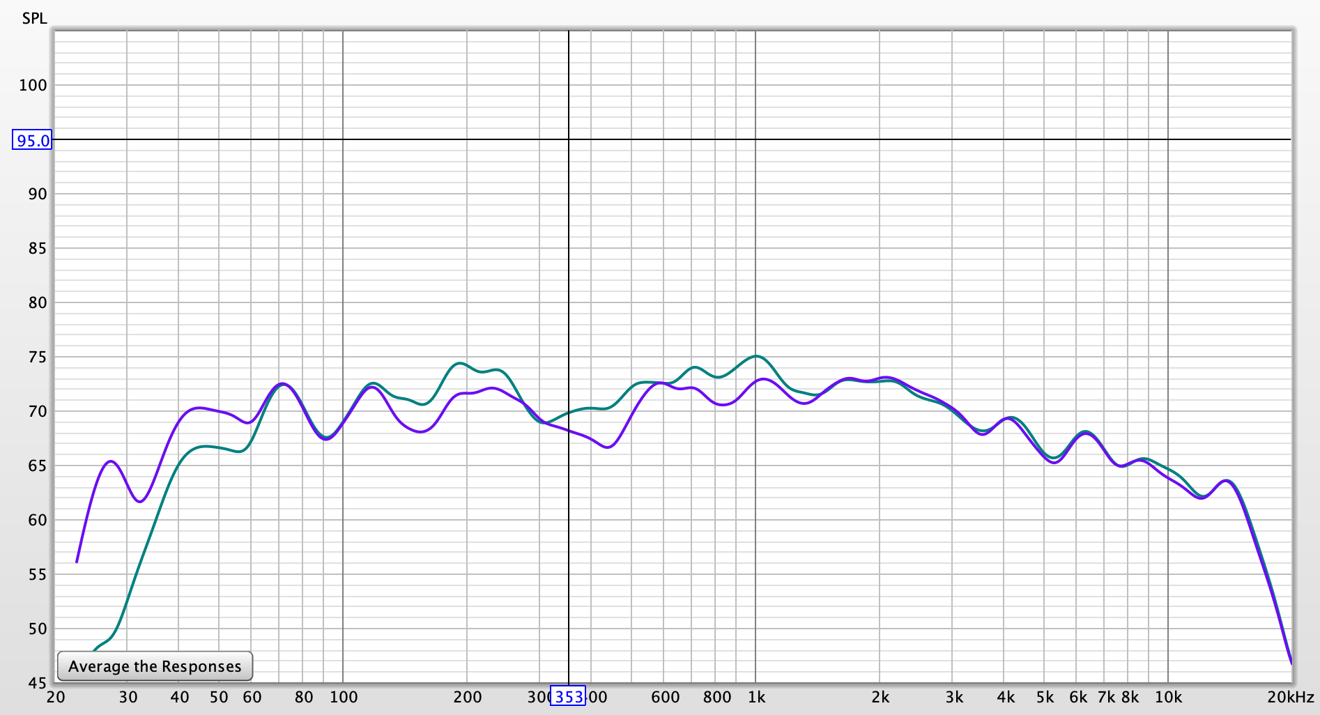

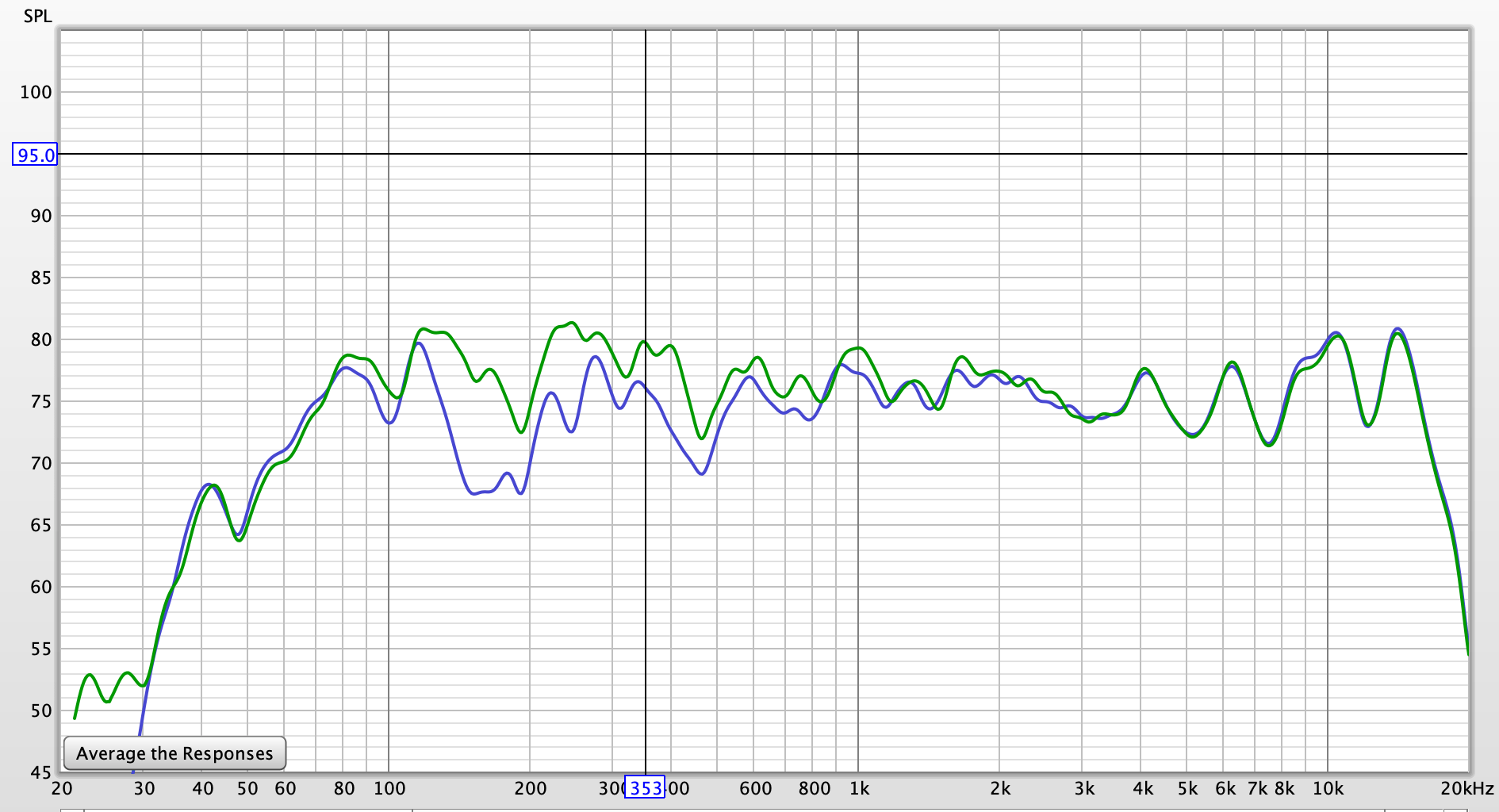

Threw together an open end DDVP-12.5-ML test enclosure using the floor as a damp duct with a small 0,5 cm opening and a large 7,5 cm. Pretty good results I'd say! The smaller opening boosts the low end by quite a lot far field (not much difference at 1 meter).
Measurements are ducts, near field (1 meter) and far field respectively. No gate.
