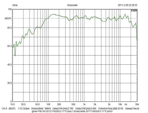

I've been looking at enclosure options for the Markaudio 7MS and CHP90.
Ideally I would like to build one enclosure suitable for both, but I recognise that this might be far fetched.

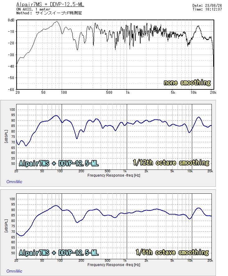

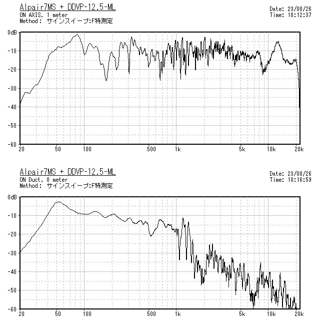

What I've found interesting is that opposed to a regular BR, some of these more complex enclosures have wide backwave output in the mid bass, mitigating baffle-step losses.
Just look at this one from @nandappe :
I defer to people more competent than myself, but FWIW:
That's an extreme nearfield measurement of the vent output & will likely have a much narrower BW if measured at a greater distance (not practical except in freefield conditions). Realistically, for a bass load you don't want the cabinet to be producing anything significant > ~300Hz or group delay will become an issue.

According to the on-axis measurement of the CHP-90 in initial post #1 , the eighteen decibel "hole" from 120 hertz to 250 hertz...pity the musician whos' instruments fall into that frequency range, their performance "disappearing"...Not Hi-Fi ,..
rather, No-Fi ...
--------------------------------------------------------------------------------------------------------Rick...
rather, No-Fi ...

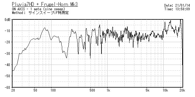

The large dip is due to the room, and the same dip will occur in Frugel Horn Mk3.
rather, No-Fi ...
Er -could I gently point out that isn't an 'on-axis measurement of the CHP-90'. It is in fact an on-axis in-room swept-sine measurement of a CHP-90 in a particular ML-horn in a particular room acoustic.

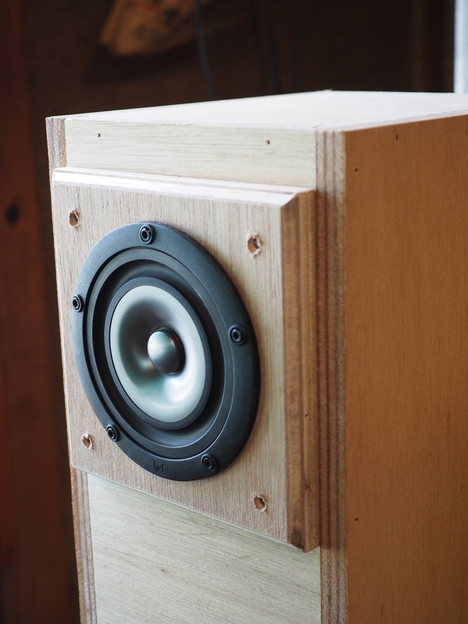

I installed Alpair7MS on DDVP-12.5-ML.
It has a lot of bass for me, but it seems to be good for bass lovers.
Wow, seems to work great! Seems I can just build this with a removable baffle for both the 7MS and CHP-90 😀
Do you have plots for more enclosures? What does the vent output look like for a MLTL for instance?
No, it's an MLTL rather than an ML-Voigt / ML-horn like Nandappe's so it has a slightly narrower operating BW. However, the driver has a naturally rising LF response < 500Hz which largely counters typical step-loss, so it doesn't need as much assistance from the enclosure (unless you need greater LF headroom, in which case a horn is needed).
rather, No-Fi ...
so DDVP-12.5-ML (TOWT) may not be the best box plan for the driver which doesn't appear to have the deep dip ~ 150 Hz - 202 Hz
So just how are we suppose to "A B" two differing drivers in two different enclosures in two different room acoustics?...too many variables. This is why we must have a baseline (same) enclosure, and a baseline room, we used to use anechoic chambers... Room acoustics can be virtually infinitely "adjustable"...an absorption panel here, there...even down to a particular paint on a "live" surface.
Even the Alpair 7MS according the graphing has a giant hole centered at 300 hertz down 25 decibels...the note on a piano is D4, at 293.665 hertz ...this note would essentially disappear with this loudspeaker.
-----------------------------------------------------------------------------------------------------------------------------------------------------------------------Rick...
...when that is not in fact a measurement of the CHP-90, but an in-room system response measurement, i.e. a 1m in-room combined response of drive unit, enclosure and room acoustic. You can't just take a system response plot like that and casually hang responsibility for an LF cancellation on the drive unit, whatever it is.
