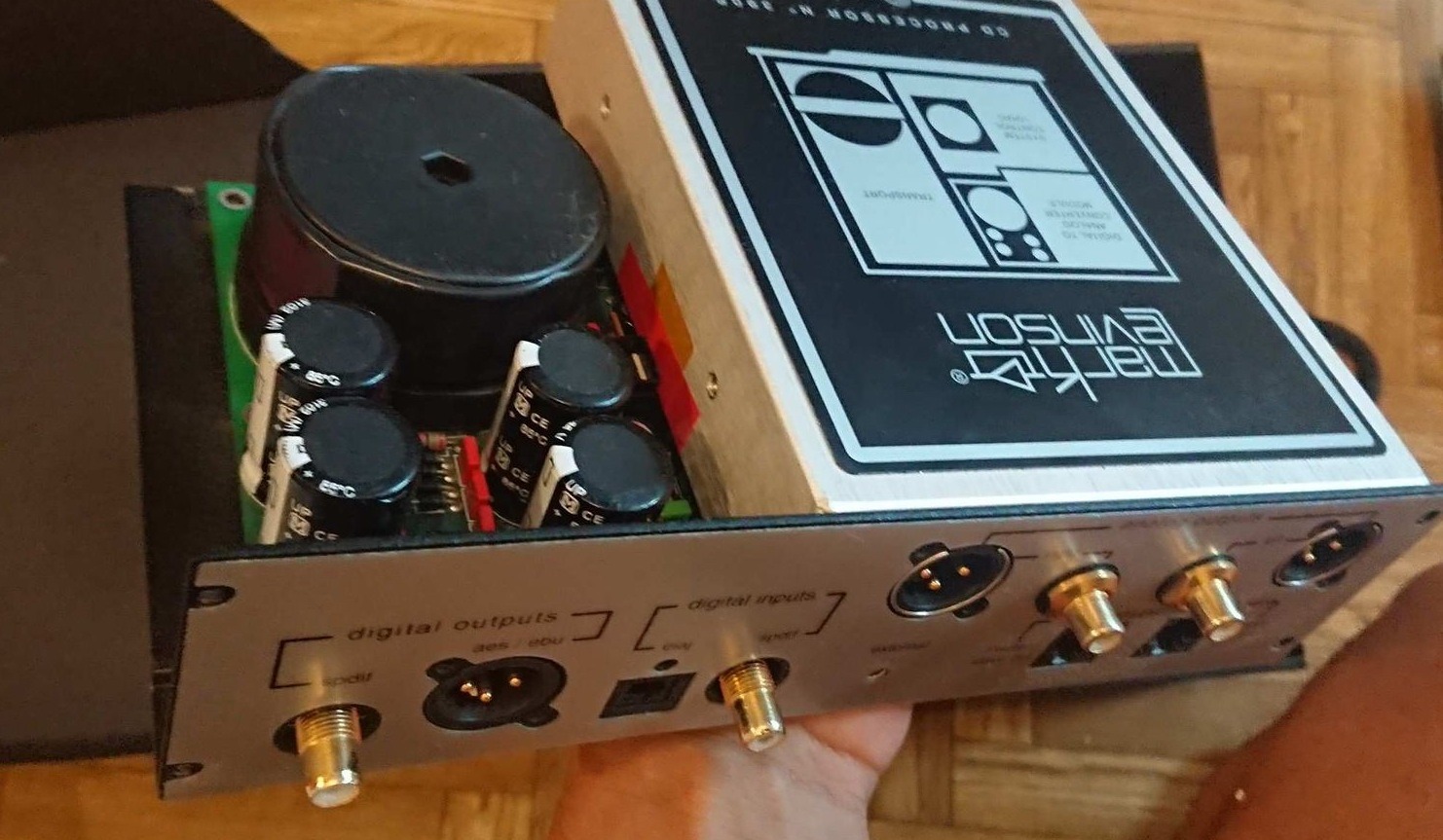

second, you contact "elviukai" in post MK 37 saying they have spares available for Mark Levinson, he will probably have some transformers for you.
He wrote to me that he has the complete dac unit available for 39.
this one in the photo.

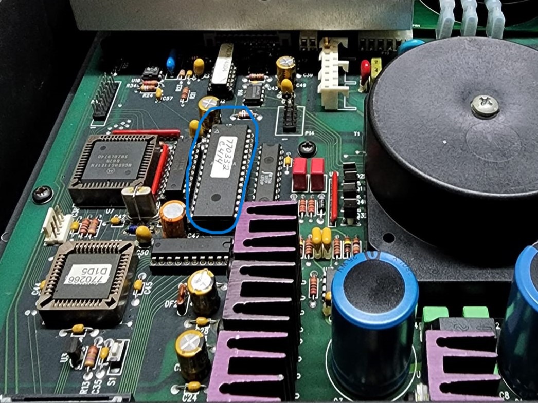

I'm looking for some advice. My No.39 boots up displaying "CODE 990E" - what does this mean?
Thanks in advance.
My local technician said the problem came from this EPROM. He has faced this problem before and tried swapping the EPROM from a good one, and it worked.
