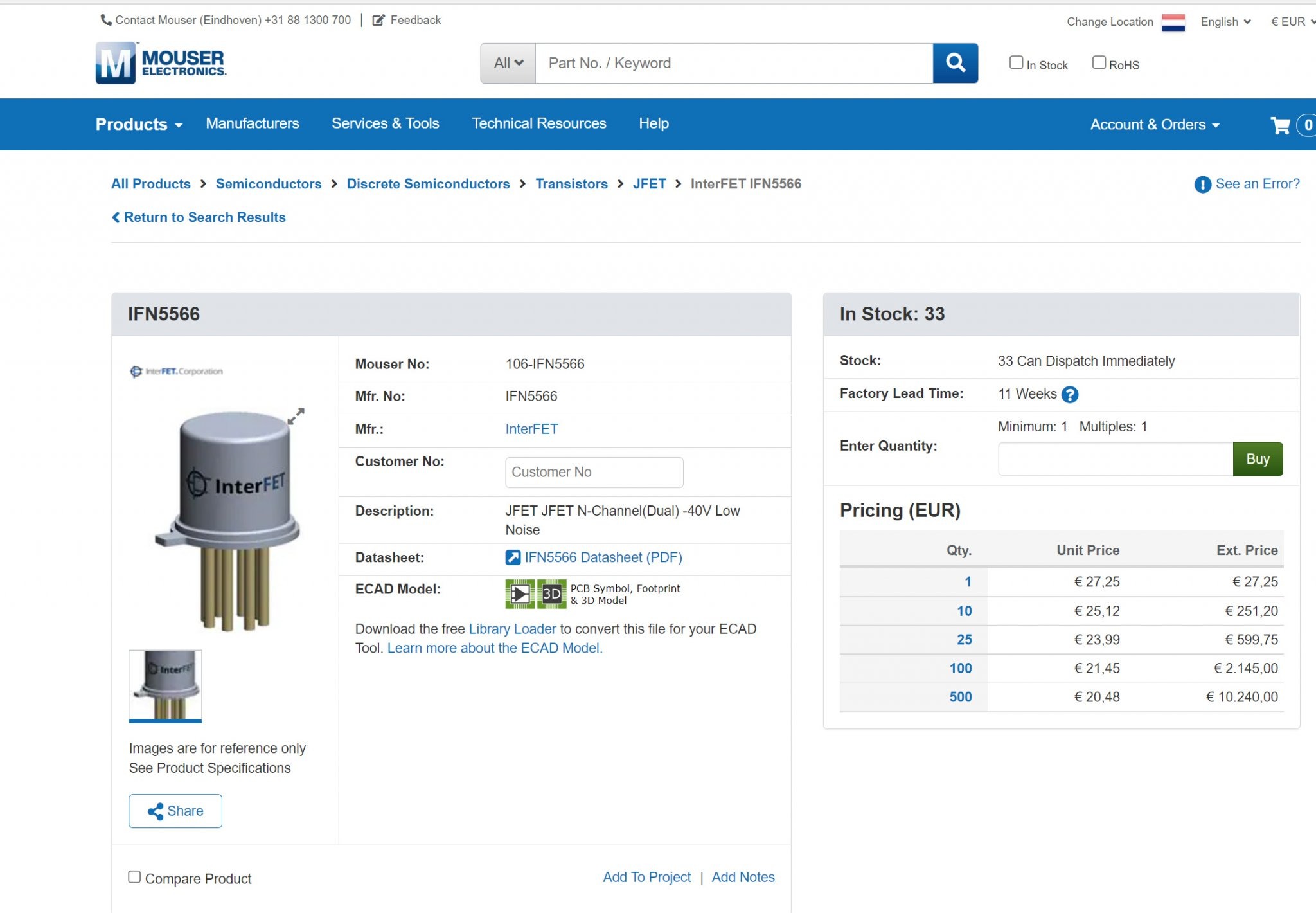

A small update. The preamp goes to a really nice engineer that change some of the transistors except the VFET that there are no longer available. The preamp came back with unfortunately the same noise issues. So probably the problem is in the right channel VFET… does anybody got any inputs about these VFET? Because probably after all these the preamp will go to eBay for sale as is. Regards!
Excuse me, what VFet are you referring to, or do you mean the dual JFet at the input.A small update. The preamp goes to a really nice engineer that change some of the transistors except the VFET that there are no longer available. The preamp came back with unfortunately the same noise issues. So probably the problem is in the right channel VFET… does anybody got any inputs about these VFET? Because probably after all these the preamp will go to eBay for sale as is. Regards!
There are excellent replacements for this dual Fet.
Hans
Yes the Jfet! What do you suggest? Regards!Excuse me, what VFet are you referring to, or do you mean the dual JFet at the input.
Hans
Really appreciate your answer🙂See below, in stock from Mouser.
Hans
