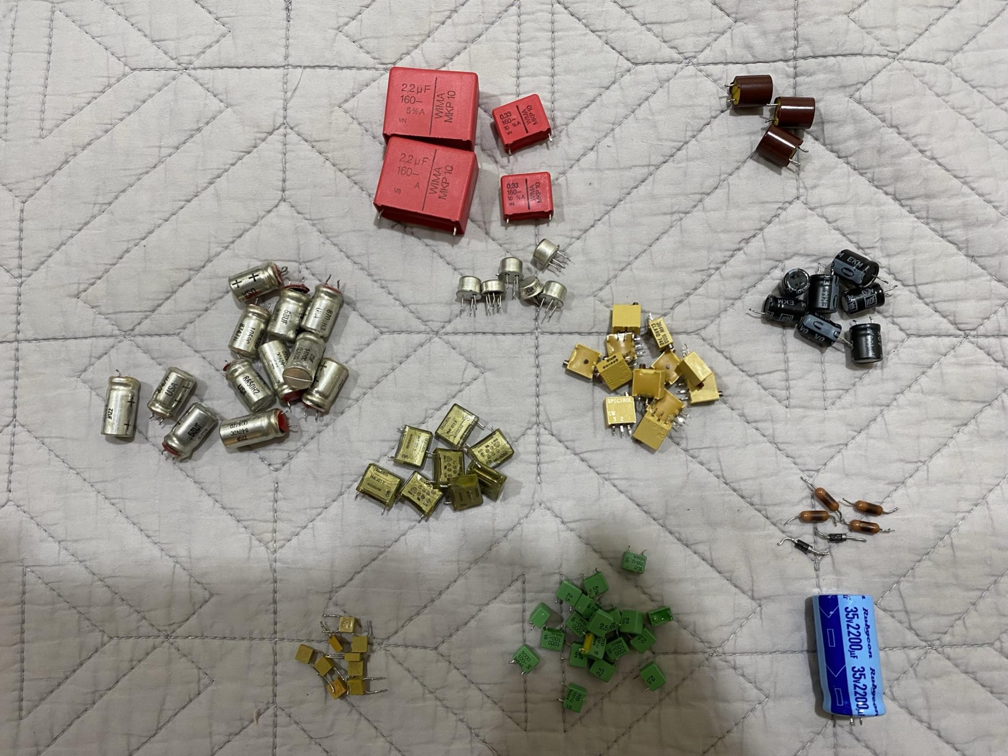

Hello ! Unfortunately my brand new used Mark levinson no.26 preamp is making this weird noise from the one channel that you will hear in the video. When i open the preamp for the first 10 minutes there is no noise at all. After these 10 minutes the noise start to get louder but after some hours the noise become lower but still noticeable. The preamp had been recaped from the previous owner - also the psu . Unfortunately he replaced also the square spargue capacitors inside. Also the toroidal power supplies don't have their covers also (but they are the original) . The noise is there even nothing is plugged on the preamp and its in both outputs (xlr and camac). Any help???ml no26 noise - YouTube

Do you think that the problem could come from the psu or inside the preamp? The psu has been recaped (including the replacement of the original square spargue capacitors with good quality but classic type ones) .
I have same problem with my Mark Levinson 26. I recapped all capacitors both channel and recapped PSU, i recapped many capacitors, replaced transistors, trimmer..v..v.. but NO WORKING. When connected cable camac or balance from ML26 to power amplifier Krell KSA 300S. it makes power amp turn off, no light power.
