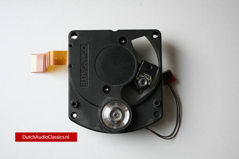

Hi George,
Just how much of that "Ind Metallic" transport is metal anyway? The sad thing is, composite materials can be more stable than a cast and milled part. Especially the cheap cast parts.
I think I've only ever seen metal CDM-4 transports (could be mistaken). The first plastic one I ran into were the CDM-9 transports.

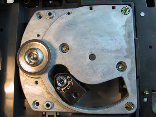

I have a CDM-4/36 in an early-1990s Philips LHH-500.
Many CDM transport variants shown here:
hifi-advice.com - Inside Classic Philips and Marantz CD players
I wouldn't take as gospel that page's list of specific transports and DACs used in a given model of CD player. My LHH-500 definitely does not have a TDA1547, for example. But the CDM pics are a good browse.
