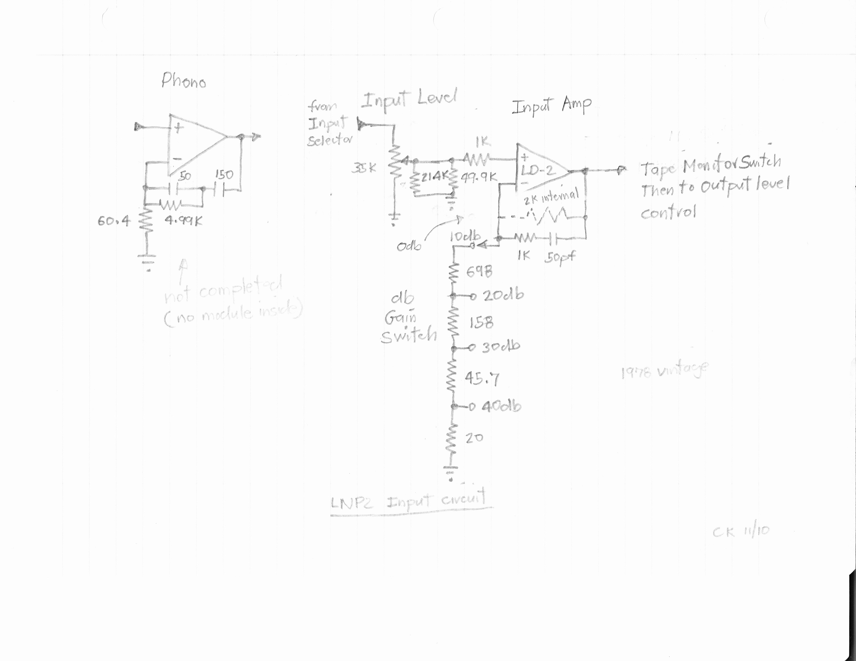

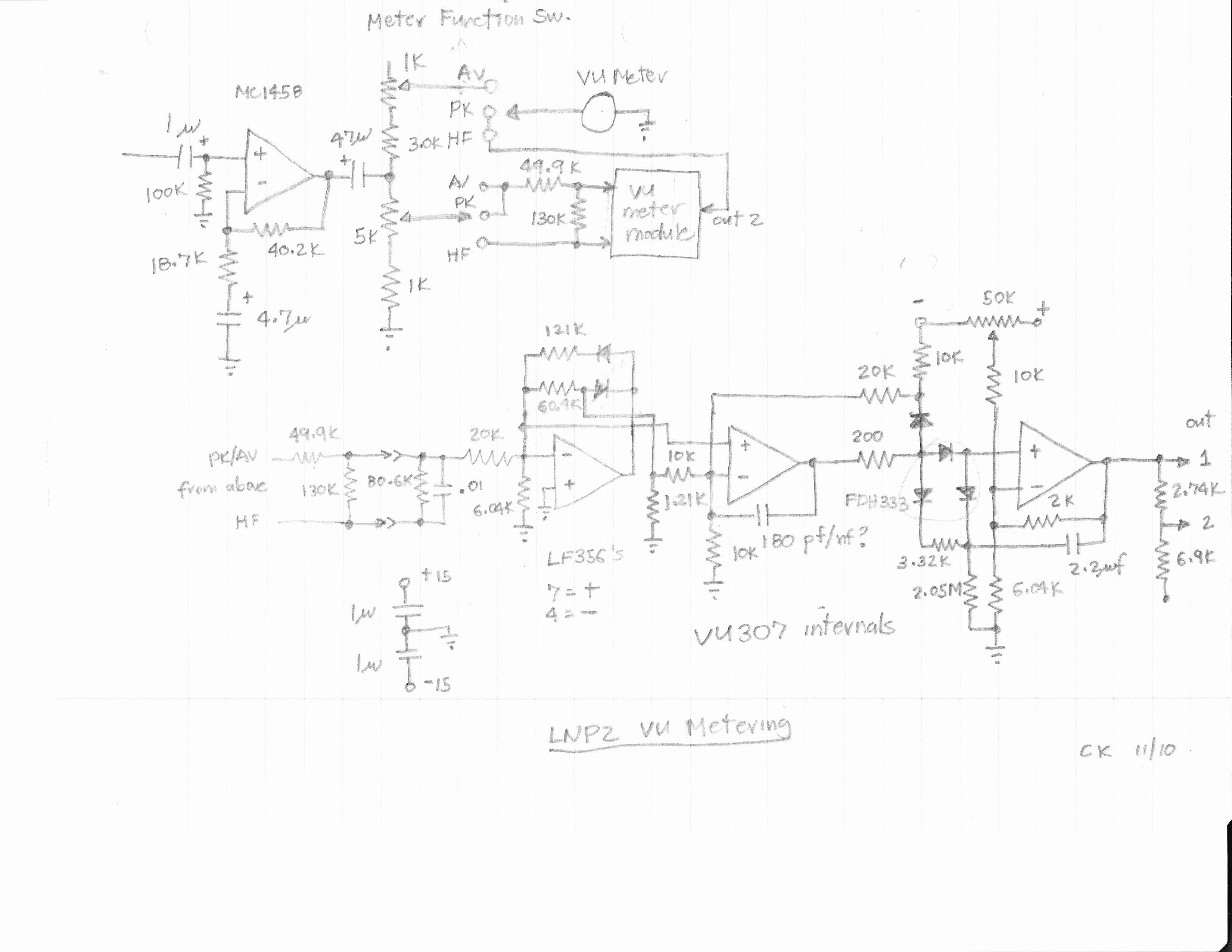

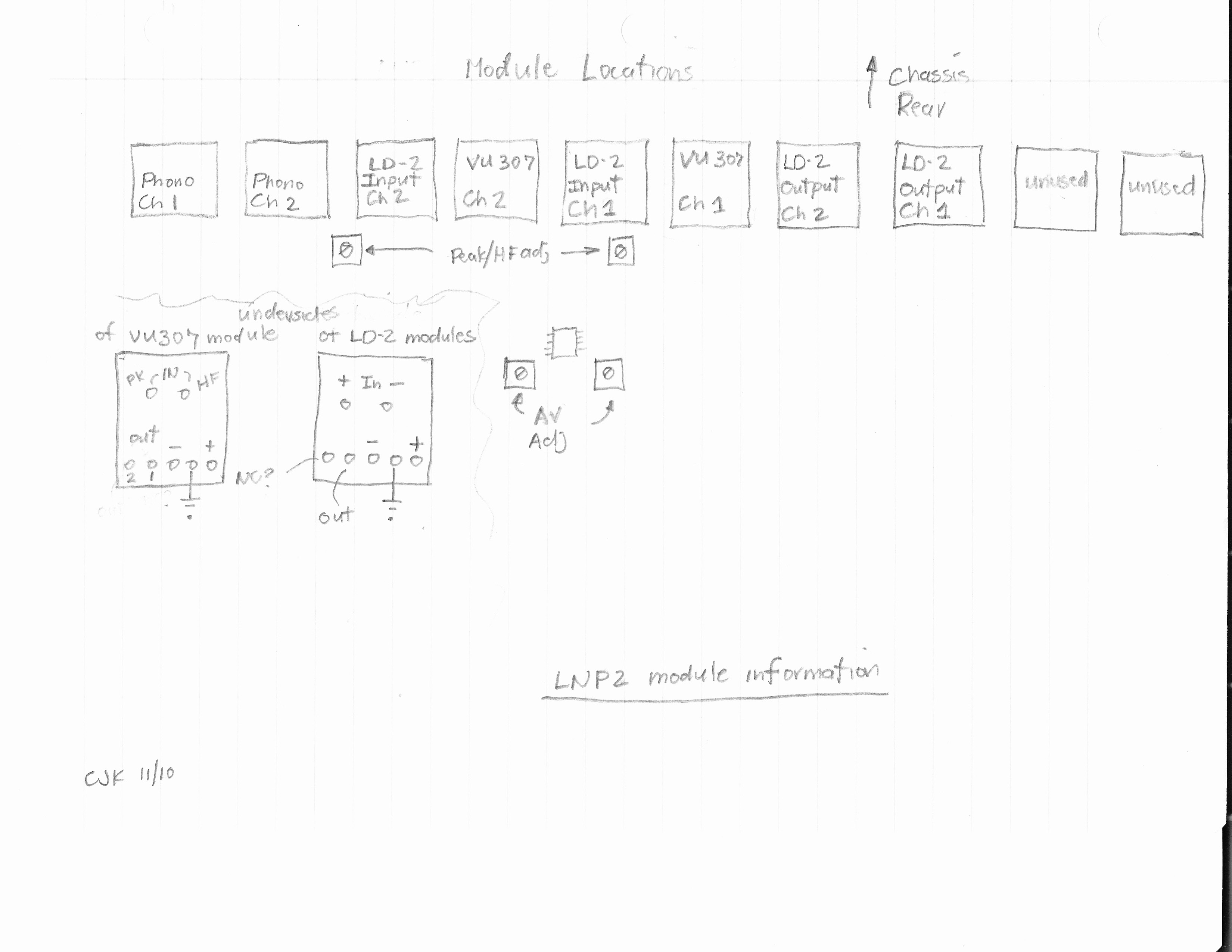

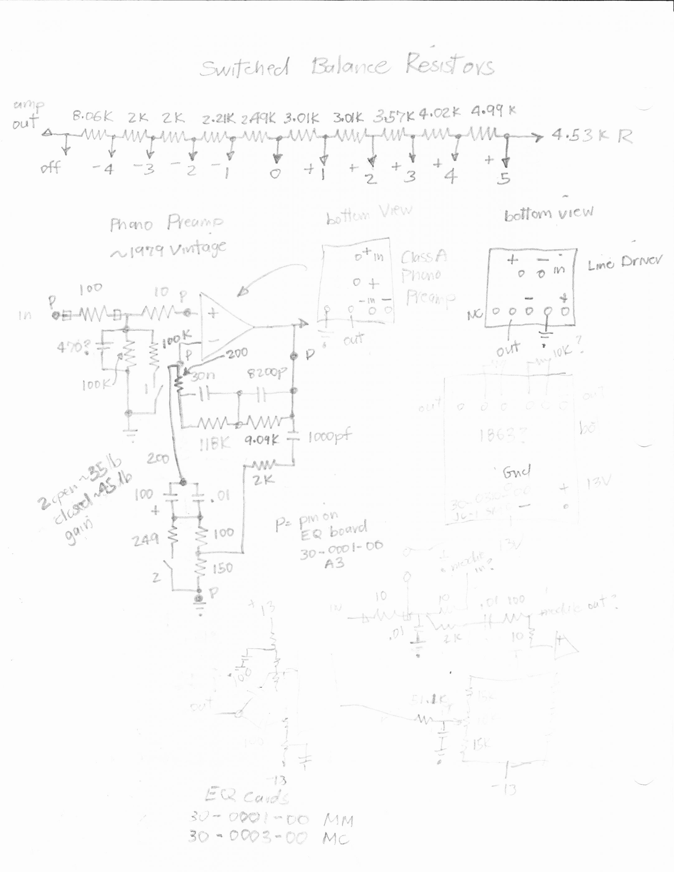

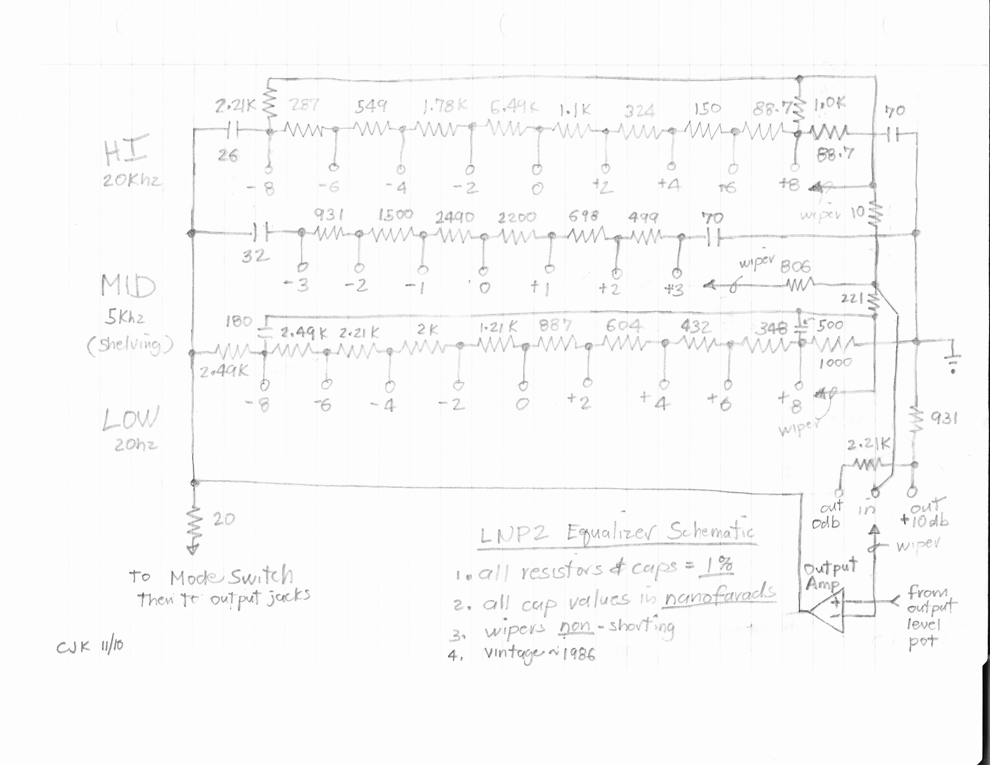

This Help?
ML made a number of "one off" variations. Also changed the equalizer section in later units.
Charles

Your picture of the units bottom shows the RIAA caps soldered under the modules. Swap the phono modules and if the problem reverses you have a bad module. Our unit had no phono modules so I came up with a two-IC plug-in replacement. Then, did get the phono working using the ML-1 RIAA feedback circuitry. I doubt that the "simple" phono circuit in your LNP (and the schematic) followed the playback curve very well.
ML did have two different amplifier modules. The LD was made for output/driver purposes and was used for the record amp module in their ML-5. The other module was for higher gain preamp circuits.
