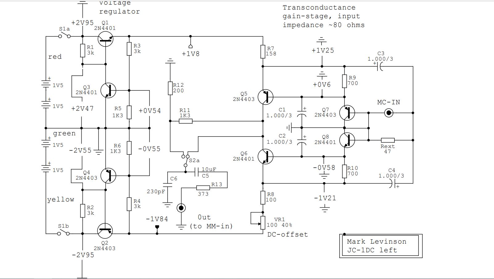

Here the circuit:
  • Mark Levinson JC-1DC.pdf

I want to know the differences (concerning circuit topology) between the modules for JC-1 - go to second picture under
https://theaudiostandard.net/thread/4790/history-mark-levinson-audio-systems
and JC-1DC which is obviously in most cases in a not potted version in use as I note in the meantime.
But I had the potted version of the JC-1DC approximately 20-25 years ago (maybe the first charge of it - manufactured in the same years and the same kind than the potted JC-1 module), which I had sanded down on the soldering side to create the circuit diagram so that the conductor tracks just appeared.
Schematics of JC-1DC which I have created at those days are to find under
https://www.diyaudio.com/community/...etween-mark-levinsons-jc-1-and-jc-1dc.243267/
I think, the mostly to find not potted PCB version use the same circuit topology.
