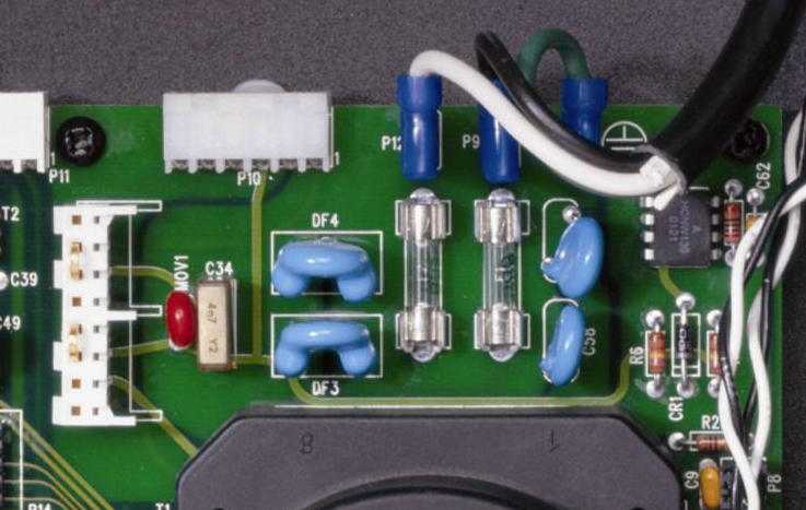

Basically, all Levinson equipment uses jumpers to set transformer primaries which are compatible with all voltages (visible on left in a picture). However, some of the equipment has also circuitry that monitors mains frequency (a chip on the right in a picture of ML390S).
In such case, even if you set primaries properly, you will get diplay message WRONG AC with a code. Apparently, when you contact Madrigal and give them that code, they will provide you with a new code which when entered through the remote will set the microchip allowing the equipment to operate with a new mains frequency (50Hz vs. 60Hz)

It was a gamble but I've bought a ML390s in the US and did the conversion myself. There was no password code and it was as simple (for someone who studied older electronics, like my father) as moving a jumper to the correct position.
If you look closely at the following picture: http://www.marklevinson.com/image_library/390SOH.jpg you'll see a white jumper block (8 positions) with copper jumpers. On the picture the jumpers are currently set at 110v (starting from the top that's (2/3 and 5/6)) and should measure something like 27 ohm between line and neutral (that's where the voltage cable goes in).
For 220v there only needs to be one jumper between 4 and 5 and this should measure around 98 ohm. For the 240v configuration one jumper should be set to 1 and 2 and should measure 109 ohm.

Hi Bebo,
Yes that simple. I really thought (reading all the stories) there was going to be a 50/60hz check. I even prepared for this and bought a Willem eprom programmer to start hacking (it's a AT29C010A 128k flash). But to my big surprise there wasn't.
