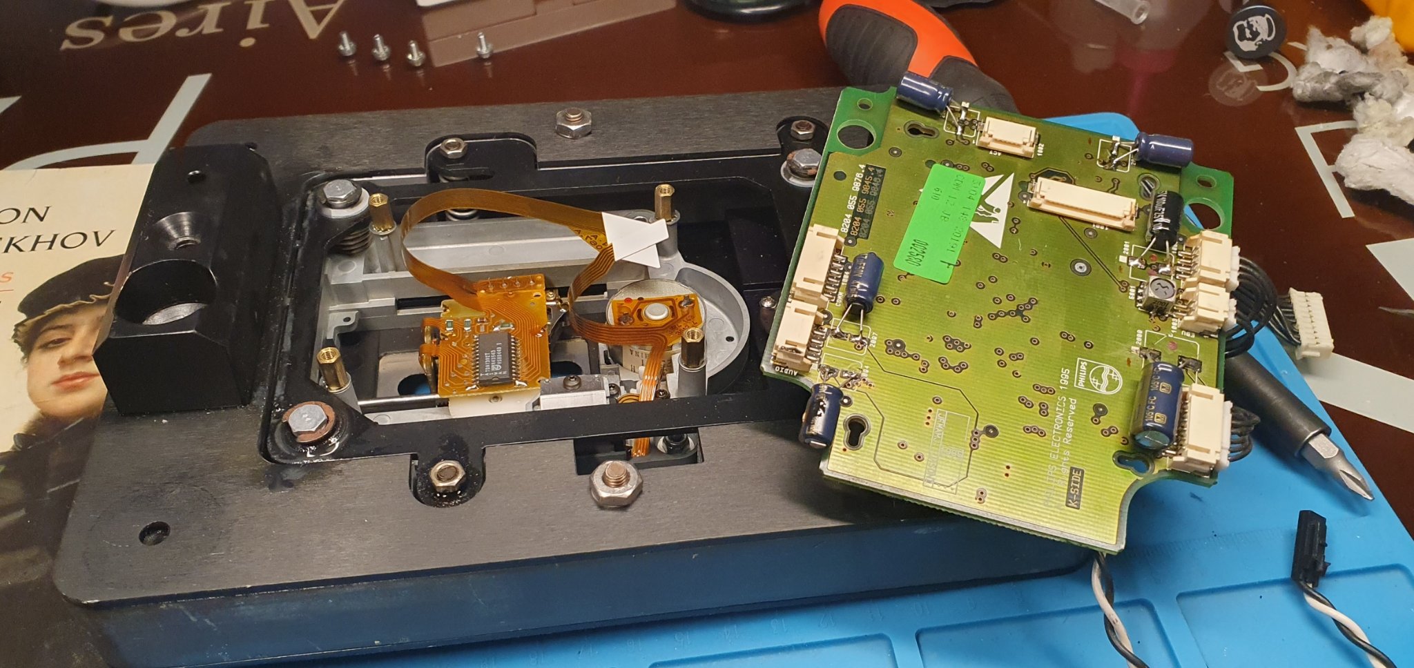

Hi RsD:
Do you still have the 31.5 with the original CDM12? Mine has the CDMpro upgrade, with an EEPROM replacement. A part is removed (marked DF80, but I don't know what it is). A jumper cable is installed, allowing the ML card to fully control the transport. I actually wanted to downgrade to see if that was the servo reset fault.
