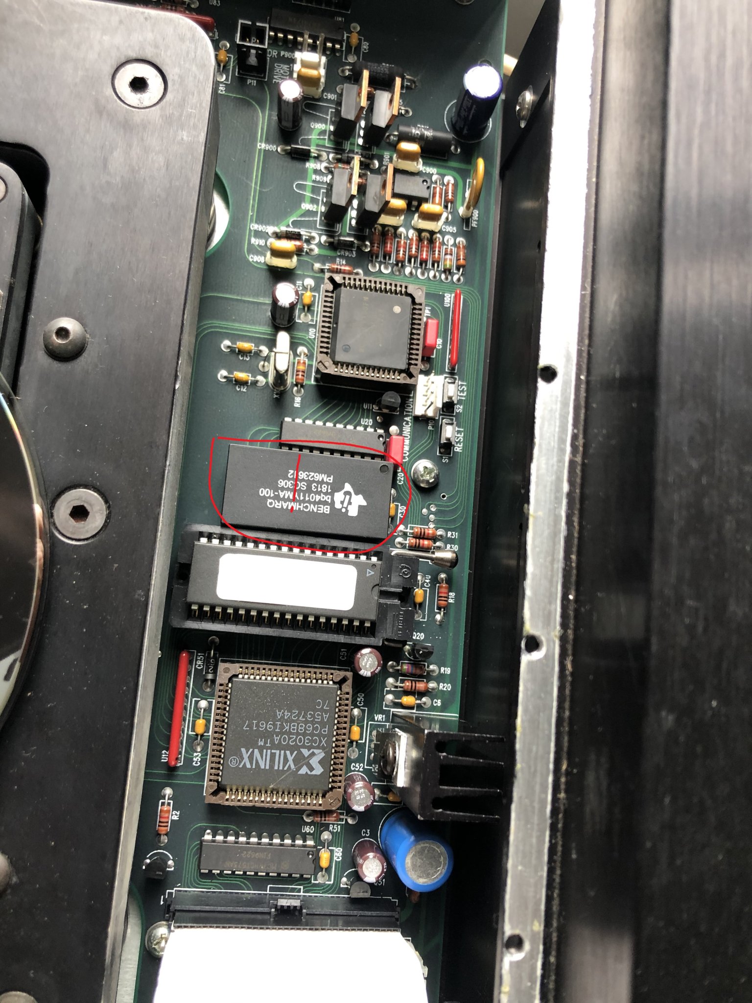

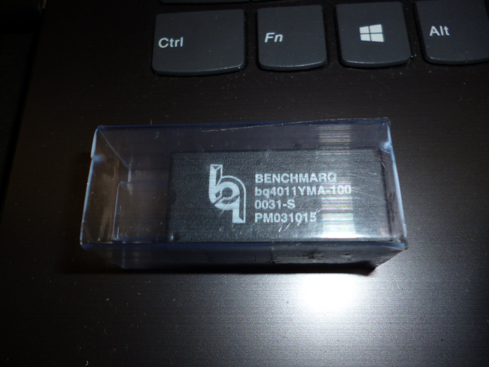

I changed Benchmarkq ram, but servo reset still be present. Someone know what type of part is NFV-610? (position df80 in levinson 31.5 board)
Was the RAM hard to find? NFV-610 is a varistor.

Thanks for your comments. It wasn't hard to get the RAM, but that didn't fix the servo error. I had some support from Levinson for a while, but they don't know much about this 31.5 either. I have done several schematics and gotten something, but without much luck. I was thinking of downgrading bypassing the 31.5 control and use the Philips transport own clock (assuming of course that it won't sound as it is configured now) to see if that transport controled by the card isn't causing the problem. (That's why I asked about the NFV-610, which is eliminated when the Philips transport is upgraded and the board is taking control of the clock, including an epromm on the other board, that I also have).
I hope to be able to activate it, since while it works for a few minutes, it sounds superior and very analogous vs all the transports that I know and have had, unlike what I have heard in audio. The difference is greater than changing a DAC, of course the better the DAC, the higher the resolution and quality in sound.

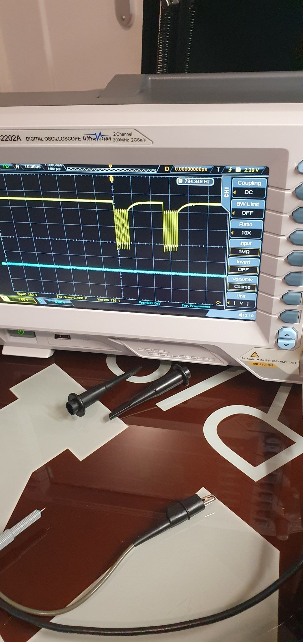

I had the same problem. Servo Reset appears on the display, and the LEDs blink quickly. If you disconnect the CD drive, nothing changes. If you disconnect the transition cable between the right and left boards, the LEDs stop blinking, but Servo Reset does not disappear. The right board, I'm sure, works; it's responsible for communication and the display. Perhaps this will give you some ideas. Has anyone had any experience with this problem?
The IC bq4011yma-100 is a static memory (SRAM) and has no software in it. Any other ideas? Very interesting to understand. Today I checked the communication between the left and right halves. There is communication, but the same thing is transmitted, which is not surprising. And also has a strange look to the output of the IC XC3030A.
