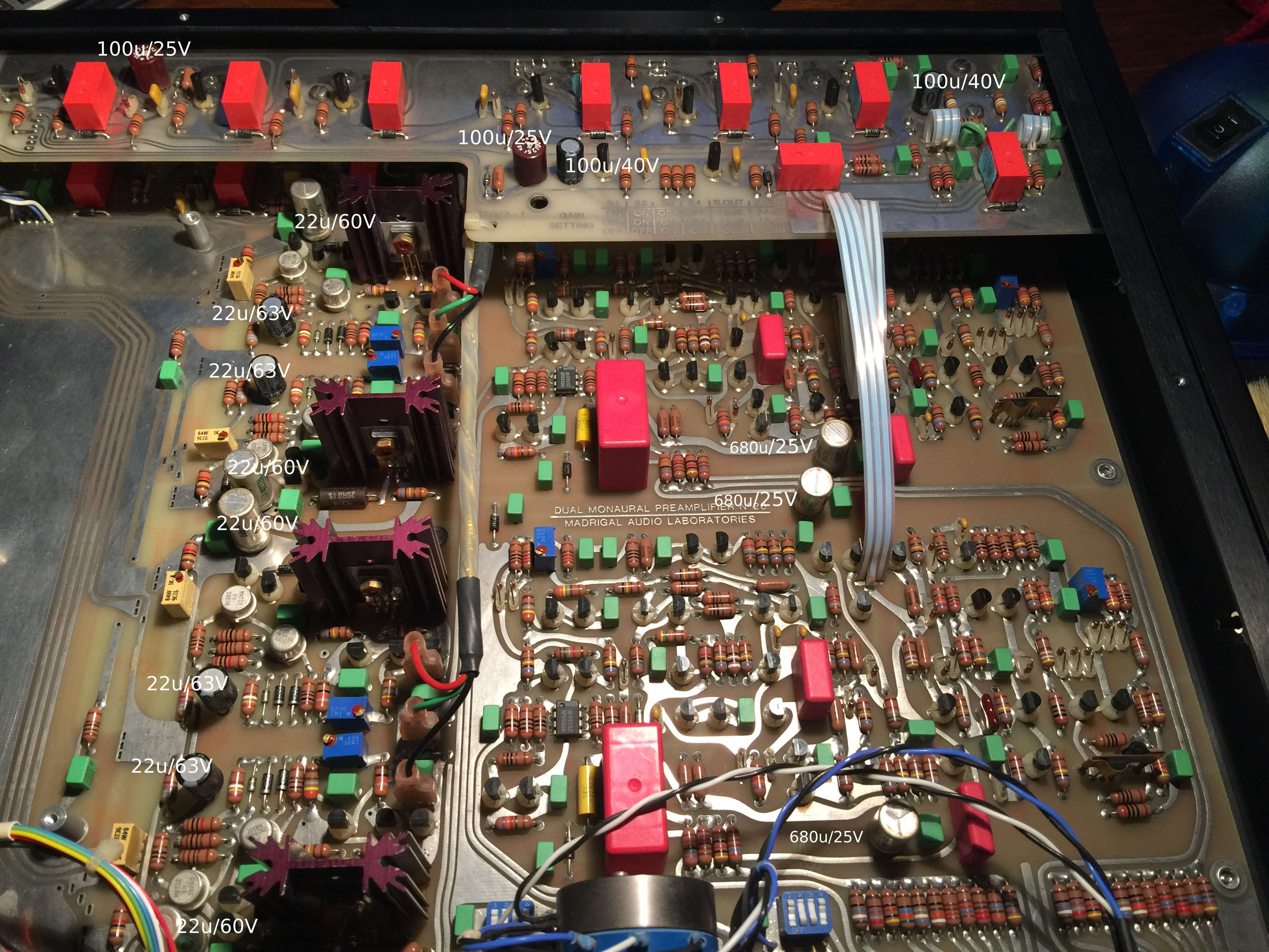

mmm, a close up photo would help, the only brown cap in mine that is next to a 100uF cap is also a 100uF/25V elco (located in the middle of the upper PCB)

Ty for your pic. It seems mine were changed out but not for 100 uf either
To buy used is always a gamble it works fine but not correct caps. Great lol.
So now it's good I bought a bunch of 100 uf 50 volts caps low esr now how do I know Asside from the brown ones are 100 uf too.
Anyway you or anybody can post a pic and hi light the 100 uf caps.
What was Changed May not be all correct value. Also want to change our main psu caps too. Can't find nothing like them. And ty for the link from someone who did pic a sub.
Ty in advance

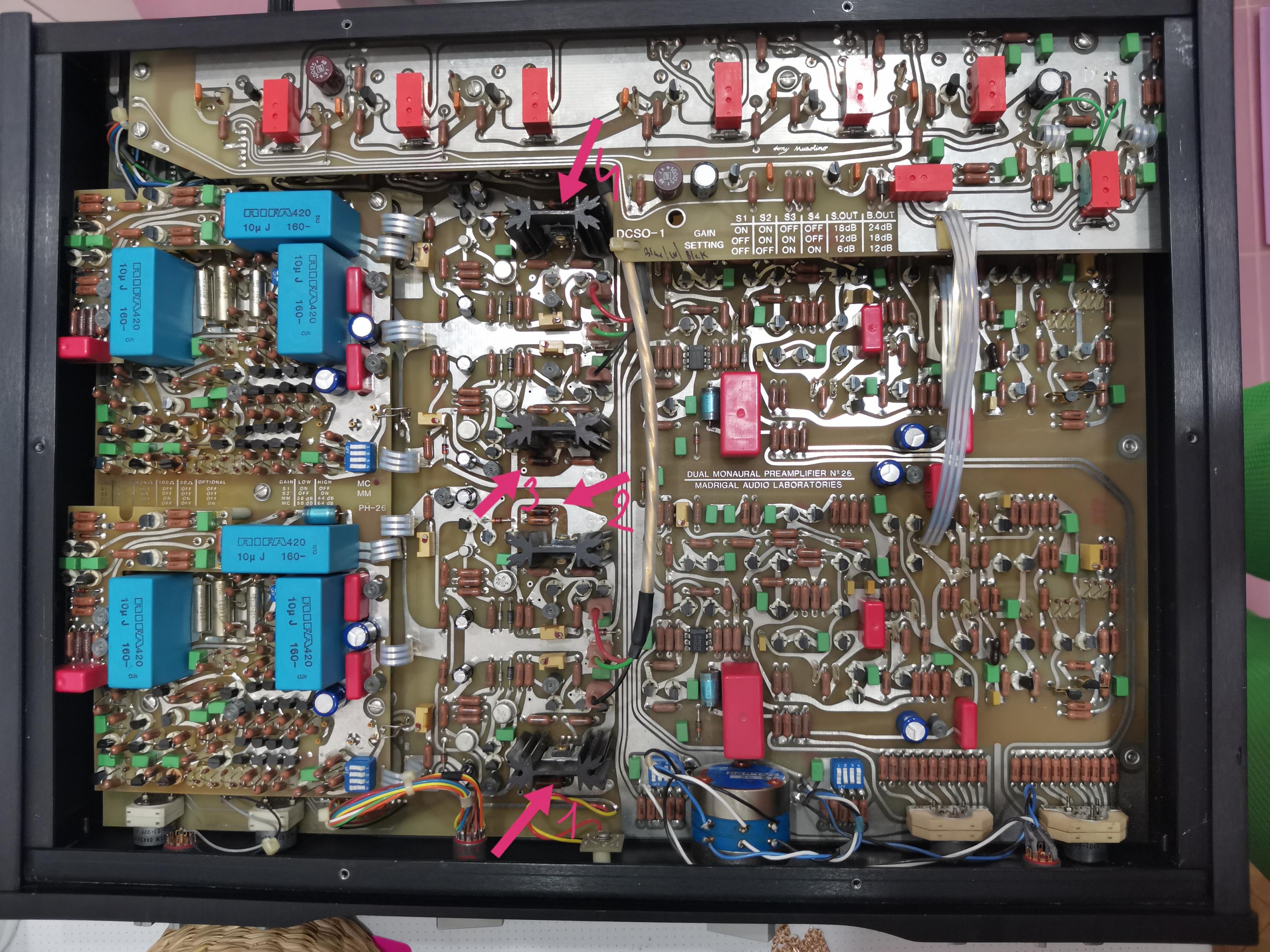

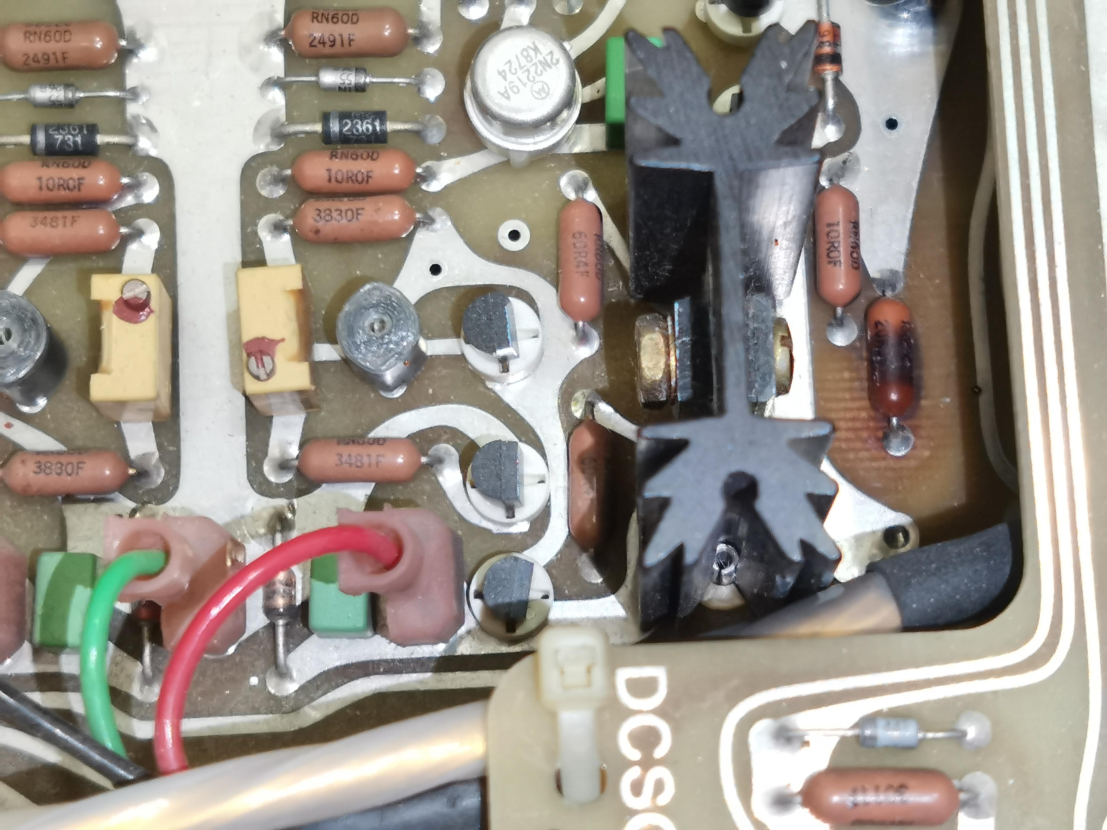

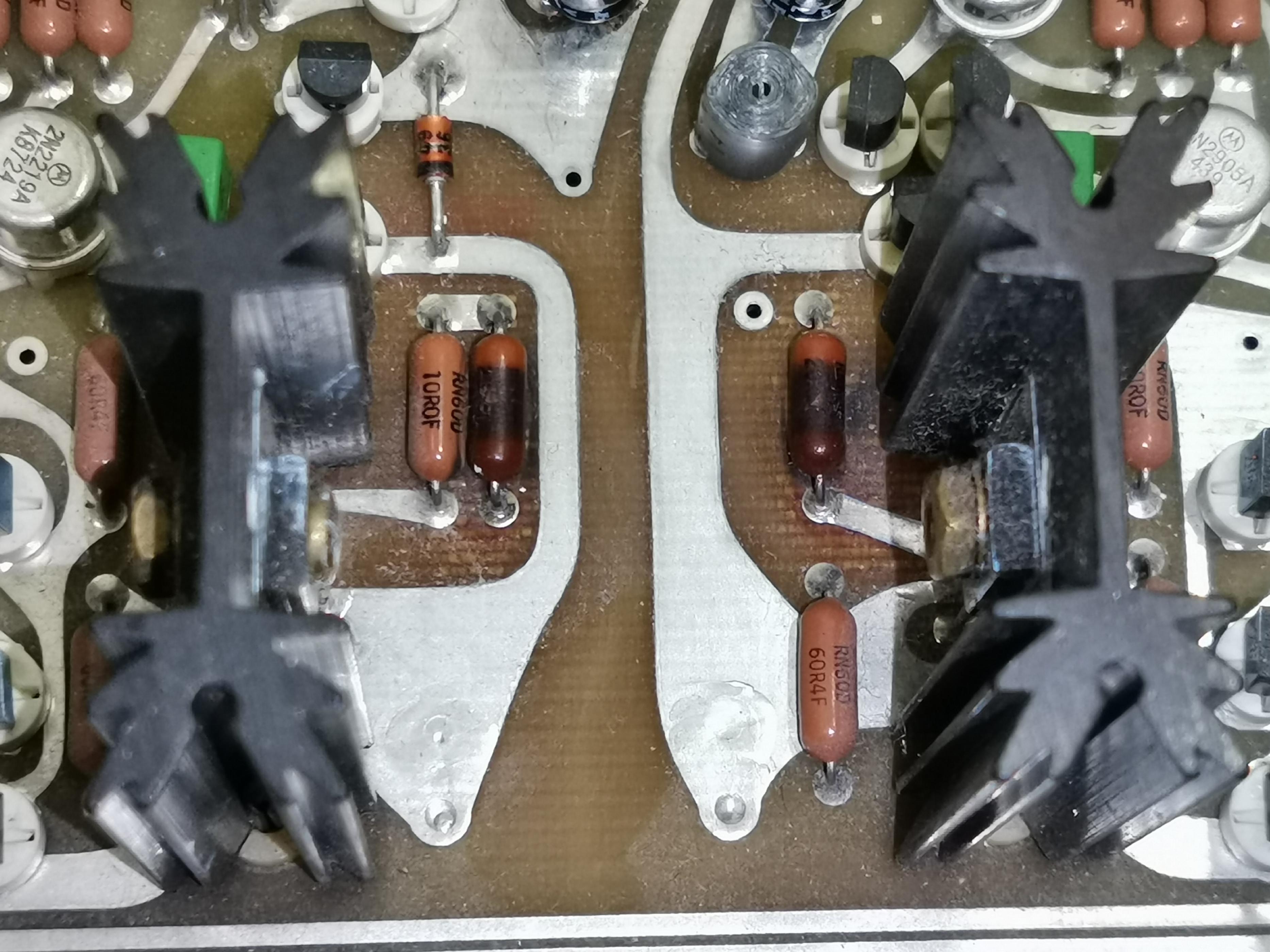

Hello! I really need your help! My Mark levinson no 26 burned out resistors. In the photo I highlighted them with arrows and numbered. They are charred and markings are not visible on them, please help identify them. And I also noticed that in the last photo they are different from mine, in the photo they are large and dark.

They seem to be the 20R emitter resistors between the output transistors.
No idea what quiescent current is running at rest, but since all four are burned, I would replace them by 1Watt versions.

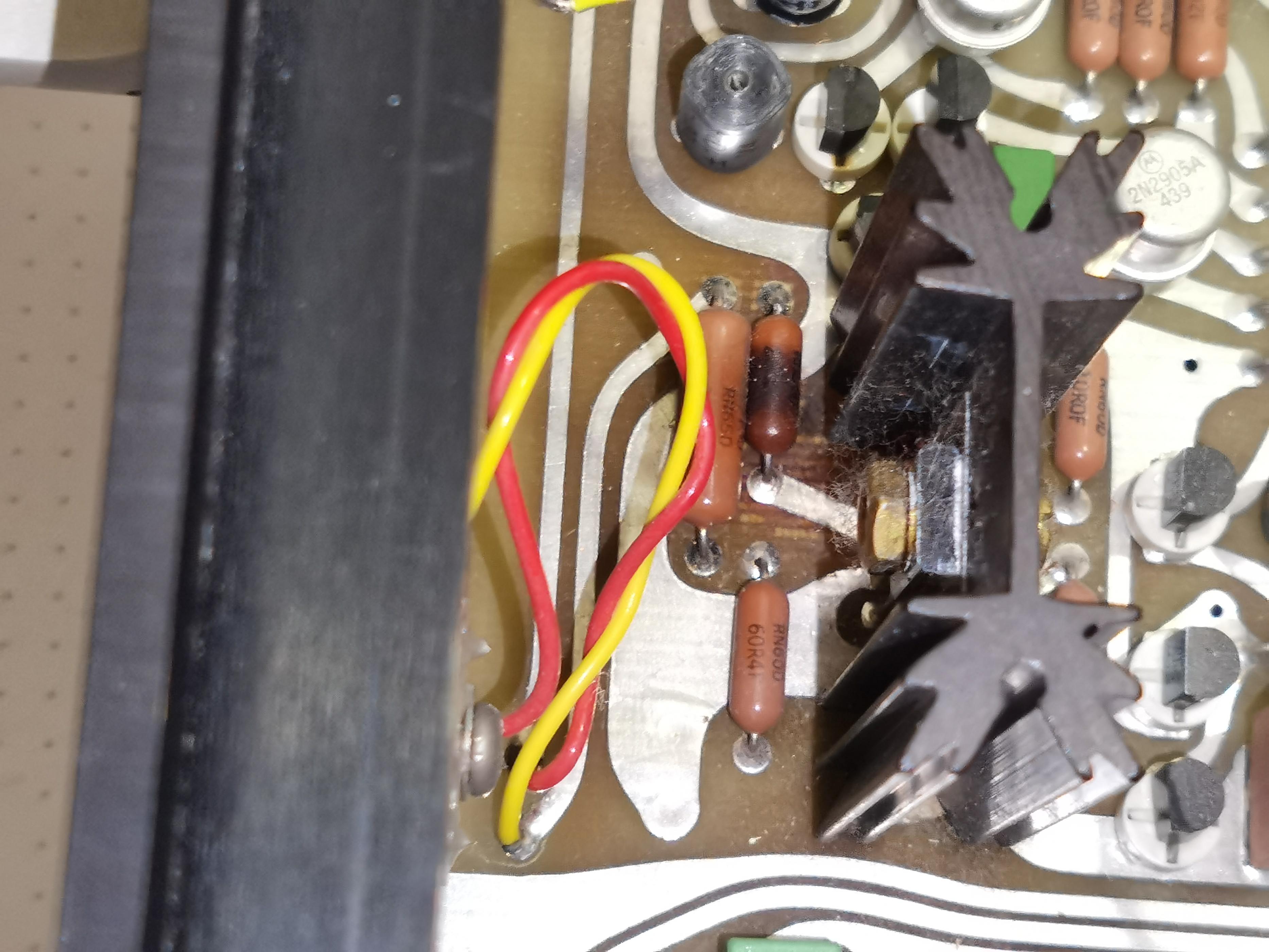

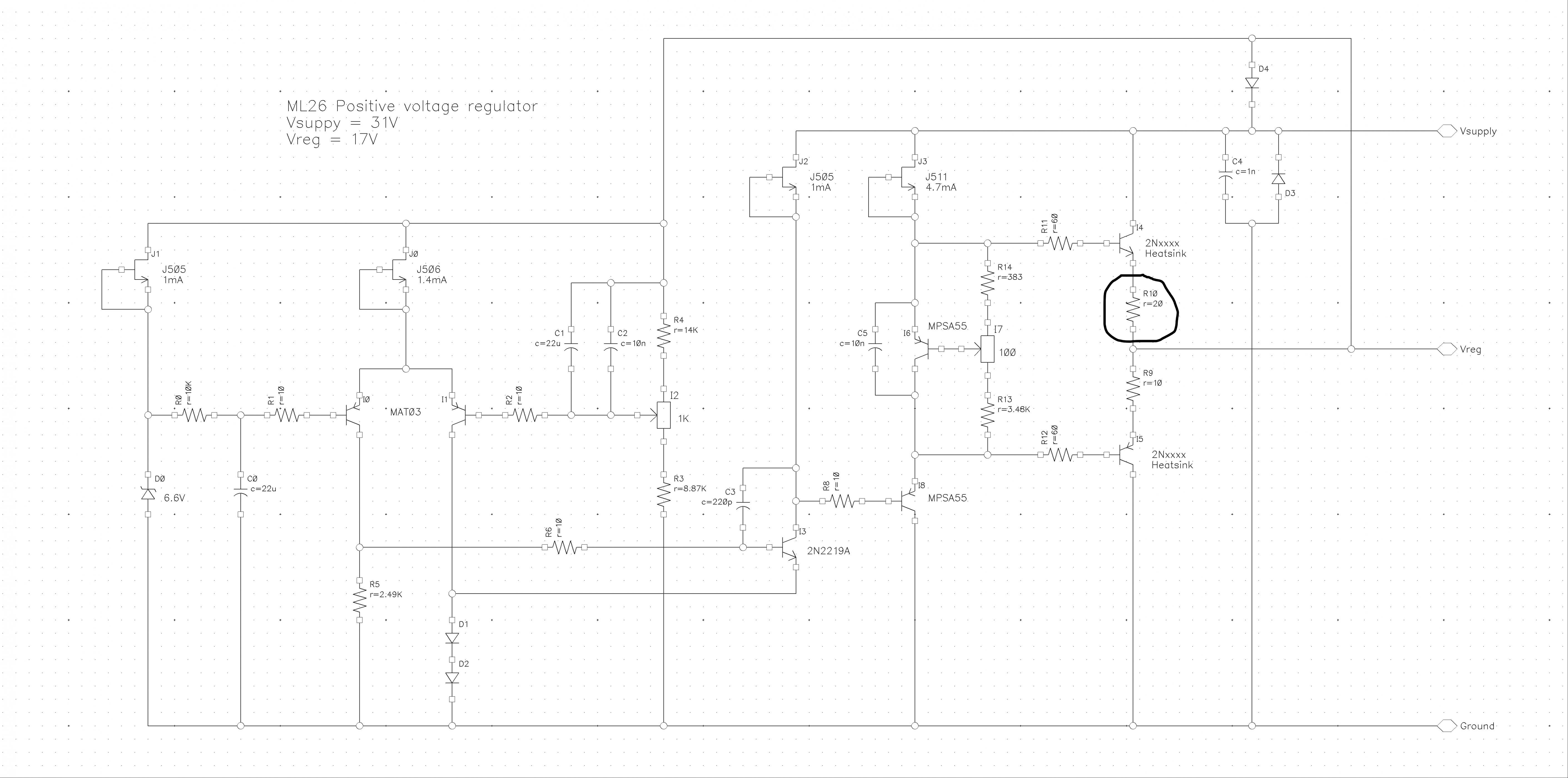

Good morning everyone. I haven't visited here for a long time, but I have to ask for help because I don't know what to do.
In my ML 26 .I saw smoke from a R10 - 20ohm resistor /positive voltage regulator/. I don't want to do something wrong, so please about a hint what to check and what could be the reason for it. Thank`s.
