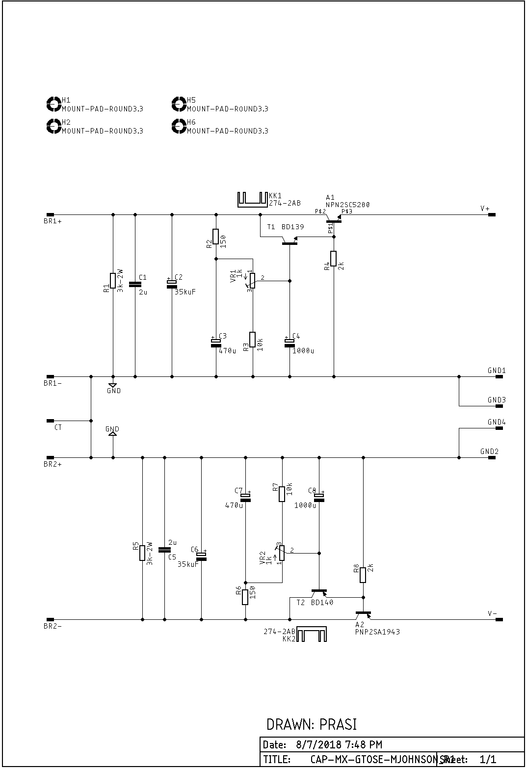

This is a capacitance multiplier designed by Mark Johnson and Gtose. It was first discussed on the Juma’s Easy Peasy Capacitance Multiplier thread. I have created a dedicated thread for it here to reduce confusion as folks have been posting questions about it on the other thread.
A big thanks to @Mark Johnson , @gtose , and @prasi for making this available to the DIY community.
The layout was done by Prasi and details and Gerbers here:
https://www.diyaudio.com/forums/pow...peasy-capacitance-multiplier-post5510507.html
The BOM is here:
https://www.diyaudio.com/forums/pow...peasy-capacitance-multiplier-post6161883.html
Schematic:

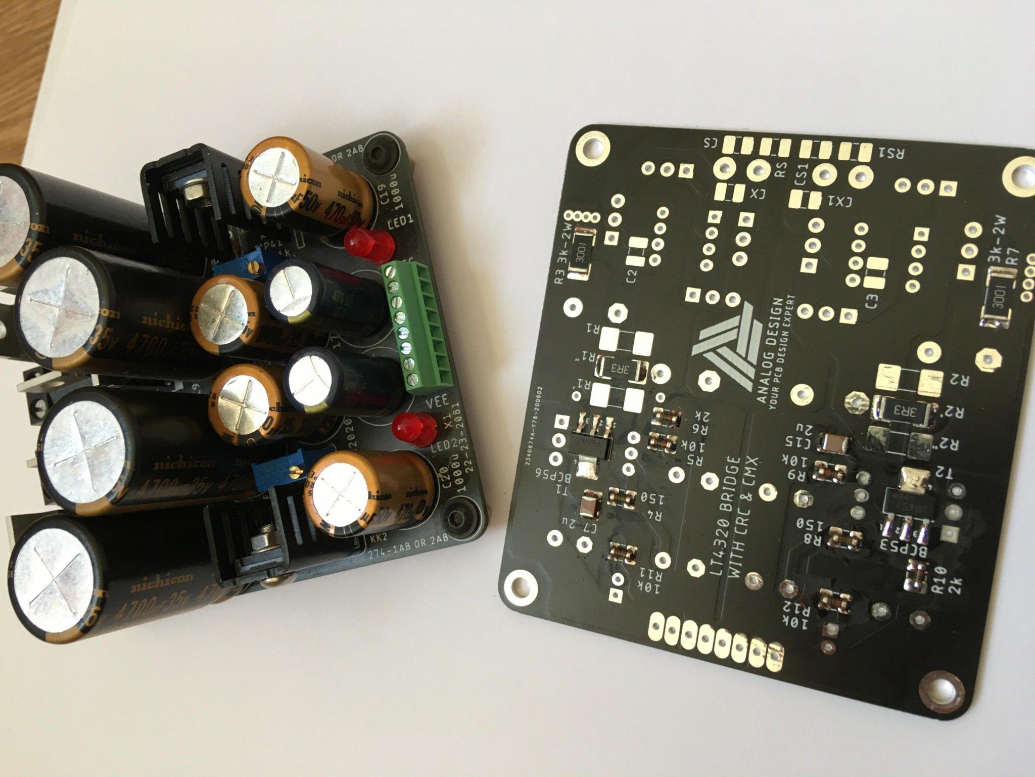

Assembled PCBA example of later variant with active bridge by @passive420:
