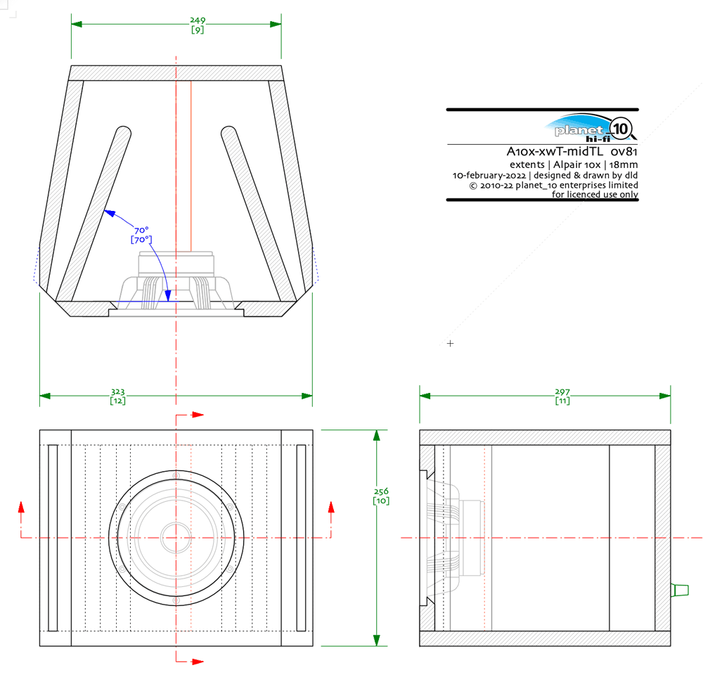

OK, adding a woofer sounds like lot more complexity. For now, I will stick to building Pencil and see how it goes, as it should be straight forward build. If later on woofer is needed, I will venture out in the wild.
Thank you all for your help. Now, waiting on the A10p to arrive.
The pensils i've build (for others) did not need a sub, but those were with the 10.3 and the 11MS. But as the 10P is on the low end almost the same as the 10.3 i guess a sub will be only needed for very bass depending music or HT or for high volume.
