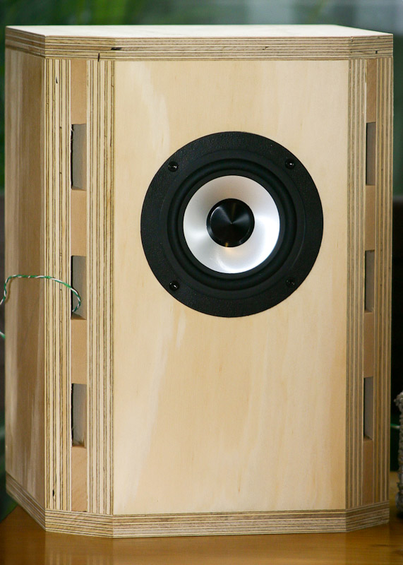

At long last, I've gotten around to plugging in my camera and grabbing this higher resolution picture of my dMar-Ken70
attachment.php
Hopefully this week will see these properly sealed, stained and finished.
Almost didn't have enough wood to finish them. Here they are all sanded after some wood filler and roundovers. Paint will come soon.
I was actually able to get the cutout for the drivers so exact that it could, in theory, work as a press fit. I wont use it that way but its nice to know that they'll be getting extra support on the flange rather than just the four small screws.
