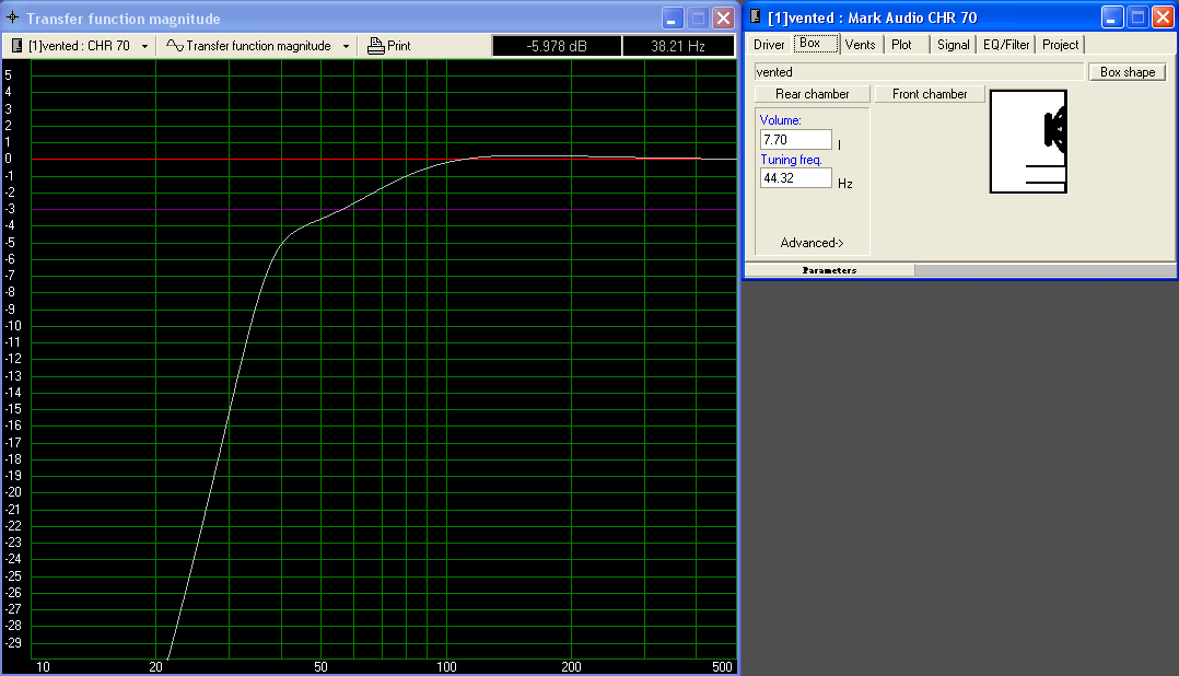

But I'm sure it must be quite bass light? I remember using a Monacor SPH-30X in a ported box though (-6dB @ 72Hz, same as CHR-70 in sealed but with faster ported rolloff) and it giving a suprisingly full sound, so perhaps not? The hump in the response from using the CHR-70 in a smaller box is very minimal, is the capacitor really needed? I can't model its exact effect in WinISD. Nice to use a single polarity amplifier design with though!
It seems it could also squeeze into a fairly small ported box (7.7L) with a lower tuning point to give something of an EBS alignment (attached). The small hump from 100-200Hz shouldn't be an issue as the driver response around here is weaker compared to the 200-500Hz region. Still quite a large box though.

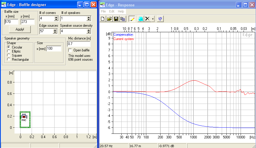

A rectangular baffle can give a reasonably flat response with the driver carefully located (attached). The lift at 1KHz is broader than one would like (a high Q lift here would help balance the response nicely), but shouldn't upset it overall.
Any thoughts? Just throwing some ideas out while I consider these drivers!
