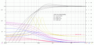

Sealed box is also an option, thanks for the input. Come to think of it, ported / vented designs usually enhance the low end performance and in this specific application, that won't be needed. So striving for a more linear output is actually a good idea. Which design would you recommend, then, Dave? This looks solid to me: mMarS-1v0. It is about 5.6 liters of volume. I am gonna try some simple simulations as well.
+1 for the sealed box.
You will get the best impulse response possible and you will have the easiest build possible. Best solution if you do not need to extend the bass!
Looking at the sims, you'd likely want to target Q=0.707. About 7 litres with no damping, 5.5-6.5 litre with damping would suit.
dave
Guys, what's the name of the software planet10 used to simulate the frequency response? Here's the image he posted up in his previous post:
it seems that the internet only knows about WinSpeakerz. was there an older version for Mac that can no longer be found?

John Murphy's MacSpeakerz.
dave
Last Mac version was in 1999. I keep a Twin G5 PowerMac around to run it & an html editor under Classic (and be a music server for my office).
