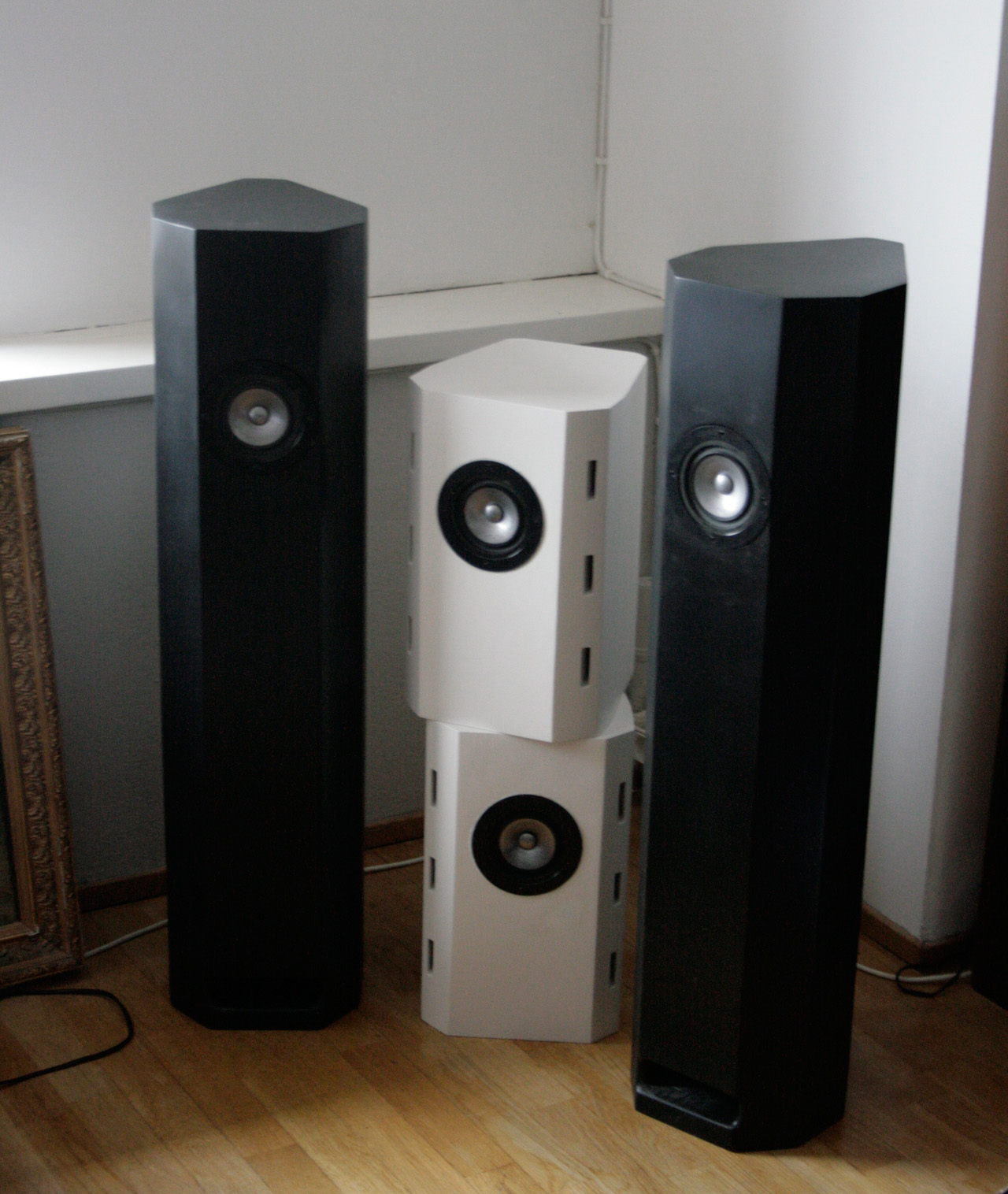

Bob Brines has an ML-TL and there are the Woden Design horns. If you are mentioning the FH3 then the Alpair 7.3? Bob doesn't have an ML-TL for these, the Woden Design Horn is Mashowe (it is not compact thou).

FH3 was designed to use a corner or a wall behind to extend the mouth size.

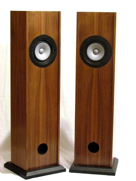

One of the design goals for the Pensil was simple. Note that the optional holey brace can be as much work as the entire rest of the box.

FH3 shouldn't need all that much space behind it (ditto for Maeshowe) since they use boundary loading. A bit, yes, but we're not talking yards by any means.
You can glitz up the cosmetics of the pensils if you feel they look boring. Or I could do you a one-off cabinet, depending on what it is you want. The criteria you mention above isn't too much of an issue, but aesthetics are of course a matter of individual taste, so some further detail wouldn't go amiss.

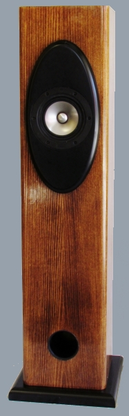

As here (with Mar-Ken)

Of the Alpair drivers, I'd be included to suggest either the 7.3 pr 10P in Pensil / MLTL style enclosure - for simplicity of build- and as Dr Moose, who draws a lot more designs than he's able to build has noted 😉, you can tart up the aesthetics as much as you like. . The 7.3 could still benefit from high-passing and woofers, the 10P I think would suffice without. Certainly does in the FHXL -FH3's big brother.
