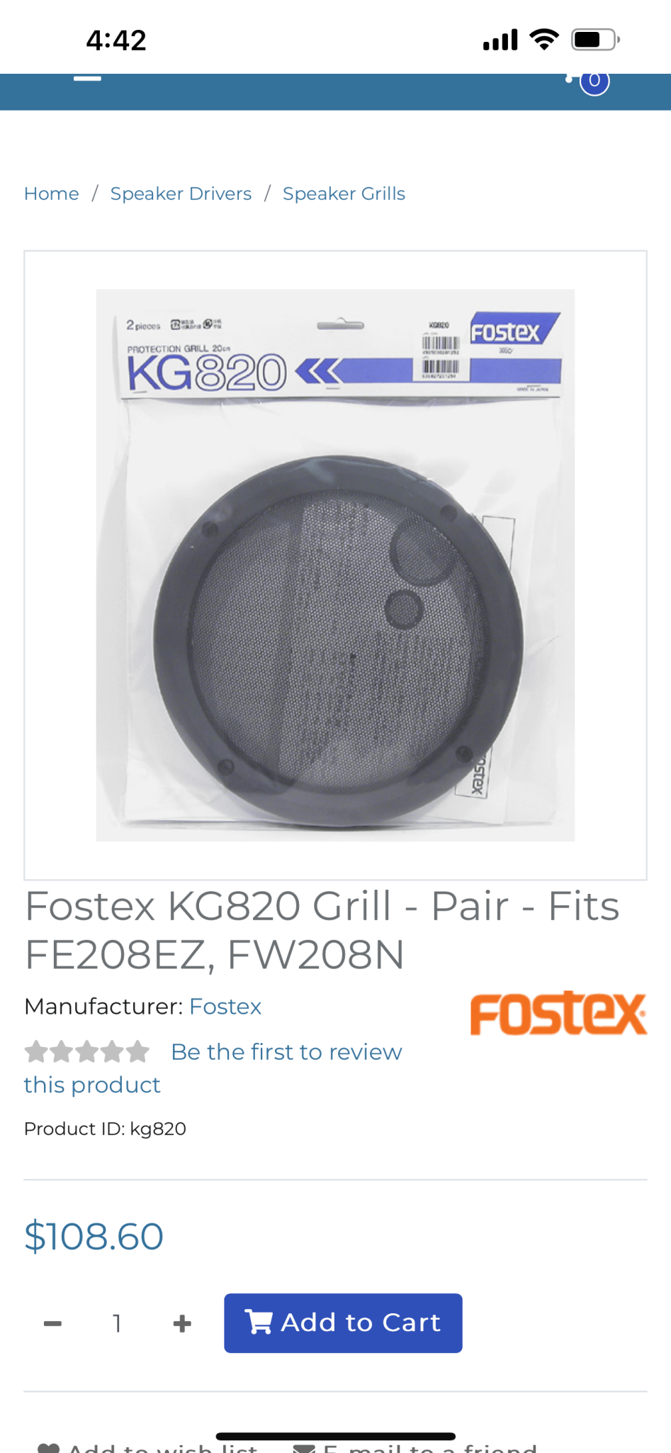

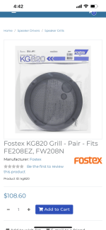

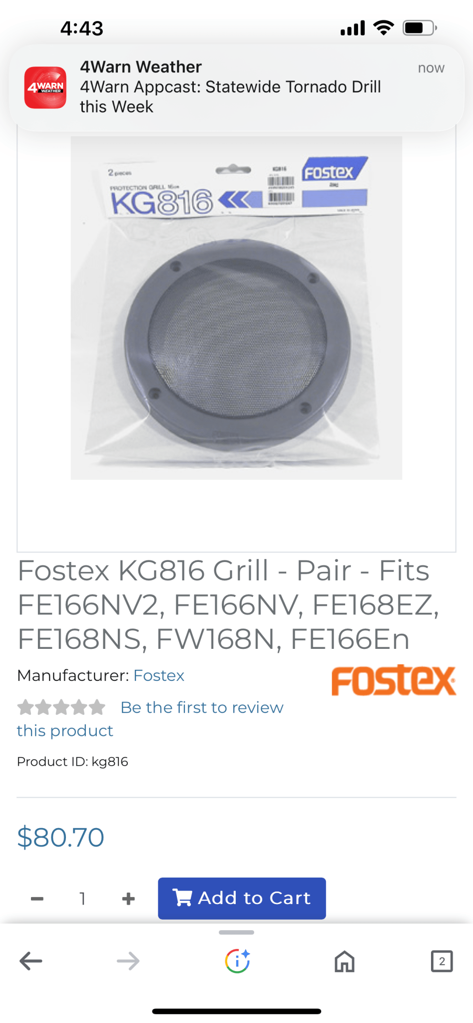

So Madisound still sells fostex grills. Here are the 2 grills I would pick from them if the size is right for over the Alpair 10P drivers. You can also buy grill cloth from Madisound and make your owe to if you like?
Thanks, I was thinking on similar lines and maybe attaching small magnets to line up with the screws to make the grills removeable instead of permanently attaching them. I had a pair of Fostex Grills many years ago for FE127's and they attached via longer replacement screws through the driver screw holes, ugly but a great defence against small inquisitive hands at the time.
