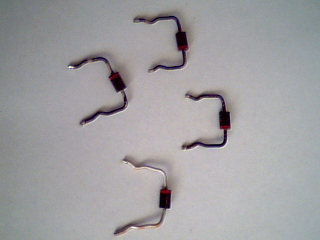

Thanks mate! Your advice did the trick,I followed the circuit and found a shorted diode in the power supply that I had replaced before thinking it was blown originally when I got the receiver ,so I looked a bit further and found that when I recapped it I have used a 470uf cap instead of a 330uf cap.Duh! I have ordered the cap and should get it in a week or two,I live in regional Western Australia and it comes from Eastern Australia.I would say that this would be the problem ay?
The shorted diode will be the problem.

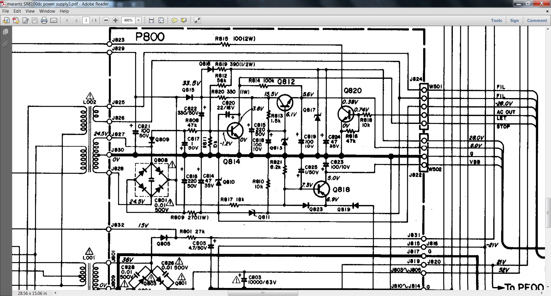

The right hand side of R818 measures 0.6v,that's when I plug the cord in and the transformer starts to hum,so I set the DMM to diode setting and touch the left hand side of R818 with the probe to turn it on.It turns on the amplifier but not the functions? Q820=B,0.06v,C,12.0v E,000v, when turned on.

OK, so you are using the diode check voltage and current to turn on Q818 and in doing that it operates the relay correctly.
So from what you say it is sounding like there is a problem with/or/something stopping the correct voltages to "unmute" and to enable all the functions.
Without a full circuit its impossible to say what is going on tbh. The thing to do is concentrate on one problem.
No base drive to Q820. So you need to see what drives resistor R818 and what conditions are required for that drive. For example is it fed direct of the u-processor or off more discrete circuitry ?
The base is driven from the MSU to the left side of R818, it measures 1.7v and 0.06v on the right side! Is there any way I can send you the SM and /or schematics.If not I have uploaded them to AKs digital docs. I'm OK with analog stuff but this digital throws me when it comes to troubleshoot it.I appreciate your patience and any help you can give me.

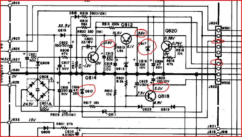

Before doing anything remove all power and remove the backup batteries. Confirm the voltage across C823 (Q818 Emitter) is zero. If not apply a temporary short to discharge it. Remove short.
With it powered up.
1. We need to confirm the 5.6 volt rail by measuring the voltage at Q812 emitter.
2. What is the voltage at Q818 collector. This should be at 5 volts whether plugged in or not if the backup batteries are fitted.
3. What is the voltage on pin 19 of Q501 (The micro) This pin powers two (or three if they are all physically separate) relays that provide AC power to the main transformer and the switched AC outlet on the back.
4. Q814 appears to be used to detect AC power. What is the collector voltage when plugged in.
5. Is the display lit ? Are the +28 and -28 volt rails correct. All these voltage are on the connectors W501 and W502.

I shorted C823, then measured Q818, it reads zero on its emitter with all power off including batteries. When powered up, it measures (Q812, E,-5.6v.) (Q818, C, 5v.) (Q814, C, 4.8v.) Pin19 is 4.8v. 28v rails measured across the zeners are +30.1v and -28.7v. The display is lit up but not working. I just cleaned up the blackleg oxide on the rectifier diodes (it cant be a good thing) I cleaned one up in the picture to show you how bad they were. After doing that I turned it on to see if there was any difference? About a minute later I heard two electrical arc type high current cracks in quick succession! After my nervous system had got itself together again LOL I tried turning it on with a bulb in series,to my surprise nothing seems to be damaged,it is still exactly the same.I think the sound may have come from the power relays? The power relays are all separate (3).OK... this is a complex circuit but we have to start somewhere

Q812 E. Plus 5.6volts yes
Other voltages seem reasonable apart from Q814. We'll come back to that.
Obvious voltage that stands out is pin 19 at 4.8 volts. That sounds right. That voltage goes directly to Q820 via R818. So the collector of Q820 should be near zero (Check it !)and the relays turned on and yet they are not. Carefull measurements are everything. The base-emitter volt drop of Q820 must be around 0.7 volts. Check by measuring across the pins of the transistor.
The main relays can be forced on by applying a direct short across Q820 E and C to turn the relays on permanently. I would advise the bulb tester be used. Might be worth tryin if you find nothing amiss.
