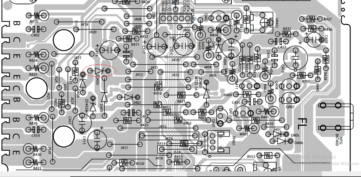

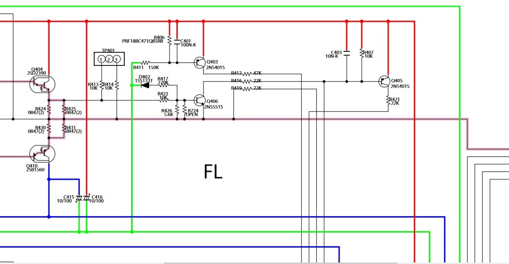

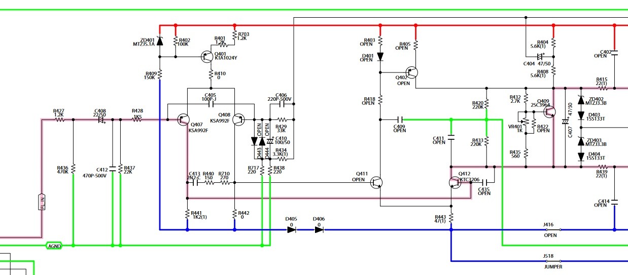

My Marantz SR5006 av receiver went into protection mode. Opened it up, foid 2 shorted output transistors, as well as open circuit emmiter resistors. I replaced them all today, and getting a horrible distortion sound from that channel and I cannot set idling current. In the video link, it is not my amp, but it is the exact saem distortion I am getting from my amplifier front left channel. Go to 1:36 for the distortion sound
Replaced what I marked in red, still got the distortion
