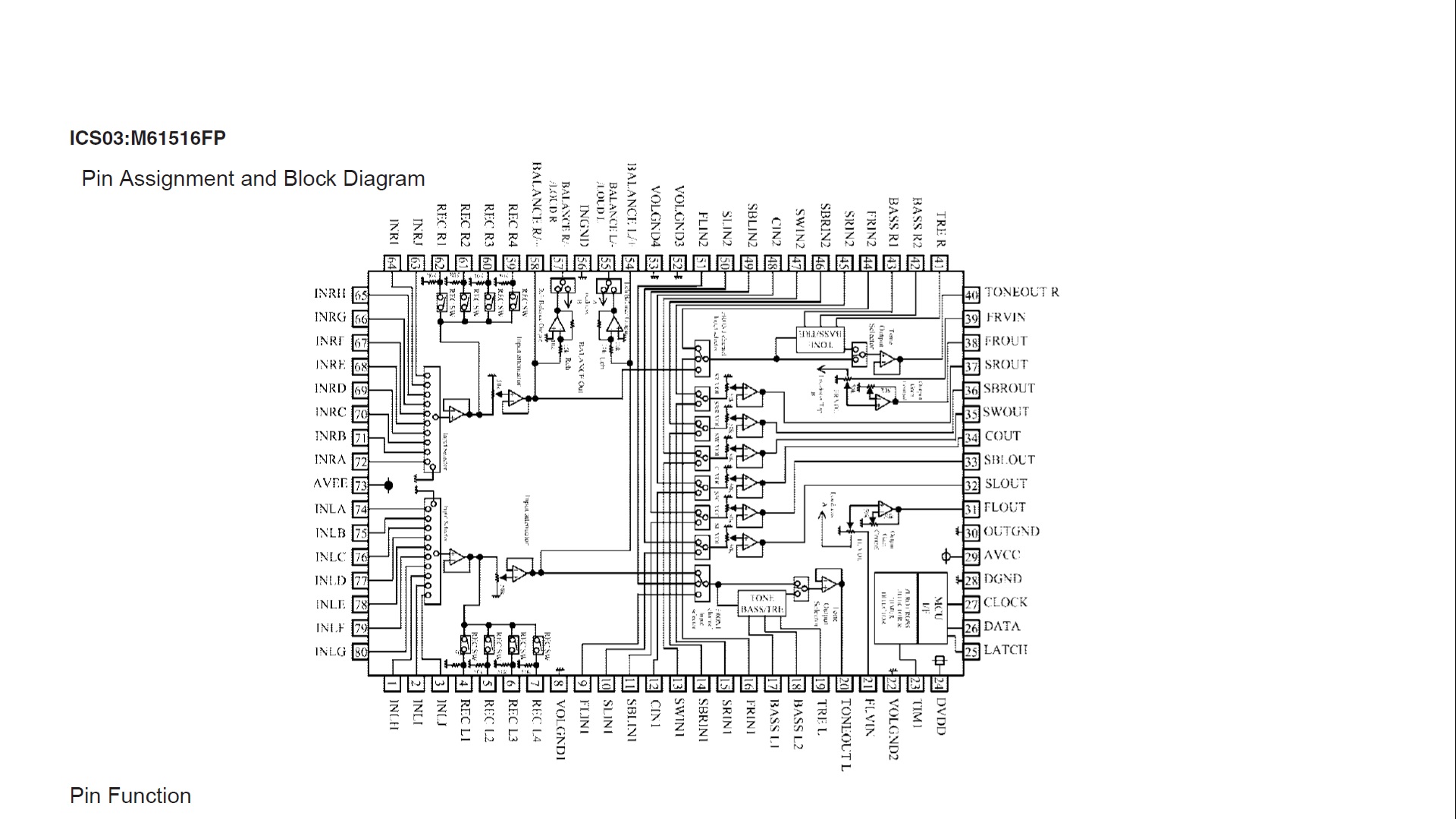

Marantz SR4300 Receiver Peculiar set of symptoms....
This unit has an issue with no/intermittent sound output.
Appreciate all who read this.
Here is the thing Im listening to stereo music on it as I write through the preouts front left and right...but it still has its problems...
When powering up there are no problems...display works..all buttons seems to do what they say...yet no sound.
The problem is no sound even via headphone or preouts or speakers.
But then sometimes if you select DIRECT and if you turn either the volume knob or adjust volume via the remote...up and down you hear clicking..then maybe a slight pop...then continue up and down...and then you can settle on a spot where the sound will suddenly start...and as long as you dont touch the volume anymore it will continue to push sound out. But further sometimes sound is out one channel only...it can change to the other channel..and rarely both channels sound outputs.
Also weirder.....sometimes you can hear via headphones quiet sound from one channel..but its coming through all inputs...no matter which one you select ..you can still here it quietly.!
Ive replaced the power filter caps...and gone over the main board looking for poor solder joints and reflowed where appropriate. But issue has not changed.
Started to wonder if its a bad Sound Processing/Volume Tone Chip ..which is a M61516FP. (ICS03)
I dont want to bin this old beast if I can help it...hoping someone with some knowledge or experience may make some sense of this.
Cheers and Thanks in Advance!

Two possibilities I can think of:
a) The IC's digital section is in fact knackered as suspected.
b) digital communication unreliable e.g. due to unstable DVDD, bad trace, bad solder joints, bad ribbon cable contact or shorted ceramic cap on the line. Some poking around with the multimeter and possibly a good loupe on the CPU connections may be needed.

It is certainly an odd set of symptoms.. and it makes me suspect the vol/tone chip is bad. Will play some .. if I see a clean signal going into that chip but a nothing or crap coming out then that should rule in rule out the chip. Have to dust down my old oscilloscope for the job.

definetly need to look at the digital commands, I had issues in the past with a dried cap on the CPU power line, apparently the cpu was working but it was sending really strange looking signals. If you have a scope, fire a sine wave generator a a phone or pc , and trace it as much as you can, I know how bad it is to work on that design but with a few extended test points it is mangeable. It is an old beast but if you have the time it is worth saving. My first start would be to see if you get clean signal in the cip and if you get the clicks out of the chip eventualy if the clicks match something on the comm signal it gets or some matching noise on the power supply.
Could be as simple as a bad cap on the logic rails.

Just had this marantz back on the bench again for another looksee..
No noise anymore ..no click no nothing . Voltages check out OK...the problem is isolated to the 'Digital Audio Board' and specifically signal is going into Chip M61516FP but not out.
So my options are few...you can get the chip on Ebay. However I wonder if are they exactly the same..and not particularly cheap.
Is it possible to bypass this chip ..input straight into the Amplifier??....wanting to prove at least the Amplifier board is working if nothing else...and perhaps then try it out as a 2 channel amp.
Any help most appreciated.
