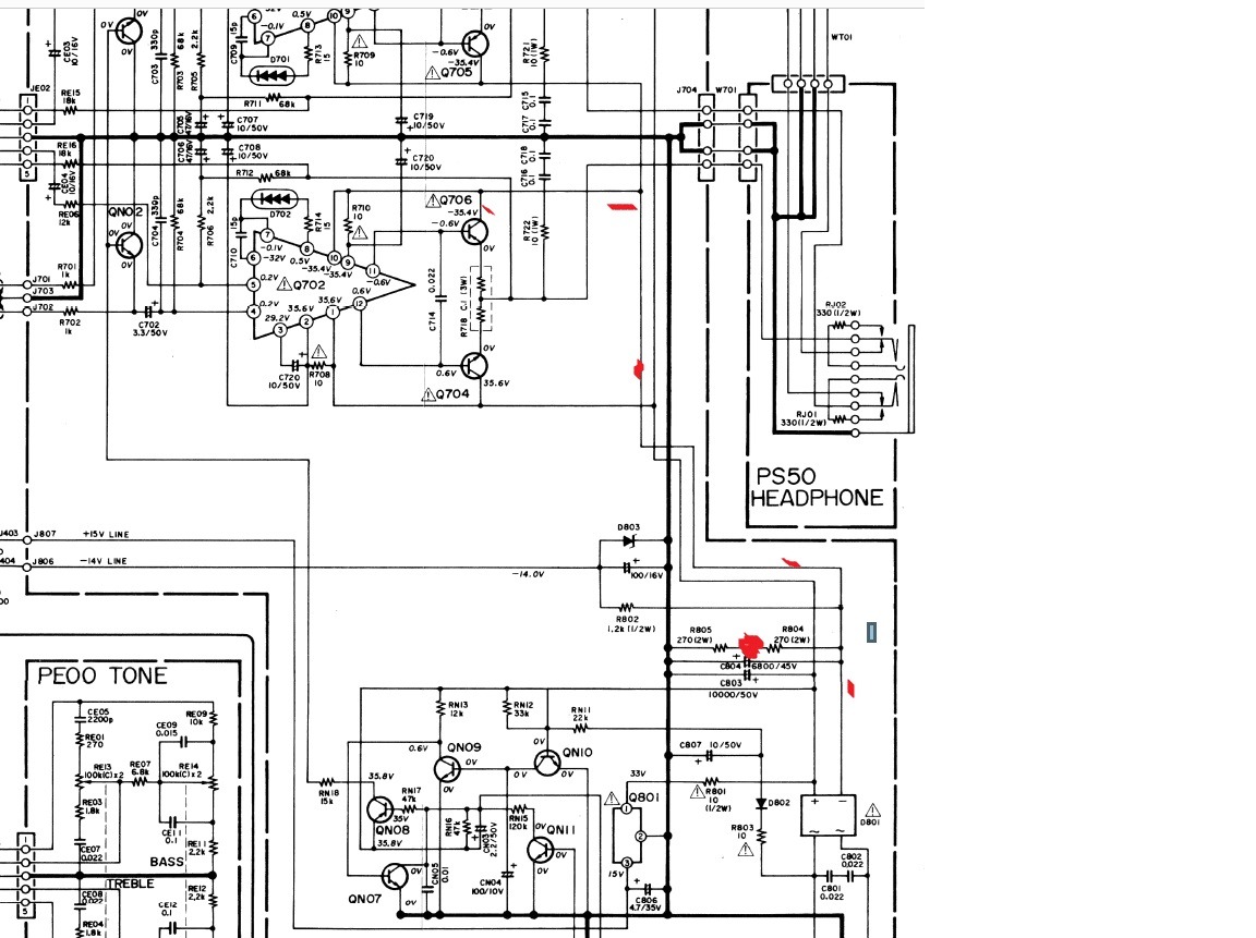

It has a 2 driver transistors in the output stage and they are directly driven from IC Q701 = uPC1225H The transistors are Q703=2SD896 and Q705=2SB776
I have attached a small section of the circuit as I do not want to get in trouble for copyright etc.

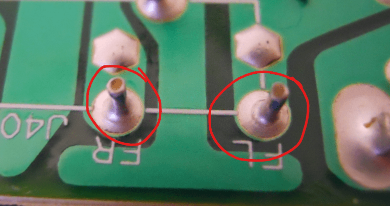

As advised already above, look for signs of hotspots/cold (dry) joints. As the amplifier heats, these tricky spots (cracks) expand and cause further loss of conductivity, which most likely results in a DC at the output. Post the PCB underside photos here and we'll have a look. In-focus, sharp and well-lit photos will help.

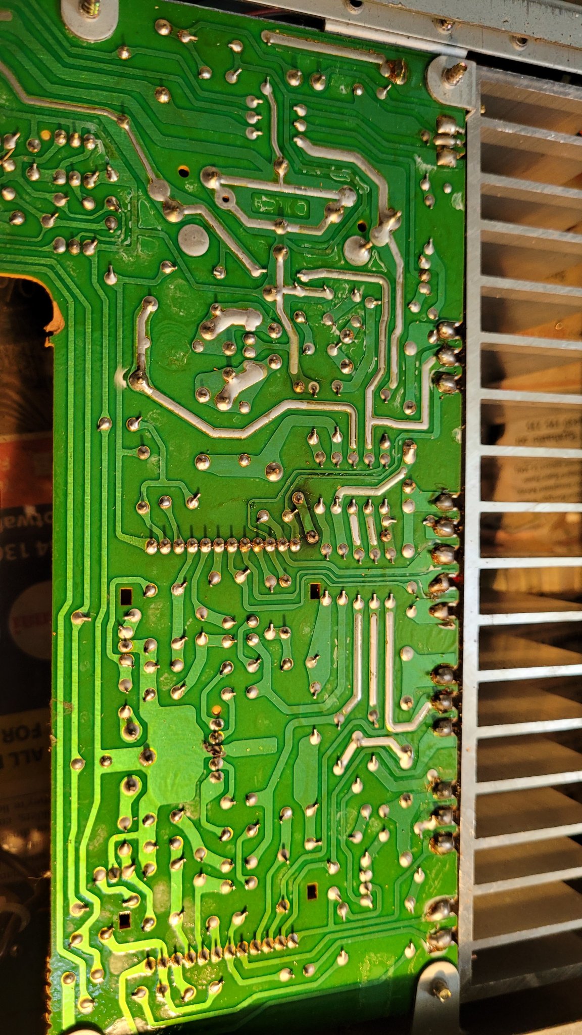

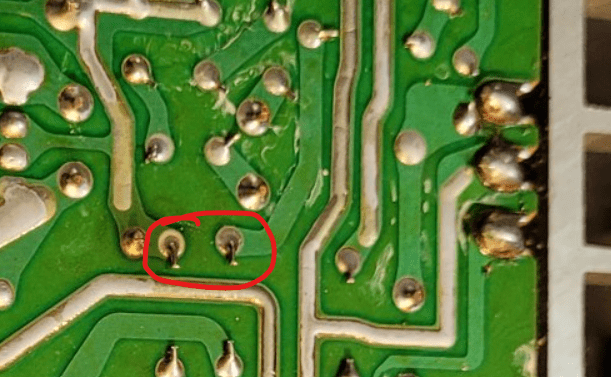

Hello and update.
Today I had time and had a look at the amplifier PCB.
I found a cracked dry solder joint between 2 large resistors.
I have marked this on the schematic in red.
Could that cause DC going to the speaker(s) ?
The resistors seem to link the power supply rectifier negative to the amp ground basically through 540 Ohm.
There were no other obvious dry joints but I resoldered most of the PCB anyway and then cleaned it.
Cleaning also removed the conformal coating it has before. I am not sure why that was so easy to dissolve.
What do you think?
Is it safe to use the amp again?
Pictures are from before any re-soldering

Hmmm 🙂
Those resistors on the diagram look to be placed across the large 6800uF capacitor and are just to quickly discharge that cap on power off. They look like they run very hot which is why they have suffered. So I'm going to say no, not the cause 🙁 but keep looking 🙂

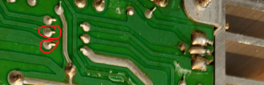

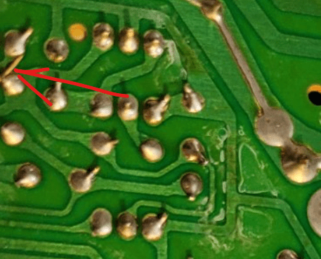

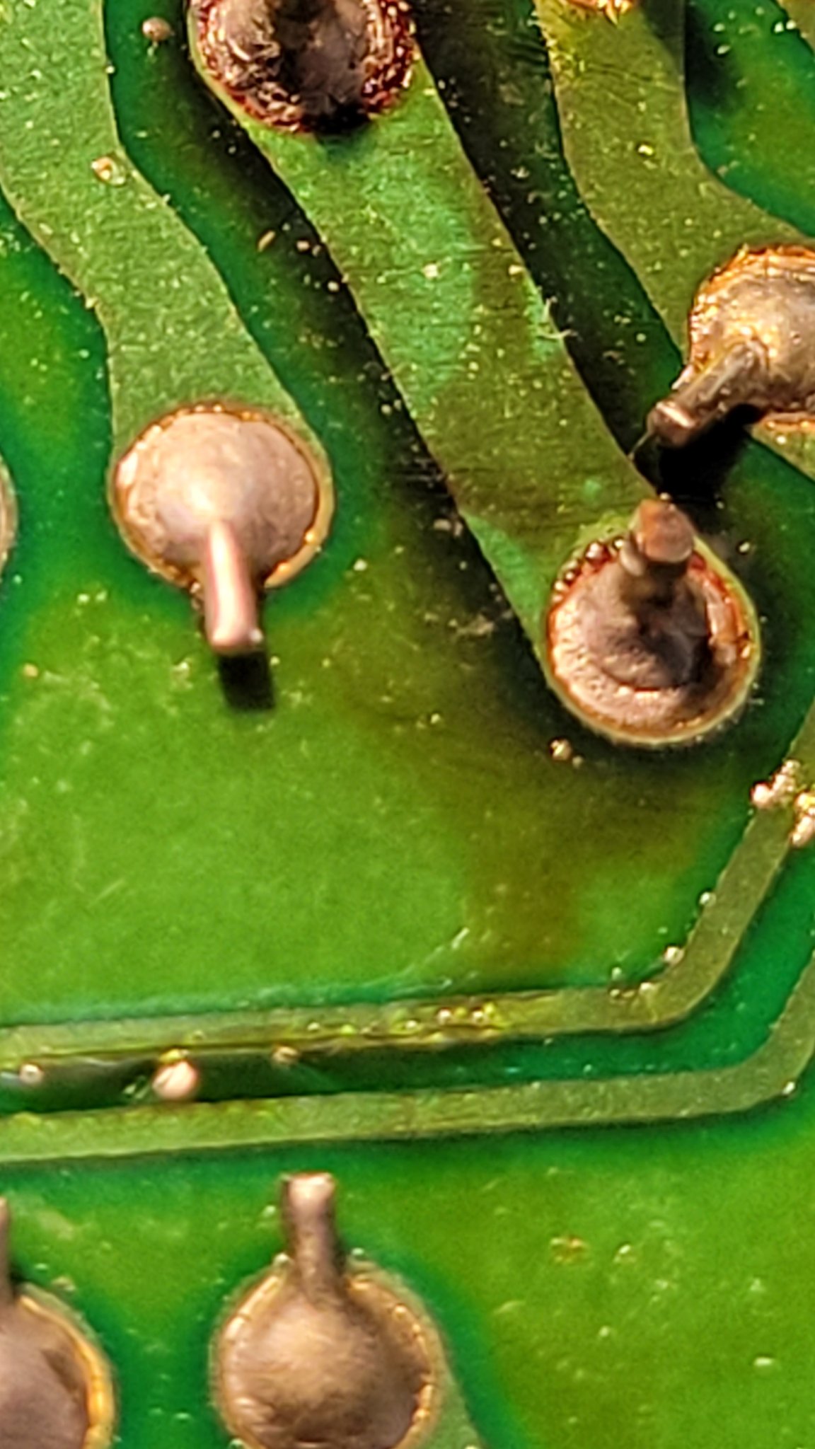

Its not easy looking at pictures but what is this:
And things like this could be suspect:
Reactions: huggygood
Thank you for looking at the pictures. The fist one you asked about is just a component leg. Nothing touching.
IThe 2 resistors themselves do not look like they have ever been very hot but that PCB track does. perhaps it heated because of the dry joints.
Dunno but it is fixed.
I am pretty sure that there are now no more dry joint candidates left on the amplifier PCB.

That sort of board material (it looks like paxolin or resin bonded board) discolours very easily with heat so discolouration alone is not a problem.
But I am stull hesitant risking my speaker(s), in case it is a failing components randomly doing this.
Try connecting a speaker via a low value fuse (say 315ma or lower) and with the amp on give the board a good tap and prod and make sure nothing untoward happens. You could also connect it via a low wattage low value resistor such as a 47 ohm 0.25 watt. If a high offset appeared the resistor would go up in smoke and not the speaker.
It is always difficult to know if an intermittent issue really is fixed unless you can actually catch it in a faulty state and so some measurements.
If... and that is an if... there still was a problem then my first thought would have to be that hybrid type driver chip in the first image you posted in the thread (Q701). Again though check for dries on all the pins.
