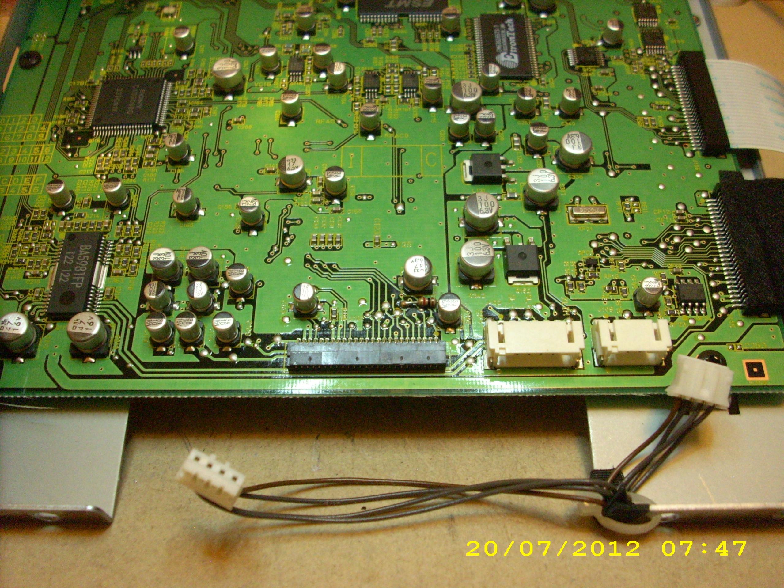

Since I still get inquiries about the TOC correction in the SA-8260 I thought I might post the first step in the process here in a post. This first step is to check the player to see if the correction resistor has already been installed on the transport board of the player.
So here goes:
1. Remove lid from player by unscrewing the 6 attaching screws from the lid. Note that the screw with the star washer goes above the power inlet, while the other 5 screws are all the same.
2. Lift the lid and slide backwards slightly to remove the lid from the case. This is pretty easy and simple. This will expose the inside of the player with the transport assembly easily visible.
3. Remove the transport assembly from the player:
A. Disconnect the 2 ribbon cables that connect the transport to the main audio board by carefully lifting directly UP on each cable.
B. Disconnect the 4 pin connector at the rear of the assembly. You may need long nosed pliers for this if you cannot get proper grip with fingers.
C. Remove the 4 screws at the corners of the transport. Three of these are easily visible. There is one screw somewhat hidden in the corner of the transport and case. Use a flashlight to locate this screw.
D. Slide the transport assembly backwards so it clears the opening in the front panel, then lift out.
4. Turn assembly over and look at the exposed transport board. Look at the attached photo and try to locate the added resistor in the same location on the board.
If your board already has the correction resistor installed then you will need to replace the laser assembly to restore operation of the player.
If your board does not have the correction resistor, then email me for instructions on installing this resistor and I will respond with the full file of instructions.

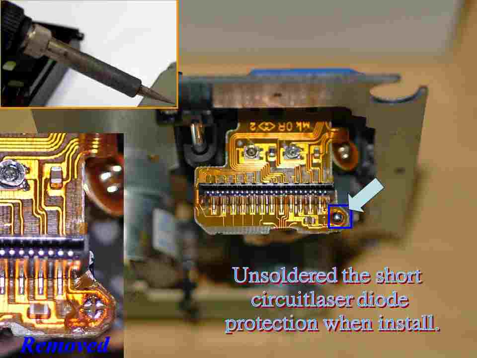

Did you remove the solder blob on the laser unit?
Supermanmeliu sends instructions and pictures to show this.
The below pic is the one Supermanmeliu sends and it's the best one to show the shorting solder blob.
This needs to be removed. Soldering iron and desoldering braid work best. Check with magnifying glass to be sure there is no small solder bridge between the 4 separate pads that are revealed with blob removal.
The unit should now play perfectly.
When you replace transport be sure to take replace the spacers exactly as before as there are two colors of them. Also be very careful with all the ribbon cables. There are no adjustments to be made, just take out the old transport and install the new one.
If you have any troubles, send me an email or a PM here, and I can help you out.

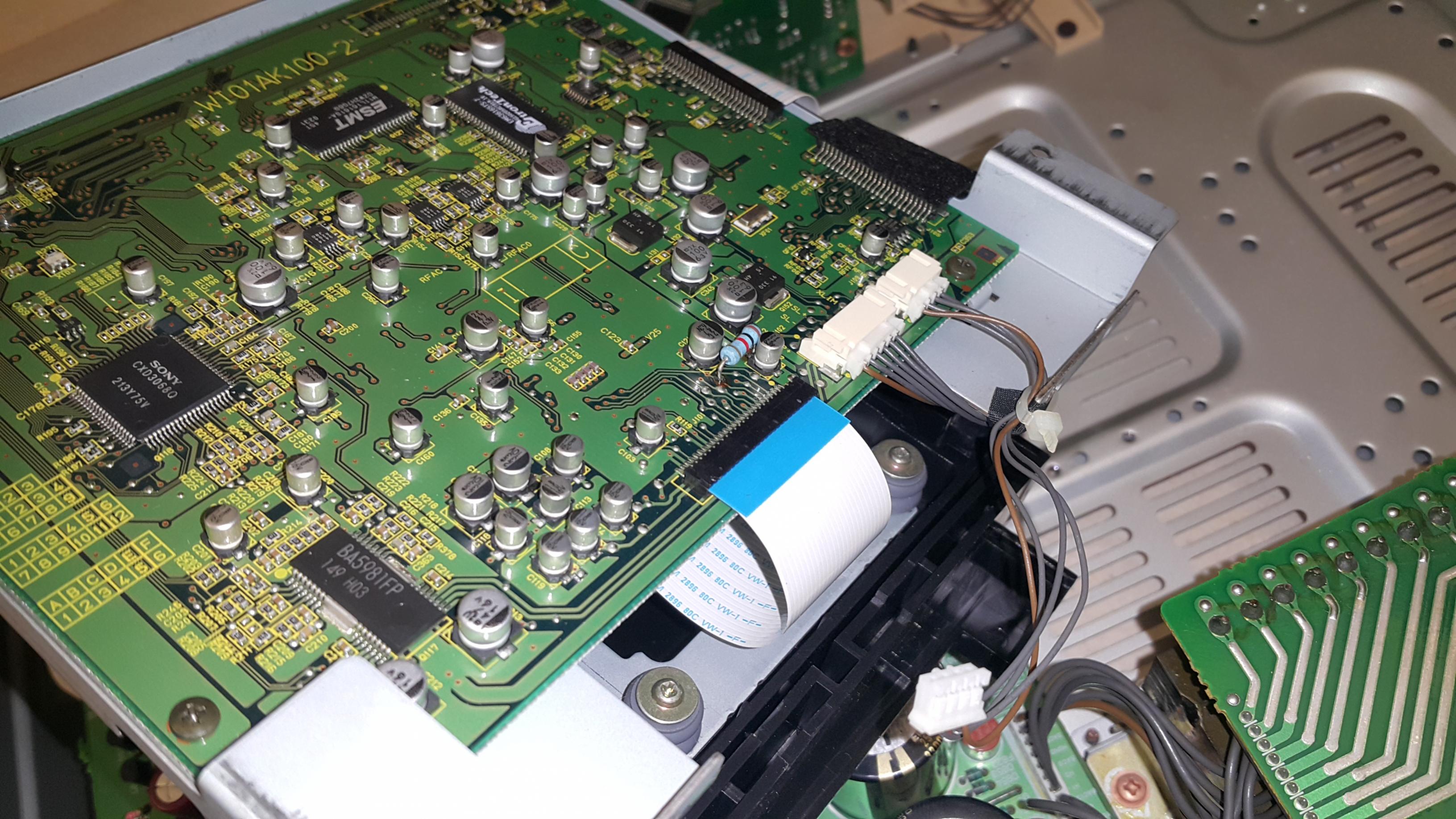

Dear Steve:
I have already installed one 1K resistor and have replaced the laser head, but TOC error still appears. Could you please kindly PM me our instruction? very much appreciate for your help.
I have sent you a PM, so please read that too.
Nice picture of properly installed "correction" resistor. You mention you replaced the laser head. Was this one of the cheap Ebay KHM230AAA laser heads? If so they usually do not work even if you remove the solder blob as shown in post #33. You really need one of the expensive complete laser mechs.
