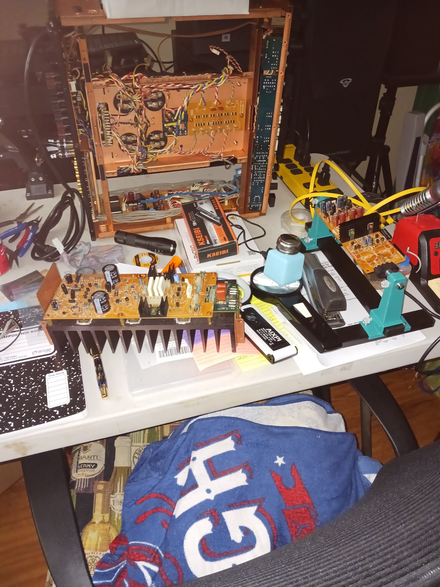

Yeah, the original mosfets were 2sk405 and 2sj115, no longer available but I did bought a pair from aliexpress just to test and compare values. I also have a dim bulb set up.
I'm under no pressure since this is a hobie for me Ron. I'm waiting for the rest of the transistors on order and caps, and hopefully I'll be able to adjust the bias by june...it will be my first time...and yes, I do have an extinguisher next to my bench.
Not a suggestion; just something to think about: to reduce risk of your investment (finding those MOSFETs takes time and $$$), for your initial test after repair, maybe don't install ALL of your new MOSFETs in case something goes wrong.
