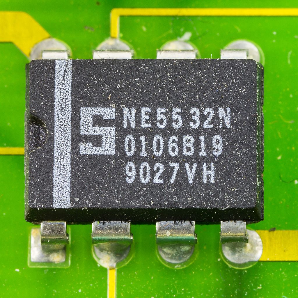

Ive just been told its got a big S on the opamp. Can get confirmation/picture tomorrow perhaps.
I'll check out the quality myself tomorrow but with resistor removed its still loud!
The amplifier is not with me. I'm remote supporting a friend.
Original opamp is JRC5534DD
replacement Signetics NE5534
Old sounds dull in comparison
new sounds louder and brighter in comparion.
Have to confirm but the difference is very very obvious
The opamp is exactly Signetics NE5534AN.

That replacement required PCB removal and disconnection of the source. I bet the amp potentiometer position was not the same and/or the source volume was different. Was the same soundtrack played back?
The bottom line is the two ICs should make 0 difference in volume.
I also think that installing an IC socket would be a good idea, albeit some additional track lengths that are going to have a detrimental effect on that DC offset. I suggest you try a very low input bias current JFET OPAmps as well. I suggested one of those earlier.
Also, make sure the solder flux residue is fully removed.
