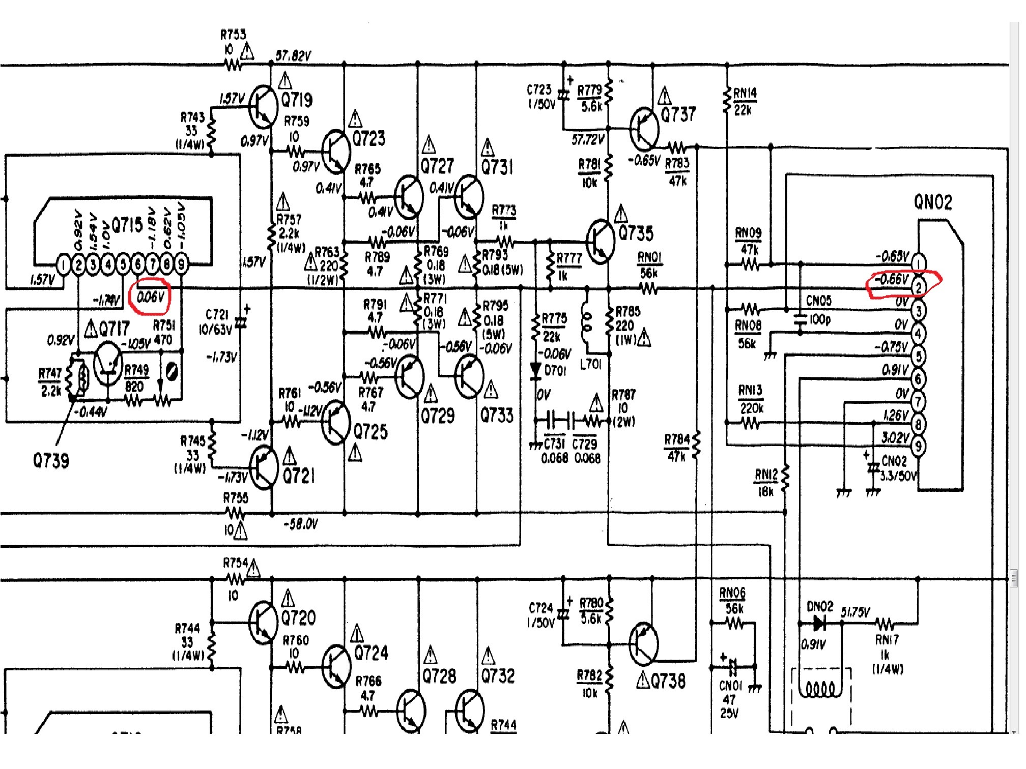

Some folks kindly helped me adjust the Idle current on this amplifier but now I'm struggling with the DC offset and have started new thread in hope of some help.
I have taken a few measurements already but really I don't know what I'm doing! The DC offset is around 87mv once its settled down but as high as 100mv initially give or take a few mv.
The measurements in the attached give or take a few mv. I do know already the DC is supposed to be 60mv and I'm trying to reduce it as much possible to that figure. Any help appreciated. Thank you

I believe 87mV offset is probably fine if you want to just live with it, but you can trim it to near 0V if you wish.
Assuming there are no other defects, the offset you're observing is almost certainly due to the mismatched bias resistors at the inputs of opamp Q701, namely R701 vs. R707--- 220K vs. 33K, respectively. This assumes there's no leakage through C701 and C713. (It's probably the charging time for these two caps that is responsible for the turn-on settling you've noted.)
So to reduce the output to 0, you need to force an additional 87mV drop across R707, i.e. 87mV/33K = ~2.6uA. To do that, install a resistor from the +17V rail to Q701 pin 3. The resistor value should be (17-0.103)/2.6uA = ~6.5M Ohm, say 6.8M Ohm.

Very interesting circuit. Notice that the Q703 CE current, Q705 CE current and Q701 OPAmp Iout current do not cancel each other; i.e. the sum of the currents at that junction is not 0 amps; the diagram states that the OPAmp Iout pin sits at 70mV. It's almost like someone intentionally decided to send some current into the OPAmp output transistors.... maybe.

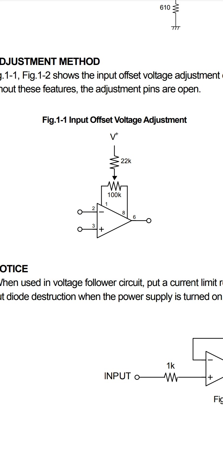

I'd use a 20k multiturn trimpot in place of R715 or R717 and null the offset. Once nulled, find out the resistance, combine the required resistors... and solder the combo.
The issue is bias currents, not offset error at the opamp input. And dh_holmes data shows offset error the opamp is less than 1 mV, limited by DVM resolution. IMHO, using voltage-offset on an opamp to correct output offset is not a good idea; it unbalances the input stage and risks degrading distortion performance.
I checked NJM5534 data and input bias is 200-800nA, inputs are NPN, so bias flow is into the opamp. An expected voltage at minus input pin would range between -44mV to -176mV. 103 mV is within range, but not the reported polaity. Did OP not note polarity of measured voltages? Is the opamp other than a 5534?

And yes the voltage was -103mv. All the dc offset was minus. Negative tip was grounded and measured with positive. Even the dc offset was -87. I just realised the manul also shows 0.06v. I have no idea what it means?

IMHO, it's the easiest option. BTW, the suggested 6.8M resistor needs to connect to the -17V rail since output error is negative.
Another bias compensation method would insert a 187K in series with R707, thus matching the 220K. The 187K needs to be shunted with a cap so that it's effectively a short at all audio frequencies. But that's more complicated.
