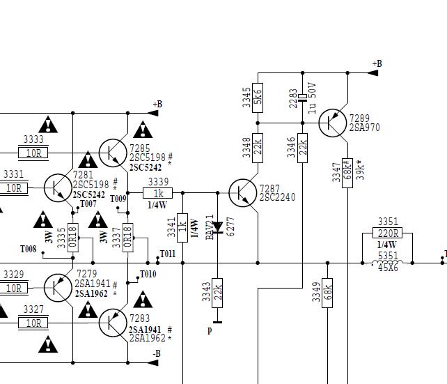

At first glance and taking into consideration that you say the power supply doesn't turn off .
Fact-- you run it 24/7 in Class A and there is a warning in the manual about overheating if the ventilation is blocked then its not completely Thermally Stable under all conditions .
I would think that you have a high resistance soldered connection --probably relating to the output devices that becomes a full disconnection when driven hard ---IF that is the case then it will take a bit of locating.
Of course it could be various other things but I have come across this many times in power amps so its a percentage probability .
Re-flow of all power output devices is a start to at least eliminate this type of fault.
If still occurring after this then any resistor connected to the feed of the output devices should be checked.

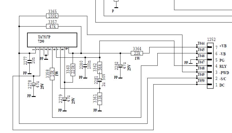

I did some measurements, boad in place, exploring RS232 's suggestion.
On the relay output of that speaker protect board, i read about 1V when there is sound. I was expecting 0V?, but 1V is below "must release" (1.3) of the MR62-24SR relay it drives.
When sound cuts i read about 4.5V on that line, with a digital multimeter that i guess is not fast enough to display the real value. The "analog" bar graph does go higher, to the 30 mark (30 V??).
And i now hear those relays click when sound cuts. Only that small red one (MR62-24SR) with earphones fed (or not) and speakers off, and those big VB24MBU as well when speaker selectors switches are on.
I read -10mv on the DC input line with no input, that value varies when music is playing (to the 5 mark on the bargraph).
So i'll be taking that board out and testing components later today.
It would be nice if someone could point me to the suspect, as i'm not good enough at reading schematics to see the guilty party. BTW, are these grey 1W resistors (3364, 3358) fusible?
Thank you for reading everyone.
Bic410 on HiFiEngine suggests cap 2278, i'll start there.
Please anyone enlighten me as to how it (cap 2278, bridging DC input to ground) could be the culprit: in my limited understanding of electronics, if that cap is short it will send everything to ground (and that poor 7289 transistor would be overworked?). Nothing would get to the dc sensing input of the chip, so no relay output. Right?
If it's open, DC and AC will get to that input. Is there AC on that DC line? If yes (i think so, as i see nothing blocking AC to those 2 transistors downstream of the oouput stage), would that AC "cheat" up the value of the DC sensed, so tripping the relay ?

Aren't we talking about the DC detection circuit ?
Isn't it just a smoothing cap for it ?
Will try to did out the service manual to have a look is was a few years ago so have to check.
It sure looks like a smoothing cap on a DC input line for a detector.

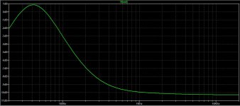

You could have a situation where the overload protection circuitry has become too sensitive.
As first thing I would replace the 1uF capacitor 2283 - these small ones tend to dry out to the point of losing capacitance completely. Once they have lost their capacitance they will pass the spikes (from thransients) to the TA7317 input.
If it were my personal amplifier then I would probably reduce also sensitivity of this particular function and put a 2.2uF capacitor there instead.
Perhaps I would double (at least) the capacitance of 2277...

Ok, the speaker protect board is fixed. No more sound cutting. Thank you RS232 (and Bic410 on HiFiEngine)
But there were 2 surprises:
Component 2285 is not on the schematic, but it's there on that board. Right next to and in line with cap 2278 (on PCB assembly drawing (p.20 of the PDF), it would be just above the "tz" of the word "Marantz"). Connecting DC input line (pin 2) of the chip, and ground.
That would put it in parallel with cap 2278, correct?
AND dear cap 2278 was misplaced 1 hole to left, both legs on ground. I was quite amazed. It makes me wonder where is part 2284 (2283 is on main board), and what other "customisation" there is in my amp ;-)
My digital multimeter could not measure (out of circuit) capacitance of cap 2278: the display was overrange, alternating between nano and microFarad. Strangely (to me in my inadequate experience), the DC voltage test gave a few mv, a lower value after shorting the cap, and the ohm test was normal (growing).
The surprise 2285, i thought it was a resistor (did not notice its number and symbol on the PCB, dummy me). It measured like an open resistor. And resistance was not going up as on a capacitor (film) that it is.
So i replaced both capacitors, putting the 2278 cap in its proper place. I used 20 years old NOS, 2278 capacitor not reformed but it did not heat up or explode ;-)
I had trouble deciphering the color bands taking up all the space on the ever so tiny film cap. I read: Red Black Orange Black Brown, so opted for 22nano because of the barely perceptible (almost imagined) gap between Black Brown. Does that make sense in that context? Or would the reverse reading 10nano be better?
And i wonder why would that film cap would be put in parallel to the 47microF 2278? The only thing i learned, google overdosing, would be to divert more high frequency "noise"??
Anyway, it works. Sound is steady, no cutouts. It worked with the the new 2278 and 200ohms resistor i put in before realising 2285 is a cap, it worked without the resistor and only the replaced 2278 cap, and it works with the replaced 2278 + the 47nano i put in for 2285. Which is the closest I had in my NOS stash (Mouser is far away), a Philips orange Chiclets thing (mica??), 10% 100V. Am I in trouble??

But i'll bet you could tell me how to change the hinge frequency of the bass tone control. It sounds like it's at 150Hz (tenor voice, and most boosted frequency of not too good speakers/earphones), i'd like it at 80Hz (guitar bottom string). Doable?
Doable? yes, simple simulation in LTSpice.
