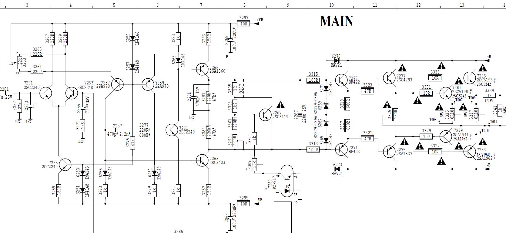

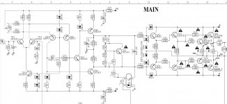

Summing up how that problem was resolved (thank you to all who contributed!!):
I replaced fusible resistor 3315 that had gone very high.
And lowered 3301 (and 3302) to 220R to bring DC back within adjustable range (7267 and 7268 having drifted?)

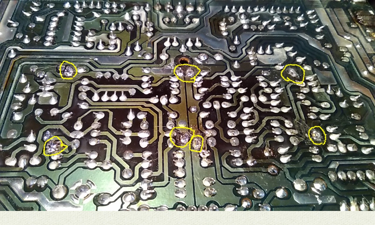

Now will be replacing lots of electrolytics, all other fusibles, and putting back 7289 that i blew up (remember: discharge those Caps!), to reenable Protection. Looking for that 2SA970 and other through hole legged critters i discovered that these are now really scarce, like in hard to find.

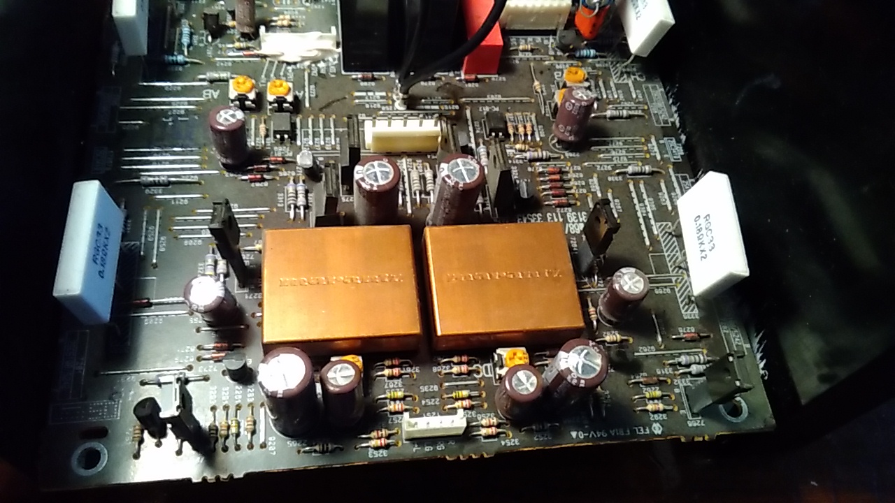

After i repaired the speaker protection board of that amplifier, all was ok.
So I then proceeded to adjust iddle current, got it, then DC offset. Oh, bboy.
